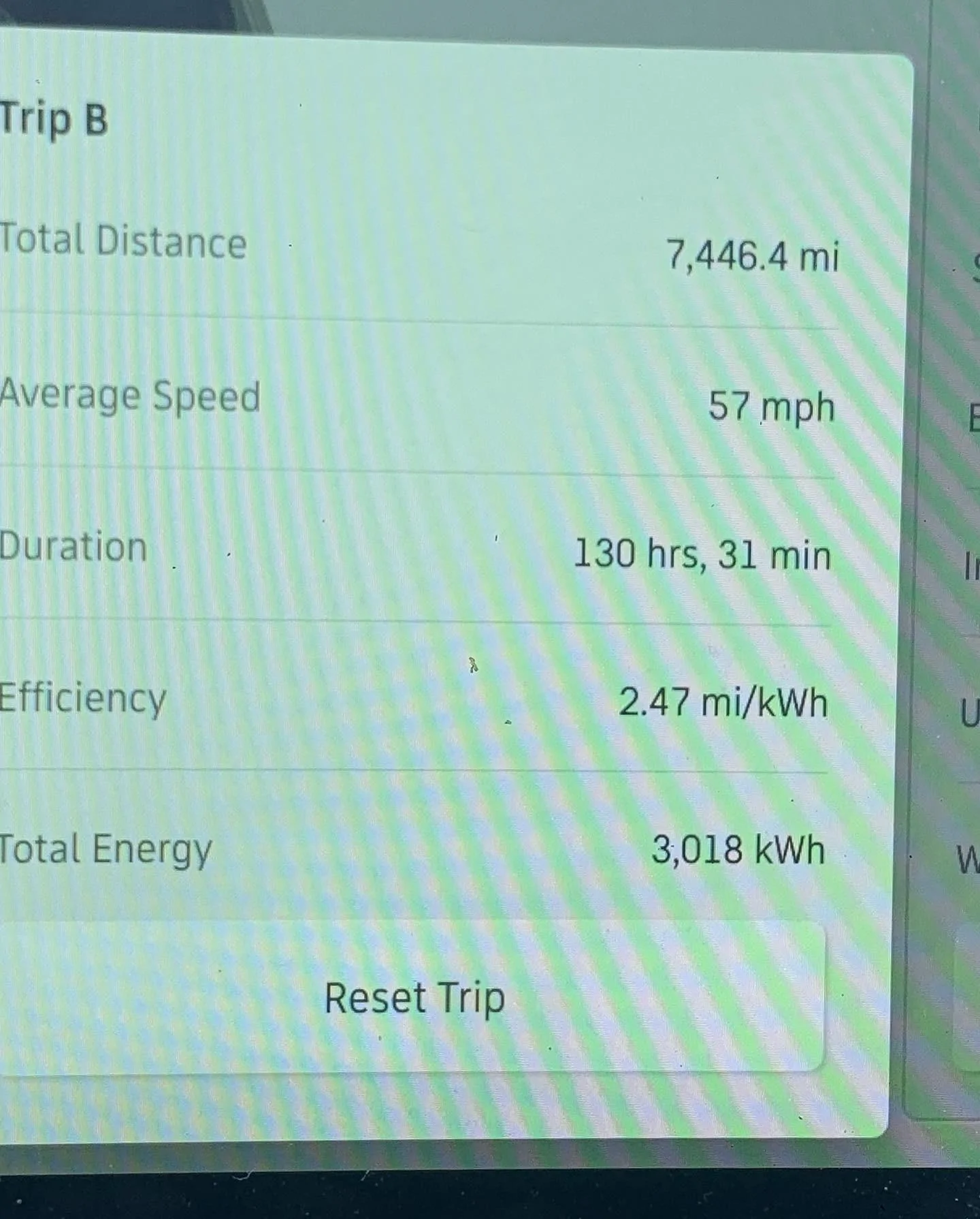

I'm right there with you, I don't understand these really high mile/kwh ratings. I'm also 1.75 but only at 1000 miles so far. I chalk most of it up to colder temps and the batteries needing to condition themselves? The couple times that is has been over 55 degrees here I've seen the 15 min rating averaging 2.25 -2.4 in all-purpose. This morning I was only getting 1.4 :( ...and not aggressive at all
Rivian R1T R1S What max range calculations is everyone getting? 3D7F9FCE-8A3D-4E2A-B9D9-48F28A357745
Silver9k
Mar 13, 2021
46
54
Media, PA
19' CX-5 D, 16' Mazda3, 07 S2000
What kind of drives do you typically do? Mode most driving is done in, tires? If you're averaging 57mph over 7400 miles I'm guessing most driving is longer highway drives, and the battery comes to temperature.
I have seen 2.2-2.4 fairly recently when I've driven 60-65mph and the drive was long enough to let the battery warm up. In all-purpose, normal height, all-terrains. Most of my driving though is relatively short, about 16 miles and 25 minutes. By the end of the drive the numbers always come up, but getting the battery up to temp absolutely kills the efficiency initially.
