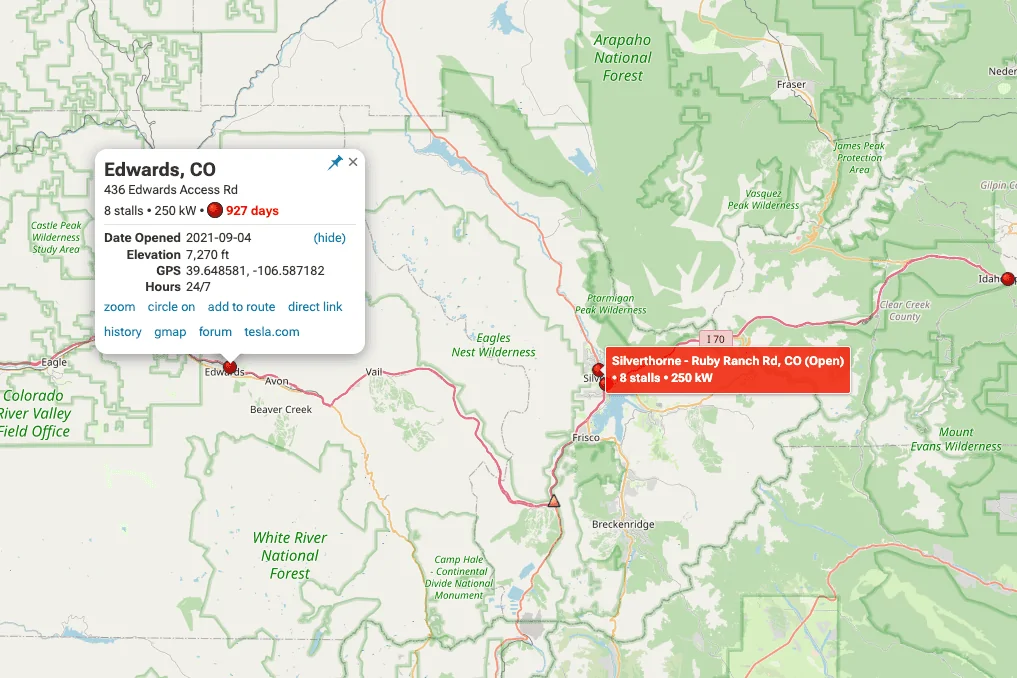

It's not just 250kW Tesla SC or 150kW. For example, I live in Colorado and the Rivian map lists the station in Edwards (just west of Vail) as compatible, but it doesn't list the 250kW station in Silverthorne as available.
From Supercharge.info (there are 2 SC's in Silverthorne, one is 150kW the other is 250kW):

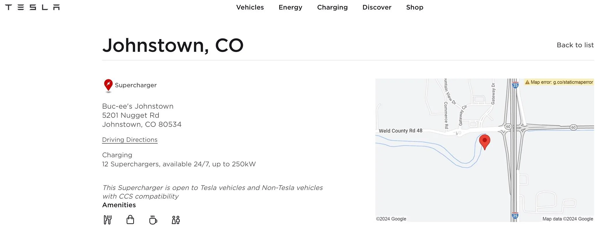

FWIW this is how a magic dock station is listed on the Tesla website. This is the new station in Johnstown, at the Buc-ee's.
Rivian R1T R1S What makes for a "Compatible Tesla Supercharger" ? Image 3-19-24 at 11.28 AM
