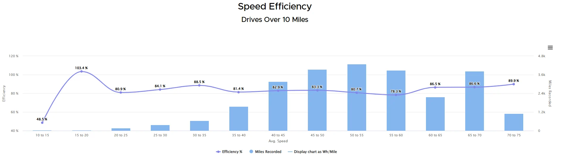

ElectraFi does something similar......although doesn't account for elevation.
Mine looks like this......
Rivian R1T R1S Using Home Assistant Data to calculate efficiency as a function of speed (normalize for altitude) 1766419096754-m9
Density is relatively linear with altitude. Should be able to scale linearly if you really wanted to. It will only vary by a small percentage as compared to velocity. It's also susceptible to other environmental changes such as temperature and humidity, so it's not ONLY altitude that messes with that part of the equation. Likely not worth the effort IMO.
