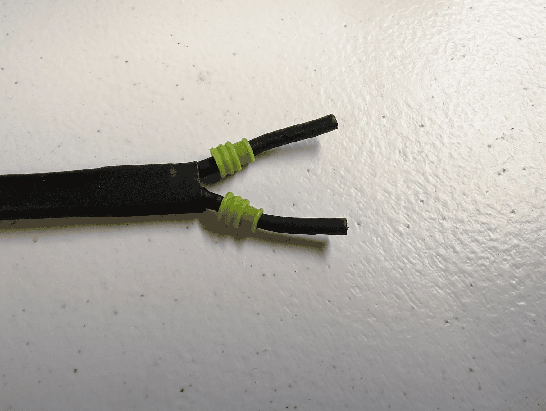

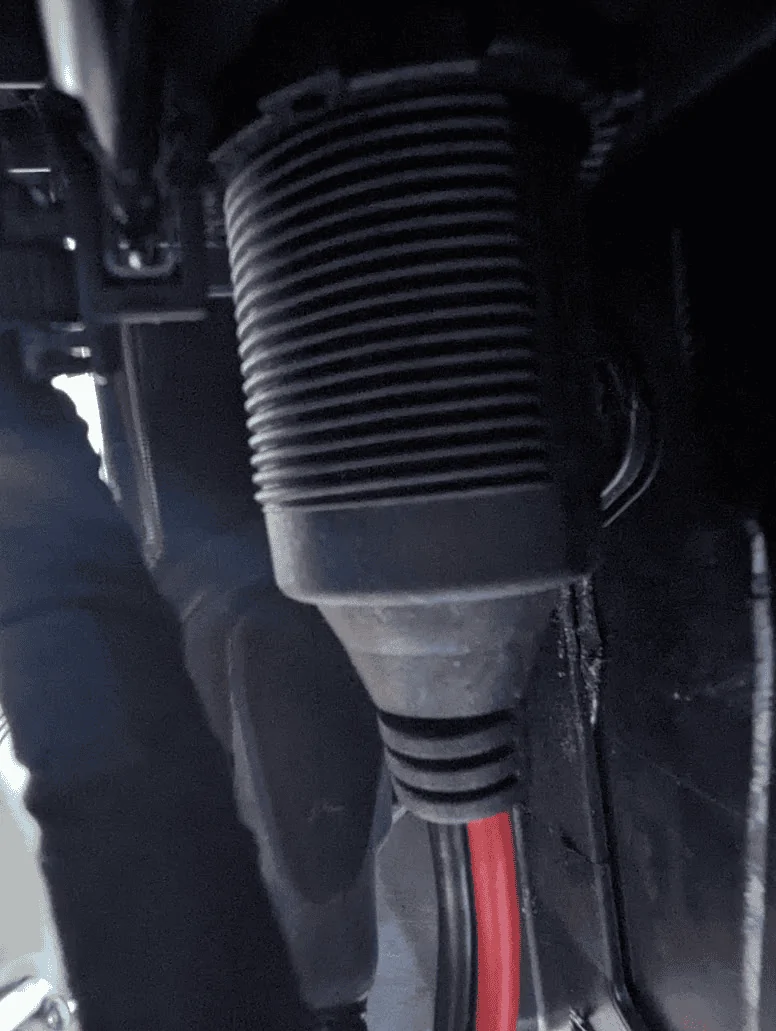

Just to add to the fine details here - The frunk OEM connector used in question is a Sumitomo 6185-5181 that uses Sumitomo 8240-0265 Female Terminals. The wire plugs (water seals) you need will depend on the gauge of wire you end up using, obviously. Getting the seal size right with the wire gauge + insulation thickness can be tricky - AWG is not dictated by insulation thickness, it is strictly wire gauge, so you can end up with some 14 or 16AWG wire that has really thick insulation that will actually not work well with these wire seals. Best to measure the wire you're actually using for this mod to make sure you get the correct wire seal - trying to stuff an undersized wire seal into the connector body is a brutal pain in the ass.
Also, I get my parts for this connector from ConnectorID.com because it's US-based and has fast shipping. Here's the parts I ordered for my last Frunk update:
I ordered several different wire seal sizes because I had different projects to do - you don't need all of these parts if you're doing this modification, obviously.
  • The light blue seal is CID1307 and is for 18, 20 or 22AWG wire, max insulation 1.0-2.2mm
  • The blue seal is CIDJ012 and is a plug for unused connector ports
  • The purple seal is CID1299 and is for 14, 16 and 18AWG wire, max insulation 1.8-2.7mm
  • The green seal is CID1140 and is for 14, 16 and 18AWG wire, max insulation 2.0-3.0mm
  • There is also an orange wire seal available, part number CID1005 for 18 and 20AWG wire with a max insulation of 1.6-2.3mm

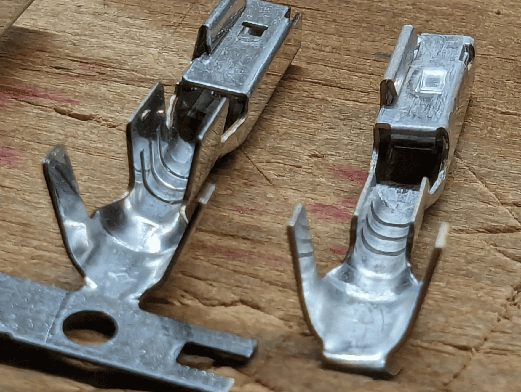

  • The female terminals (aka 'pins') you'll need are CID204-2.3-FS3 for the Sumitomo RS090 series connector. I doubt anyone wants to spend $218 on the crimper for these, so you'll probably just want to carefully hand-crimp the wires and add a very conservative amount of solder to ensure a good connection. WARNING: If you do add solder, you must make absolutely certain that you don't allow solder to wick into the terminal wireway at all, or the terminal is ruined and will need to be replaced.
  • The 12V socket I use is from Amazon, but it's a bear to install because it's threaded, and means you have to thread the nut onto the socket from inside the light cavity. It thoroughly sucks donkey ass trying to get it installed, but it looks great once it's in there. I get PTSD thinking about the amount of time I spent trying to use 1 finger to align the nut onto the socket and hold it in place while I turned the socket to tighten it. The reason I like this one is because the wires are injection molded into the socket body as opposed to a screw & nut that is exposed and could come loose. I cut off the inline fuse and the hoop terminals, obviously - the socket is already fused by the Rivian. Also note that this is one of those cases where the 14AWG wire has brutally thick insulation that won't play nice with the wire seals listed above, so you'll either have to strip off more than enough to allow entrance into the connector body (plus wire seal) and replace that extra thick insulation with a thinner waterproof heat shrink tubing - then slide the wire seal over that and stuff that into the connector housing.

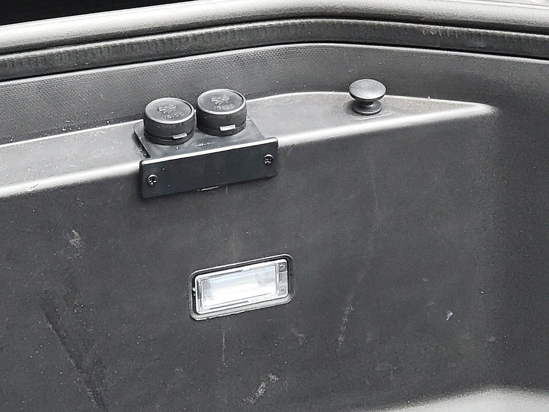

I did remove tub. The dual style like the op is Dremel only option, you have to make a good sized rectangle hole. You can get a single or possibly do 2 single tube ones if you don't want to cut on sides.

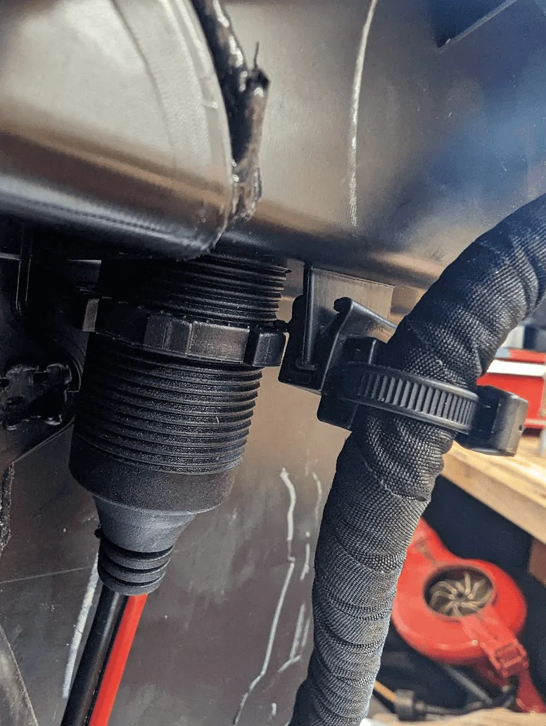

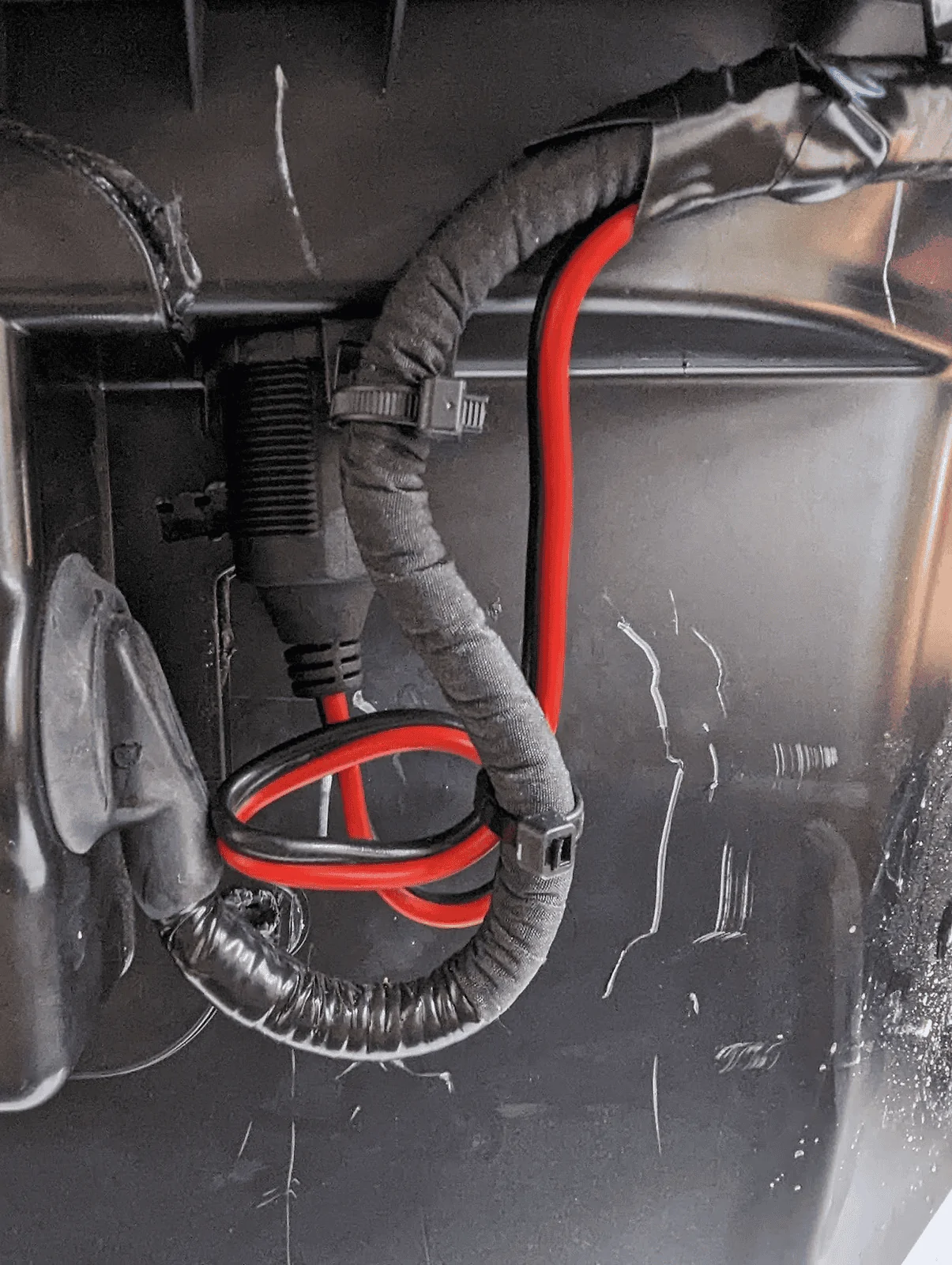

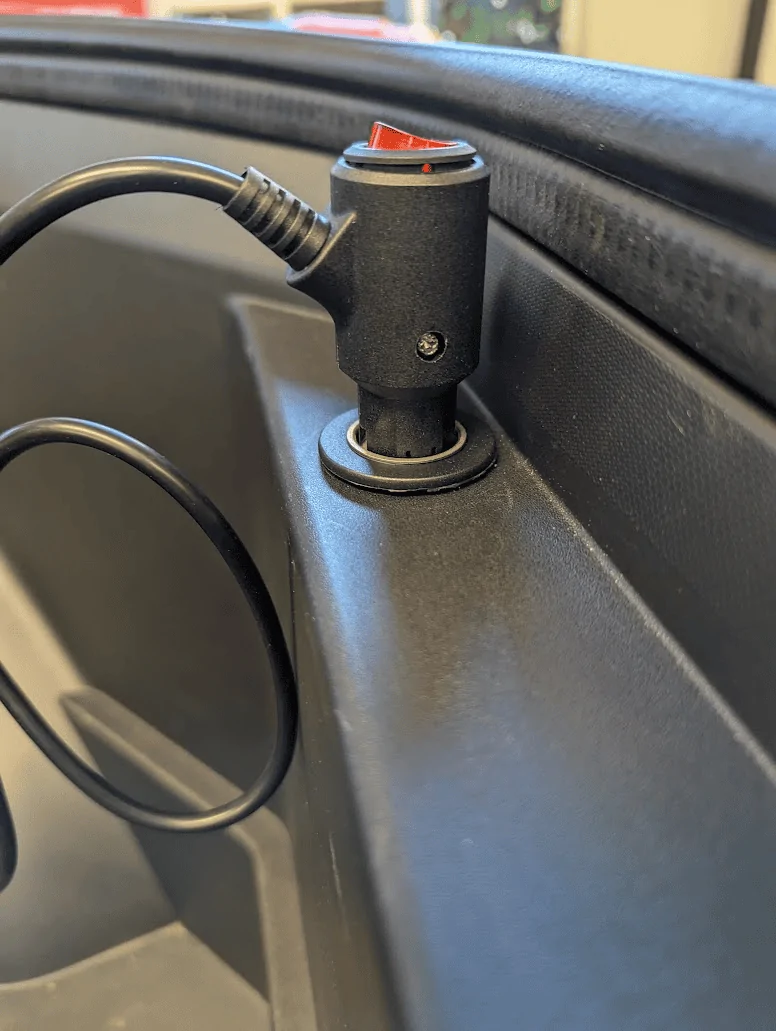

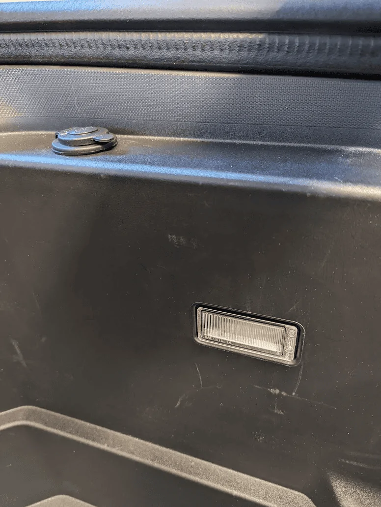

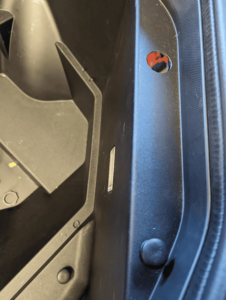

I figured out finally where your pain point was.
I think I'll place mine (single) outside the light box. There should be enough room, and with the socket you recommended it should be waterproof.
Pros:
  • looks clean
  • no need to open the light box
  • not sticking out into the storage area
Cons:
  • Needs careful placement, and careful tub install
  • Tight balance between getting too close to the metal sheet in the car (between the socket and the wall of the tub). I didn't plan for the ring and had to turn the socket as the ring was blocked by a tab. On the other hand, the ring is now held in place.
  • Some (most?) 12V plugs are very long and may hit the hood when closed.

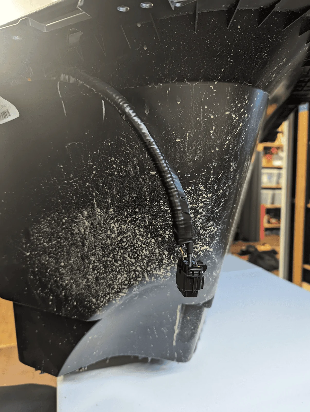

Rivian R1T R1S Tutorial / DIY Guide - Installing 12v Outlet in Frunk 1710888654187-t
Rivian R1T R1S Tutorial / DIY Guide - Installing 12v Outlet in Frunk 1710889047431-r
Rivian R1T R1S Tutorial / DIY Guide - Installing 12v Outlet in Frunk 1710889184701-ev
Rivian R1T R1S Tutorial / DIY Guide - Installing 12v Outlet in Frunk 1710888690034-h7
Rivian R1T R1S Tutorial / DIY Guide - Installing 12v Outlet in Frunk 1710888709533-z3
Rivian R1T R1S Tutorial / DIY Guide - Installing 12v Outlet in Frunk 1710905342616-1u
Rivian R1T R1S Tutorial / DIY Guide - Installing 12v Outlet in Frunk 1710905375138-i

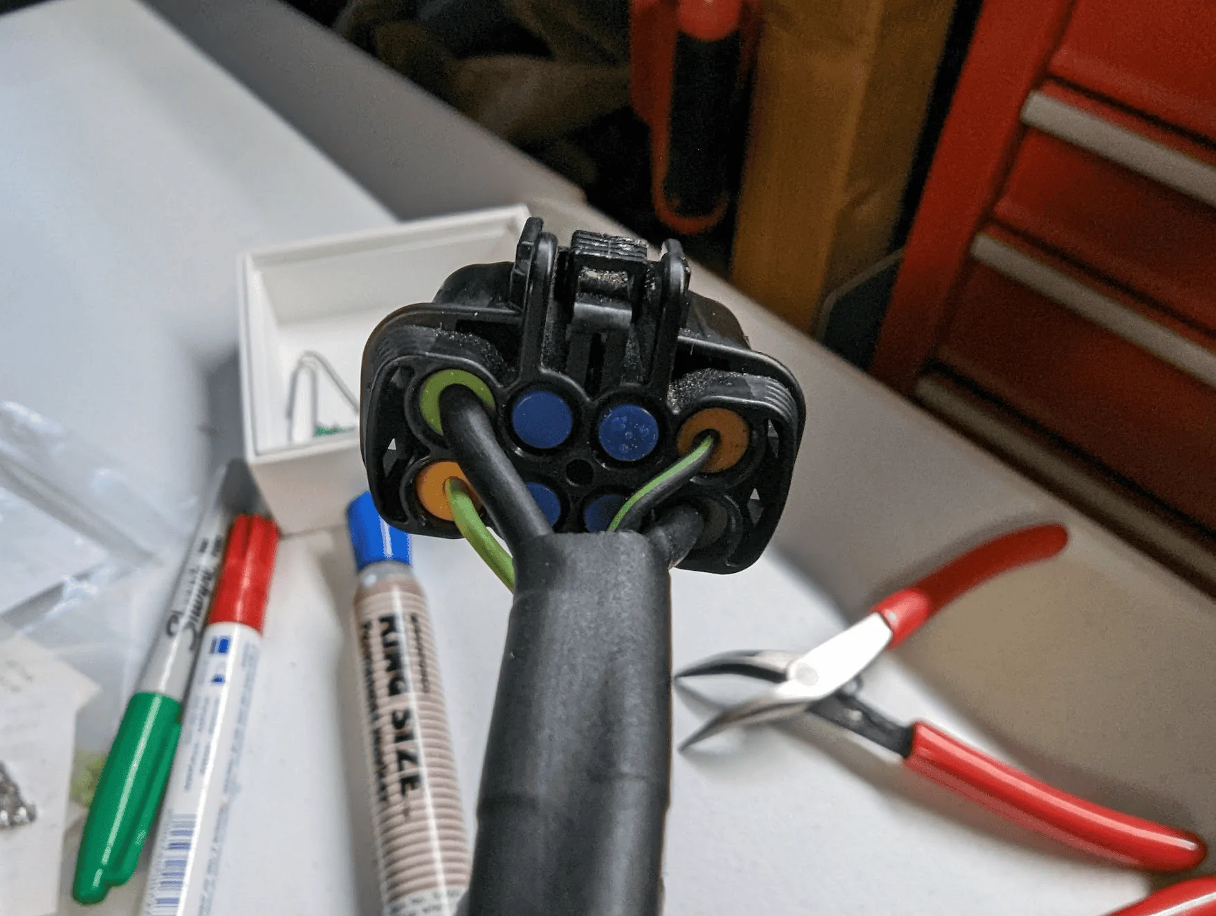

Get the right connector for your wire size
Rivian R1T R1S Tutorial / DIY Guide - Installing 12v Outlet in Frunk 1710905152372-g5
Rivian R1T R1S Tutorial / DIY Guide - Installing 12v Outlet in Frunk 1710905180906-5j
Rivian R1T R1S Tutorial / DIY Guide - Installing 12v Outlet in Frunk 1710905259055-az

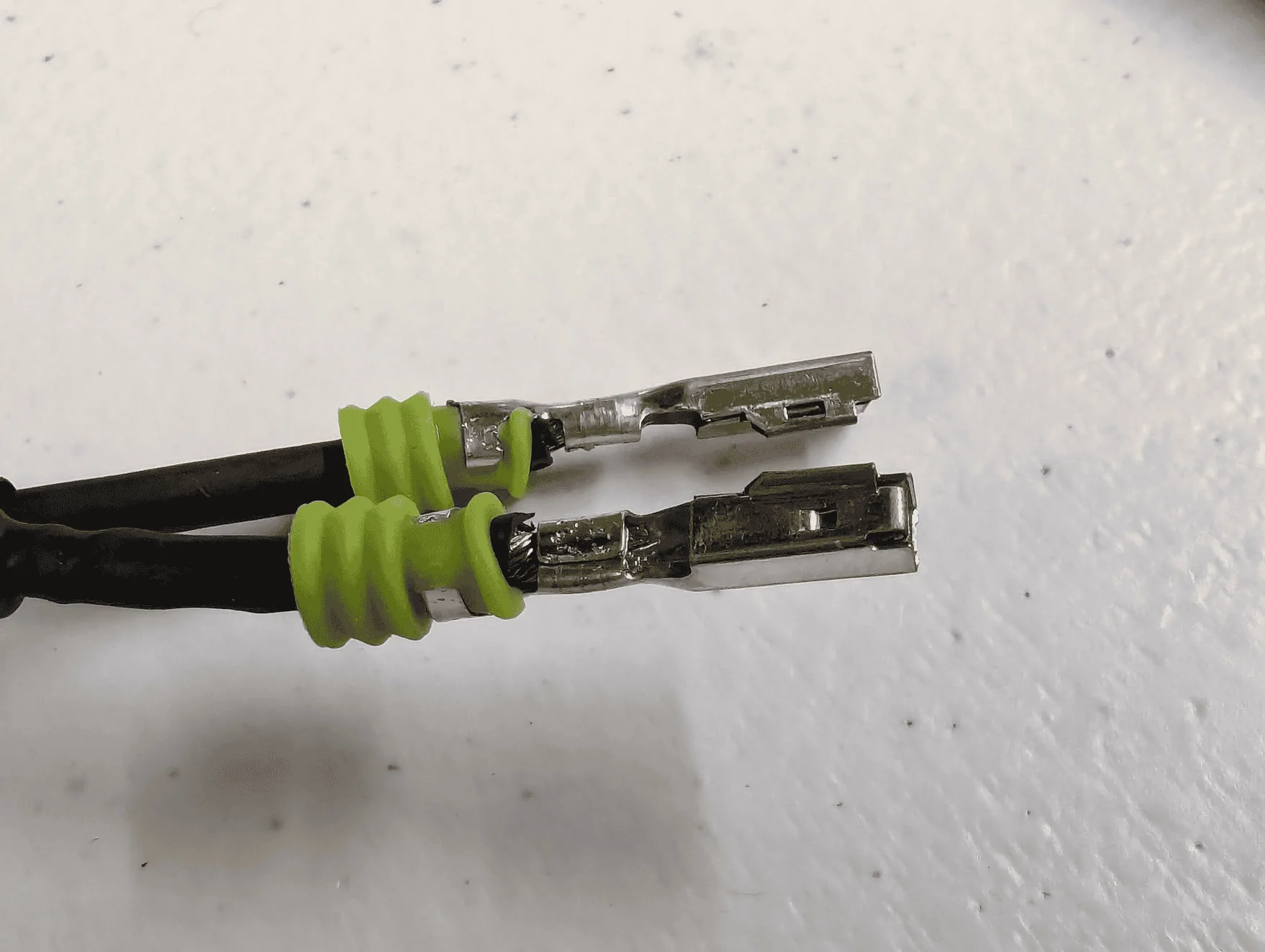

Not proud, but I didn't want to splurge for a crimping tool.
Rivian R1T R1S Tutorial / DIY Guide - Installing 12v Outlet in Frunk 1710905292662-cv

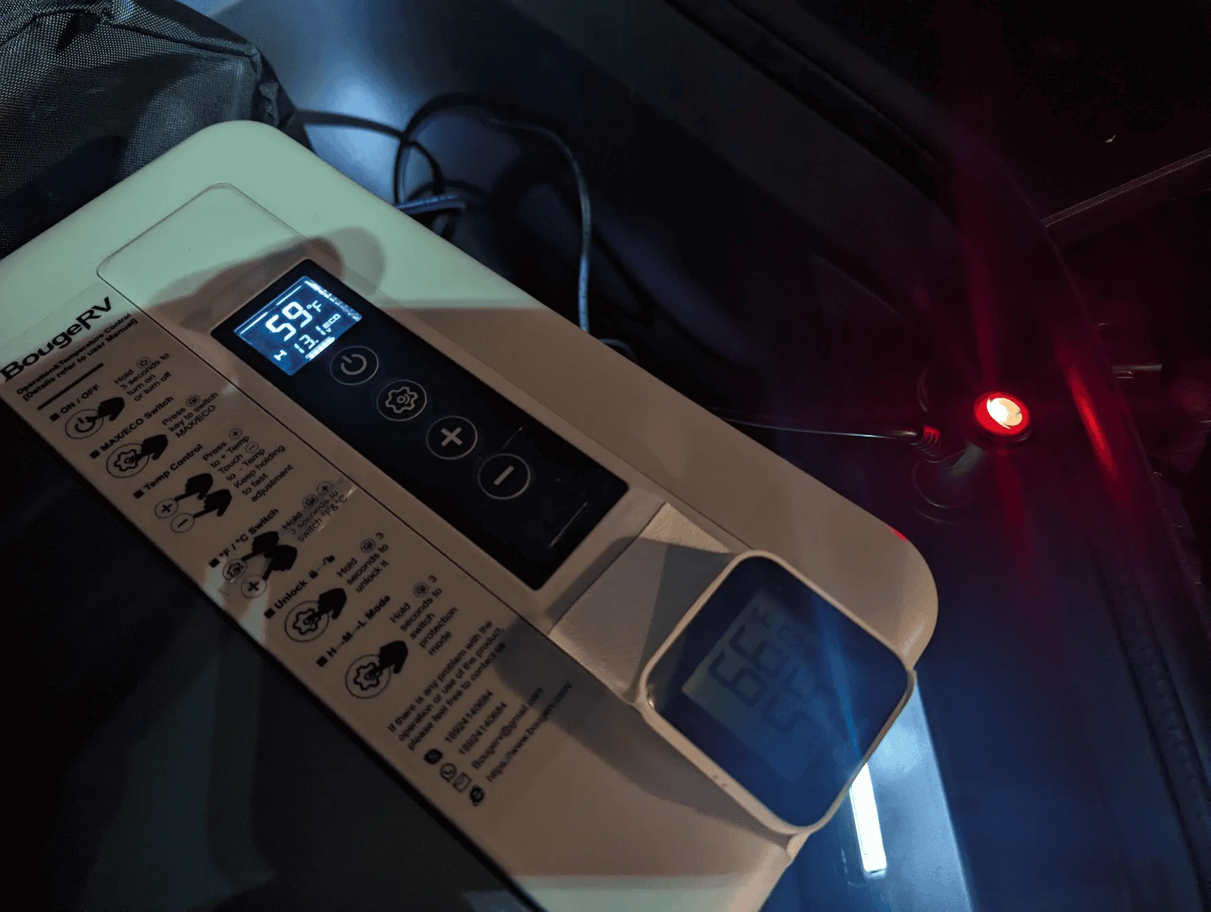

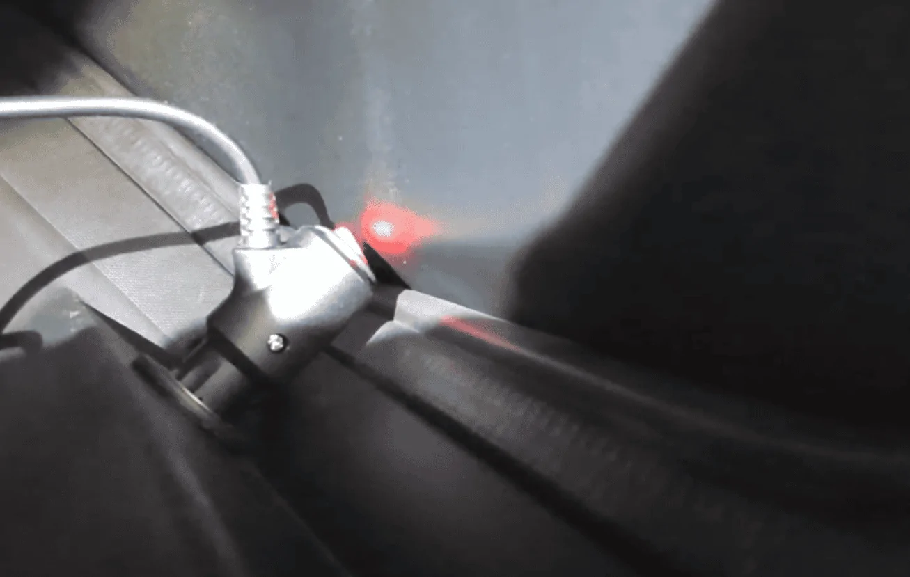

The tub has been re-installed, and everything lights up. And the trunk closes again (it doesn't close properly when tub/trim is missing)
Still need to put some trim back, but night has fallen... it can wait until tomorrow.
Rivian R1T R1S Tutorial / DIY Guide - Installing 12v Outlet in Frunk 1710904861889-ol
Rivian R1T R1S Tutorial / DIY Guide - Installing 12v Outlet in Frunk 1710904886350-bm
I am using an extension cord that is a bit shorter than a regular 12V socket. Full length will not work.
Rivian R1T R1S Tutorial / DIY Guide - Installing 12v Outlet in Frunk 1710904960112-7s
Pros:
  • looks clean
Cons:
Great work. Your decision to stay outside box for the barrel style made that a lot easier to install. If you plan to do much more crimping work in future Amazon has the tool pretty cheap and they work great
