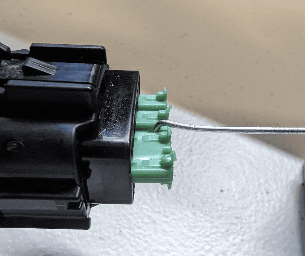

I was stuck there, too. Here is how I got it out. The metal piece is a paper clip.
Wish I had seen your solution. Yeah this part of project took me the longest. Mine finally popped.
Thanks for pic and post.
