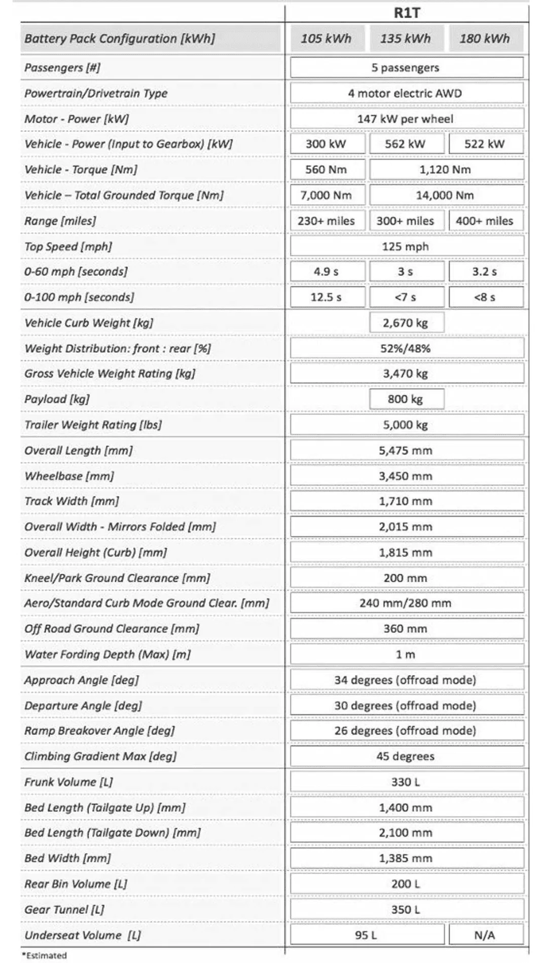

Payload on the R1T was reported (preliminarily) at 800kg (1764 lbs).
Assuming you had a tongue weight of 800lbs for the trailer, that would leave over 900lbs for "stuff".
What you load in the trailer would add only 10-15% to the payload. Adding 500 lbs to the trailer would take only 50 to 75lbs of your Rivian payload capacity.

So max payload is 1763 pounds, and max trailer tongue weight 810 pounds. That leaves 953 pounds for passengers and gear, assuming max tongue weight.

I now have updated information on the R1T towing and payload capabilities. Pulling a fully loaded 11000lb trailer may reduce the passengers to 1 or 2. Depending on actual tongue weight. Tongue weight capability for the R1T is 1470 lbs, that would leave 294 lbs for passengers. If you are pulling a trailer that size, all of your gear can go into the trailer.:clap:
Chat started: 8:15 AM
Hello and thanks for contacting Rivian! My name is Martin. How can I help today?
Customer Service Specialist
Q: The web site no longer shows data for maximum payload for the R1T, I am interested in what the maximum payload is. I also want to know the maximum tongue weight for trailer towing.
A: Sure thing! Let me get this info for you. Just one moment.
1,764 lbs for that payload. Let me get the tongue weight.
The trailer hitch receiver and vehicle structure are rated for a tongue weight of 1,470 lbs.

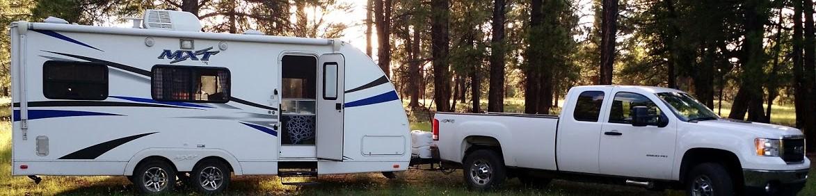

The reason I am waiting for the Max Pack (400+ mi) is that RJ has already stated that with the R1T range should be 414-424 miles. I plan on towing a 5,000 lb gross weight travel trailer (with all water, provisions, etc onboard). I hope I get 200 mile range, I figure this range should allow me to find some sort of charging point even if it is an RV Park overnight. Even though I would rather be boondocking in a National Forest for weeks on end. Utilizing the travel trailer rooftop solar(640 watts) and a little bit of portable panels should trickle charge 3-4 prime sun hours a day the R1T 5+ extra miles/day when just sitting at camp I then can drop the trailer and have some fun. Towing 200 miles is good enough for my plans with the R1T.
