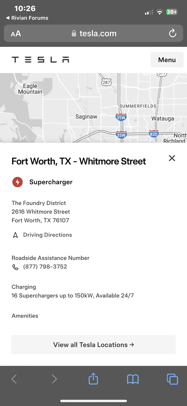

Thank you for the reply.
please see attached. I was under the impression all Tesla stations were available to rivian. This station does not appear on the rivian app.

If it says 150kw, it is a V1 or V2 and not compatible. 250 kw and up are mostly available to those with the NACS adapter.

Nothing under 250 kWh will be available. Best to use the link I provided to see what is open. ABRP (A Better Route Planner) is what I use when scoping out my potential trips. It works really well, you can also just scan the map for potential chargers in a specific area once you set your vehicle and options.

It’s probably a V2 (version 2) Supercharger. They don’t have the updated hardware to communicate with non-Tesla vehicles. They’ll be update at some point, hopefully.
