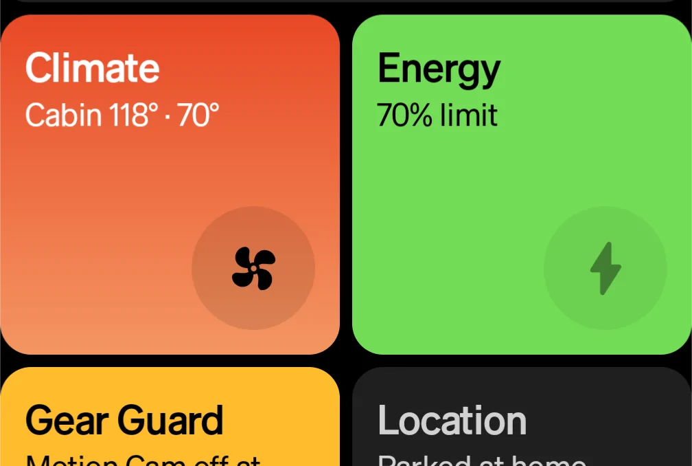

Edit:
Rivian R1T R1S Tail lights keep blinking 1752685090876-9d
(I know it's hot where I am, but this is with the windows already down)

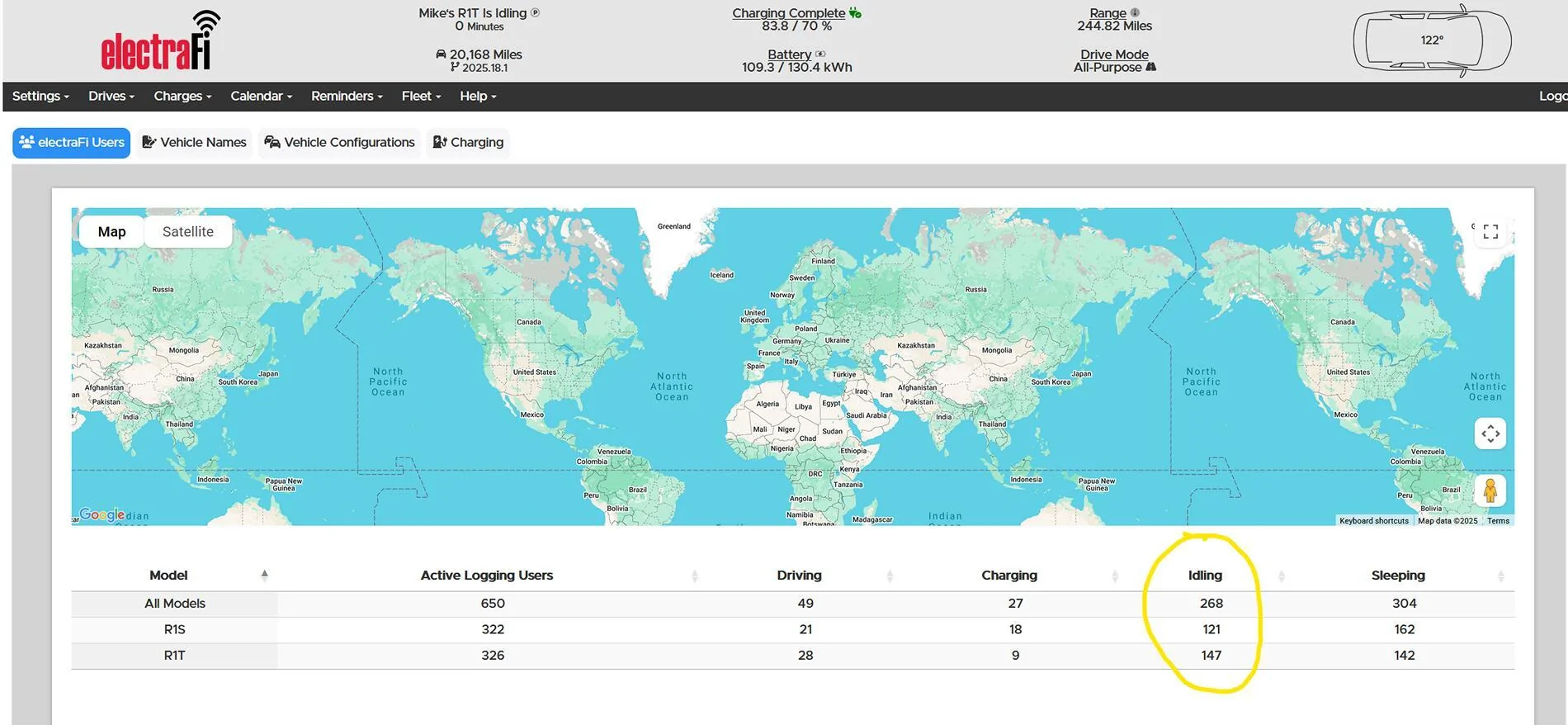

While we wait, anyone want to speculate how many of these "idling" are blinking? 🤪
Rivian R1T R1S Tail lights keep blinking 1752689050204-9f
