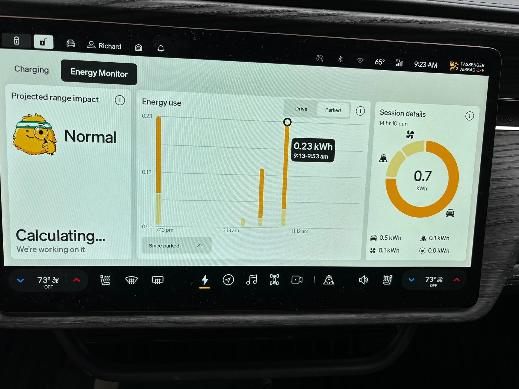

24-hours not driven stats and plugged in since yesterday. Does it drain both the 12v and pack? Says "Normal" but seems excessive for just sitting there.
Rivian R1T R1S Tail lights keep blinking Rivian-Parked

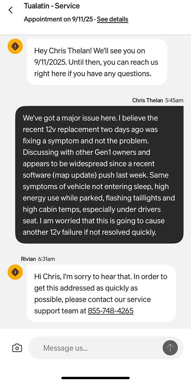

Well the SC is useless on this. Where is the proactive customer service?! Called the number and they just confirm the appointment—-in September!
Rivian R1T R1S Tail lights keep blinking IMG_2054

Called again and made an issue of it. They’re bumping appointment to Friday. No indication of a known fix.
At this rate 12v and main pack will die in the SC lot while they wait on a fix. Not sure what’s the best way to go at this point.

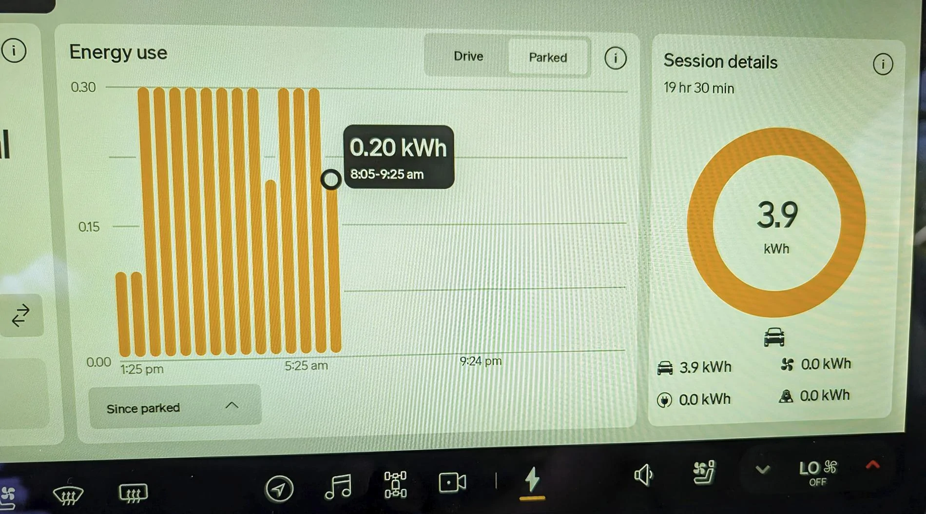

My Gen 2 R1T is fine. Here is my “since parked” usage while plugged in over the last 14 hours.
Rivian R1T R1S Tail lights keep blinking IMG_4560
No other option than waiting, sadly. Make sure to keep your R1 plugged into an L2 charger to maintain charge on the HV and 12 Batteries

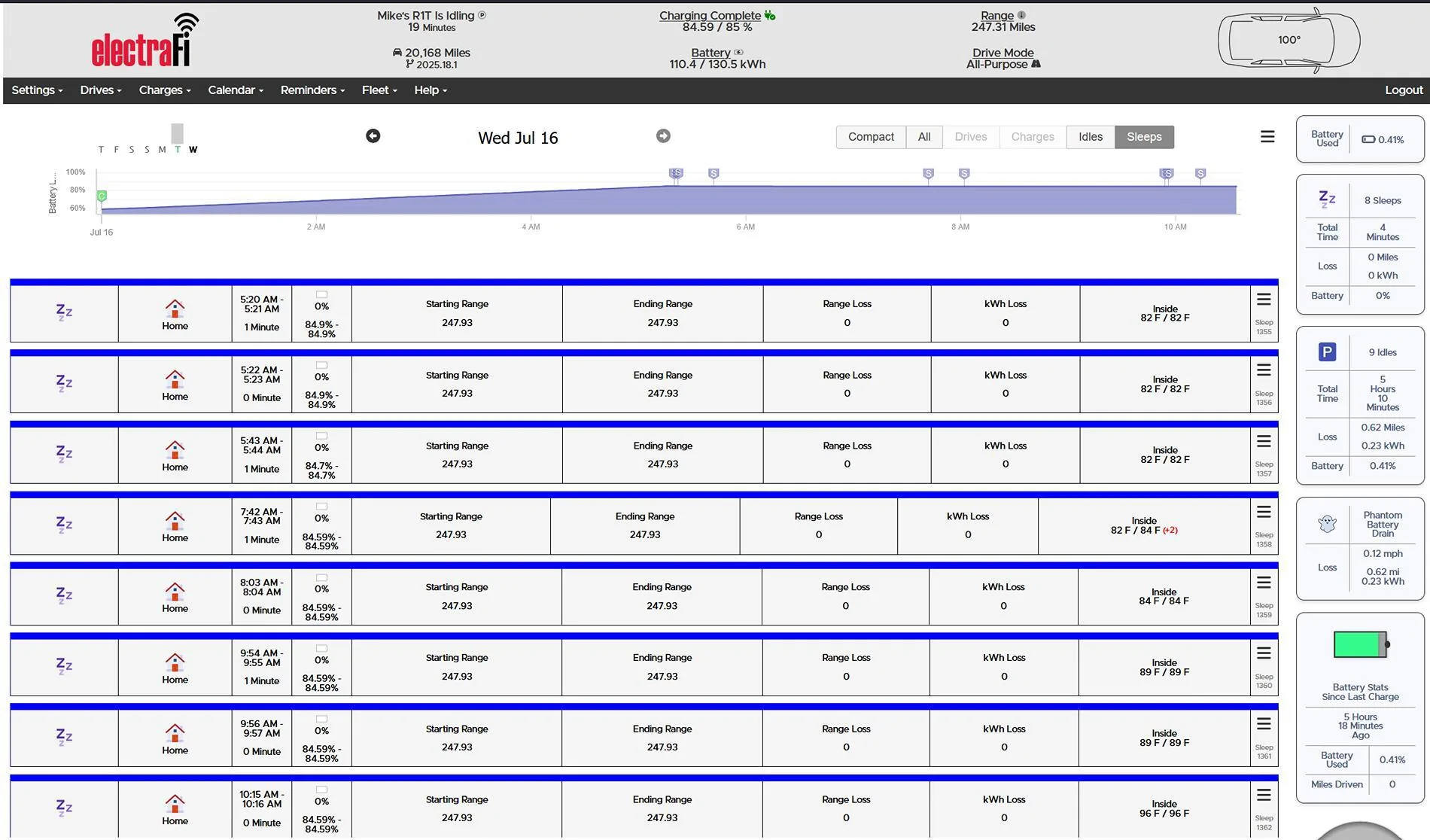

I'm not real good with this site, but if I understand this right it looks like 8x "sleeps" or "attempts to sleep" so far today, for a total of 4 minutes. And the rest of the morning has been "idling", right? (my scheduled charge completed around 5:20)
Rivian R1T R1S Tail lights keep blinking 1752676649359-wl
It's 100 degrees in the cabin already.
Also, refresher: on Gen 1's, it's the inverter under the driver's seat, and amp under the passenger seat, right?
I'm pretty sure the inverter is under the passenger seat on Gen1:
Yes on how you read ElectraFi. It's attempting to sleep but not doing so.
No about the inverter, it's under passenger seat
