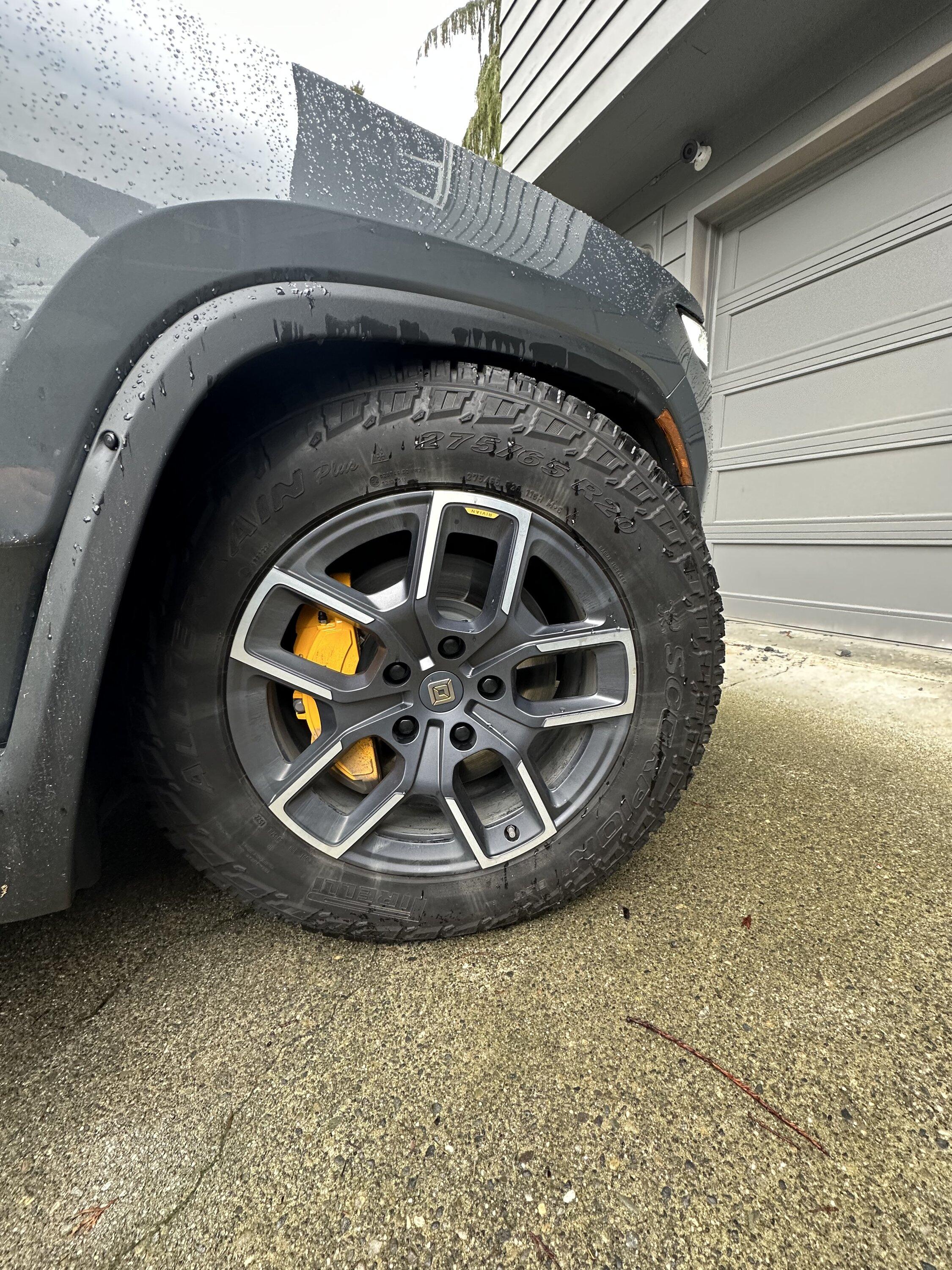

Here is what it looked like when i got home FWIW - and thanks for the replies so far! :)

Yikes! Low rider 😅. I would definitely report it, whether it gets somewhere is up to Rivian.

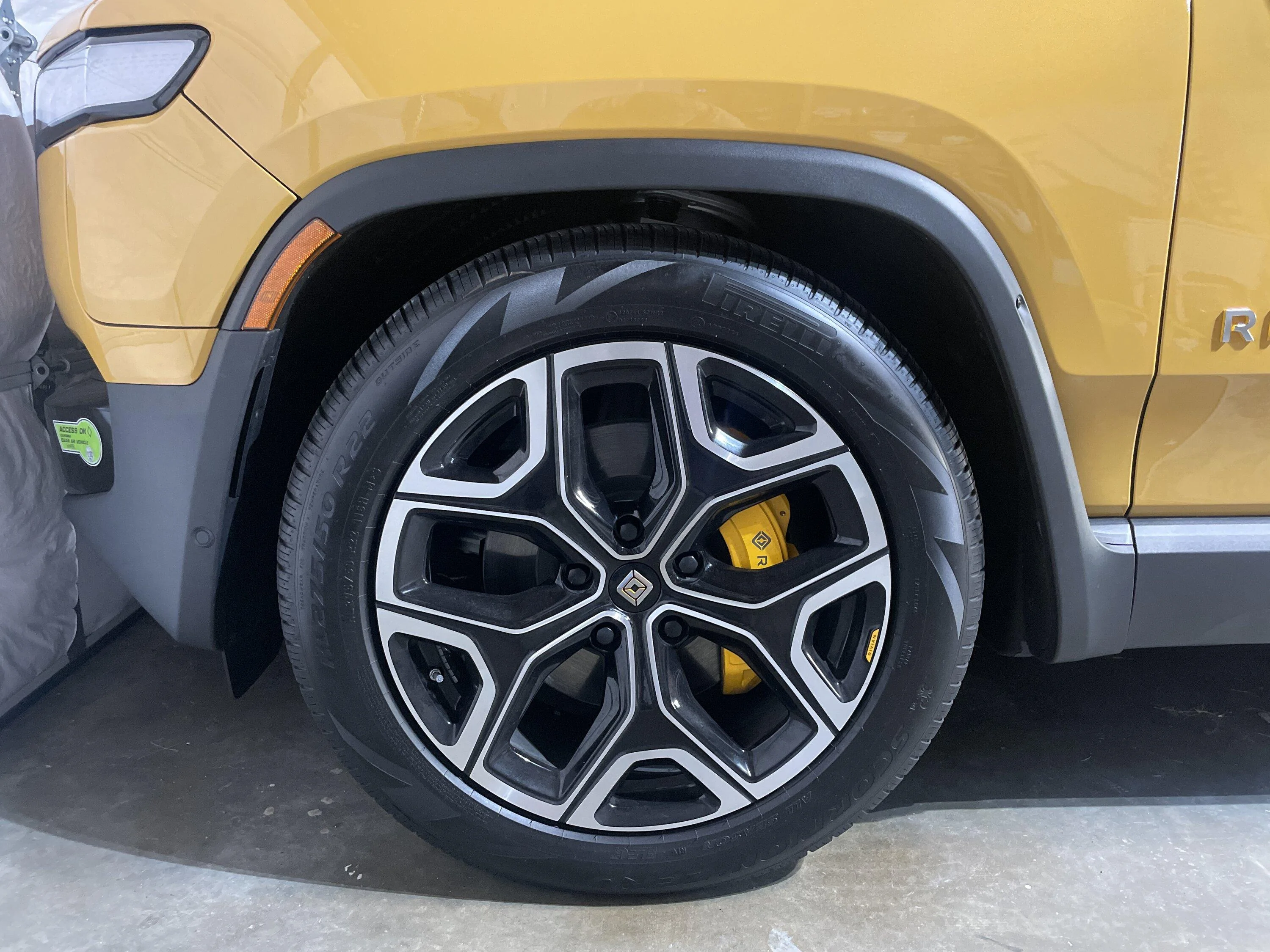

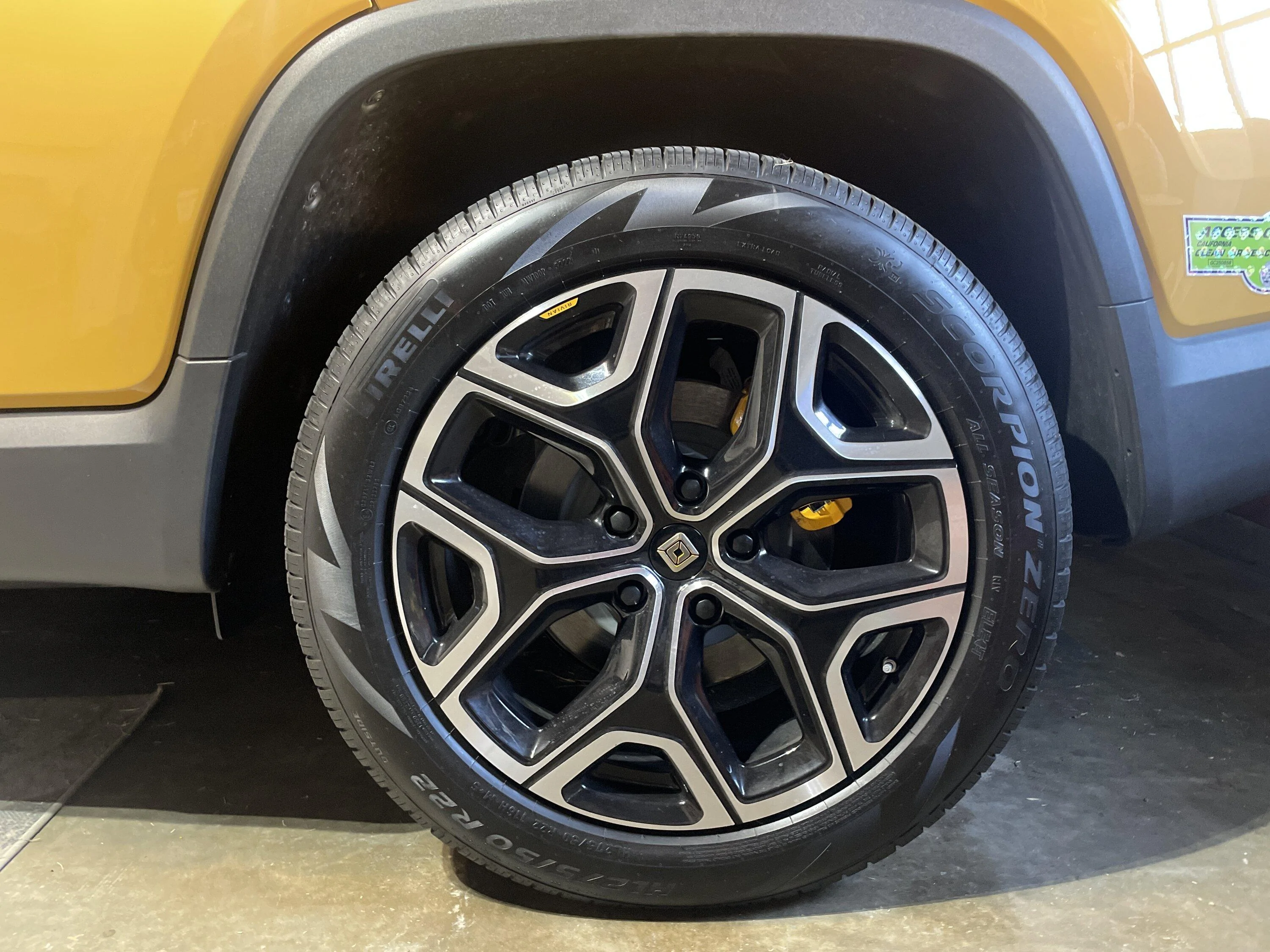

Sorry to resurrect such an old thread, but I'm seeing something similar, the back seems to retain height better than the front. Was gone a week and came back to a low front end, but on both sides. Seems like it might be normal behavior since it's not leaning to any side, just down in the front.
I don't know what to expect from adjustable pneumatic suspensions so not sure if this is really normal or I got the same bad batch of front end components.
