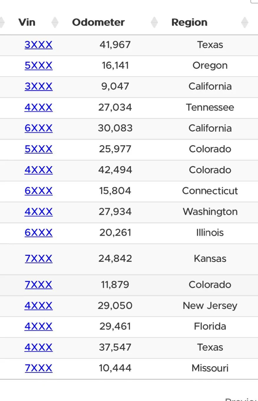

From ElectraFi data, it looks like 4xxx-7xxx VINs are represented in the 12 R1Ts that updated tonight.
I think it goes back to the beginning, early in the thread a vin 46 was updated.
I’m one of that group.
The mileage data is interesting.
Rivian R1T R1S Software Update 2023.46.01 IMG_8658
Who bought their R1T as a novelty (a +1) versus who bought it as a daily driver.
