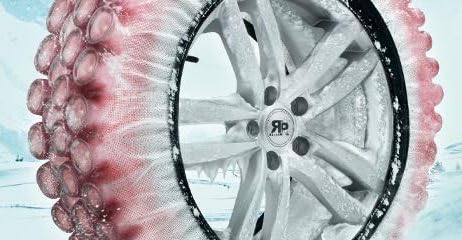

thanks for the reply. In reading prior posts, I went out and picked up some of the ISSE snow socks. Their distributors are all out of size 80 which is what their website recommends. However, the shop I purchased at suggested I stop by since they never really tested on our wheels before. We were able to fit size 78 without issue. One caveat is that there are two types: red and white. The red didn’t fit but the white fit perfectly. It’s supposed to snow this weekend. I’ll let you know how it turns out if I have to use them.

I'm still looking for that other ISSE model:
Rivian R1T R1S Snow Socks on 20" AT setup 86f3a84e9a63596ecb4a128ae94a20c4.w1200.h628._CR0,194,1200,240_SX1200_
They’d definitely help get you through those extra wet and slimy storms. :p
