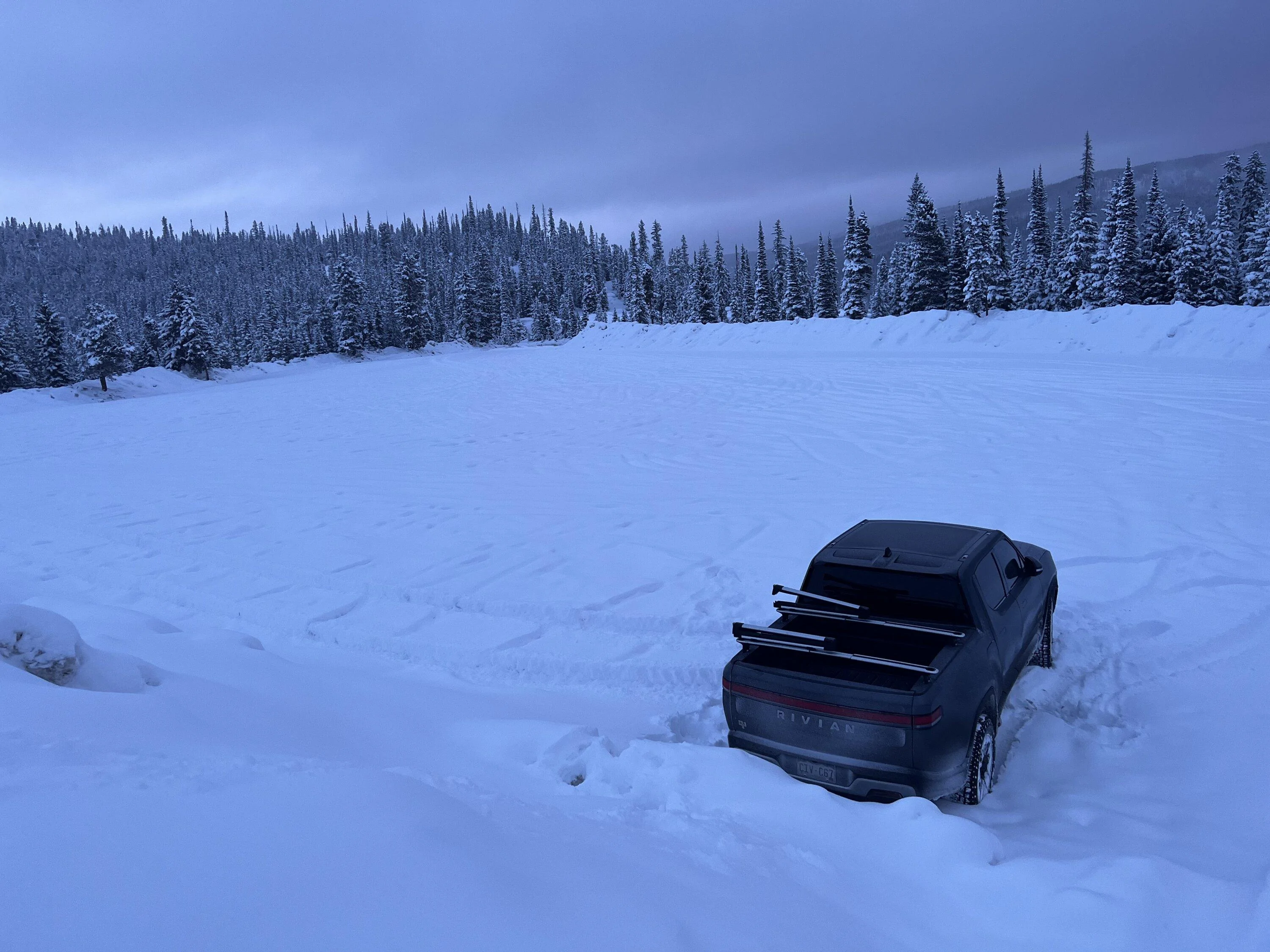

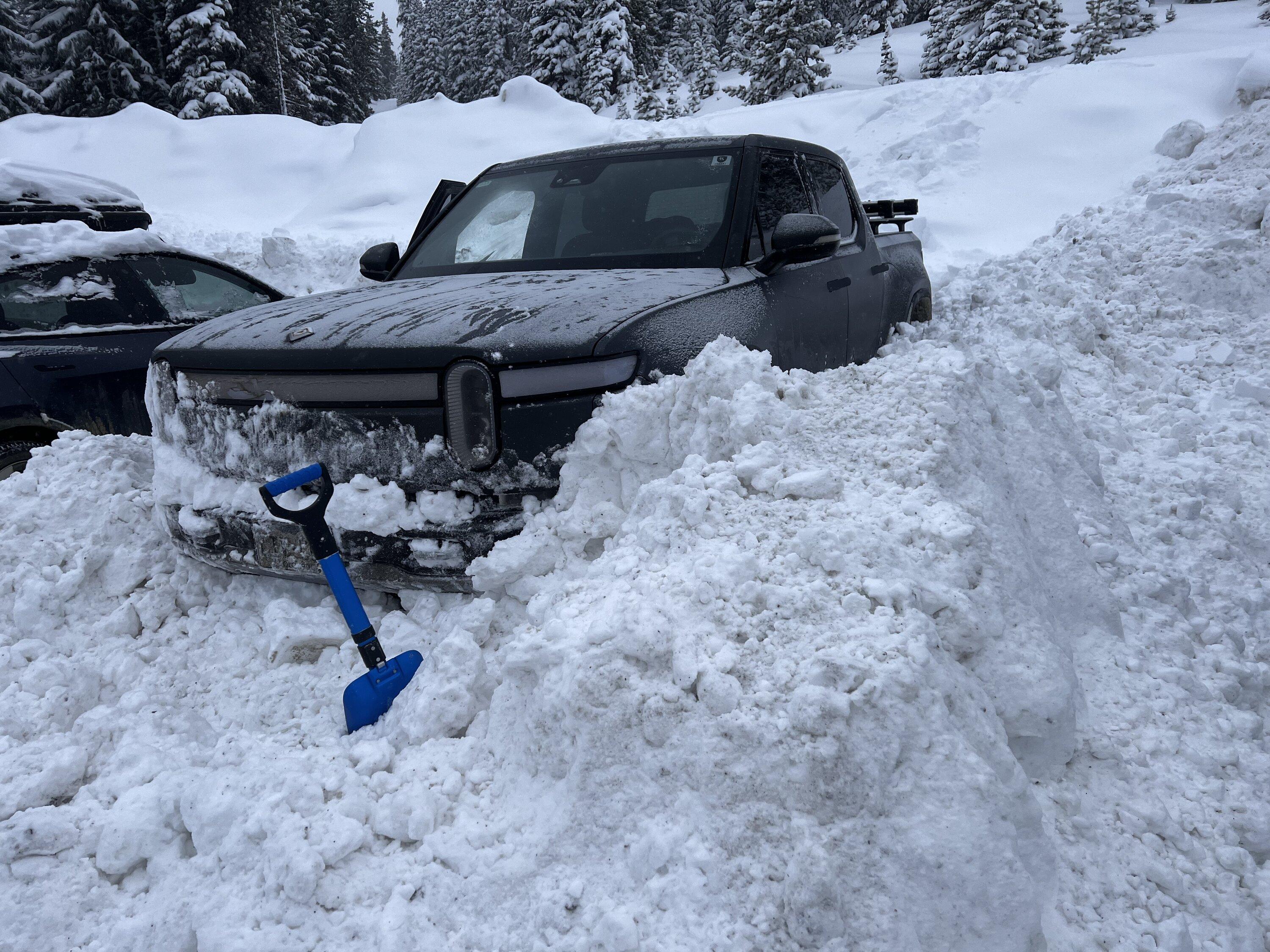

lol how did this happen? Were you there overnight, or just early/late? We almost went there last night for a tour but ended up just going to berthoud pass. I was a little afraid an issue parking at WP during the storm last night.20s did great grinding out of this cage the WP plows trapped me in! Skin track/ski pics solely for entertainment value
