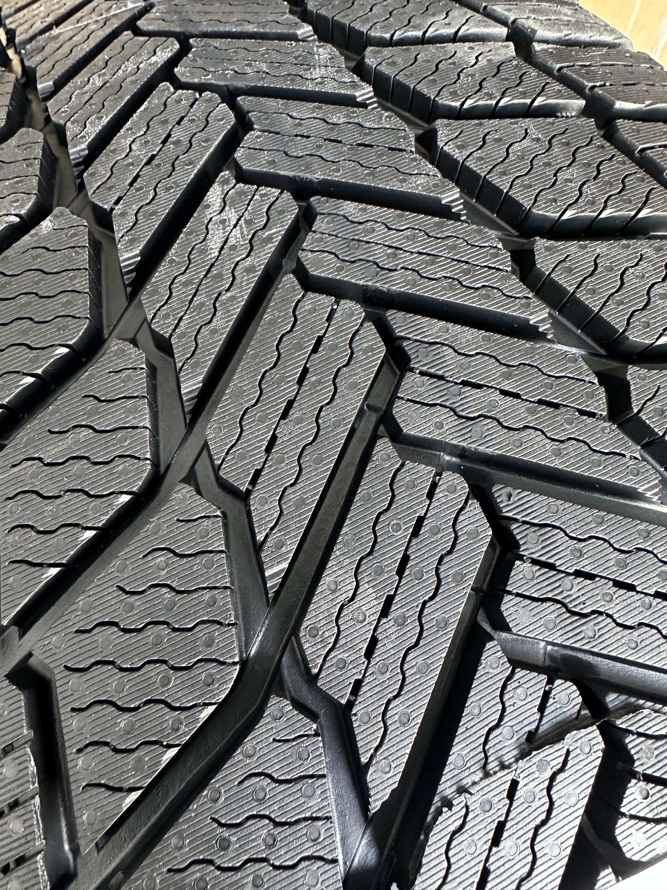

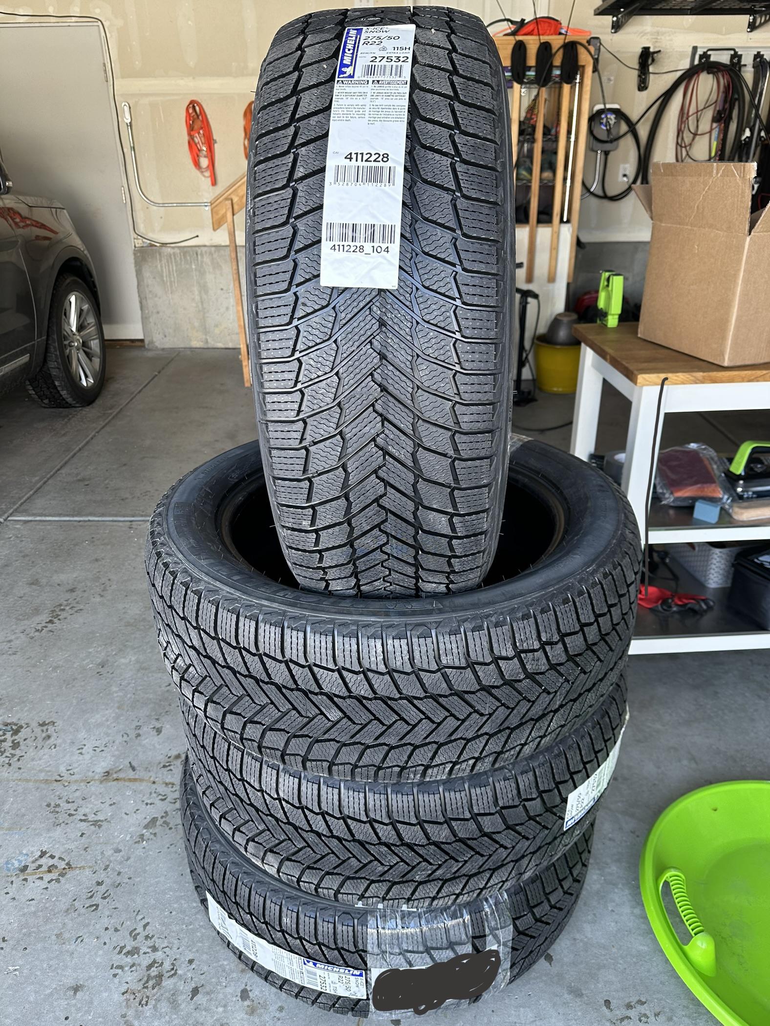

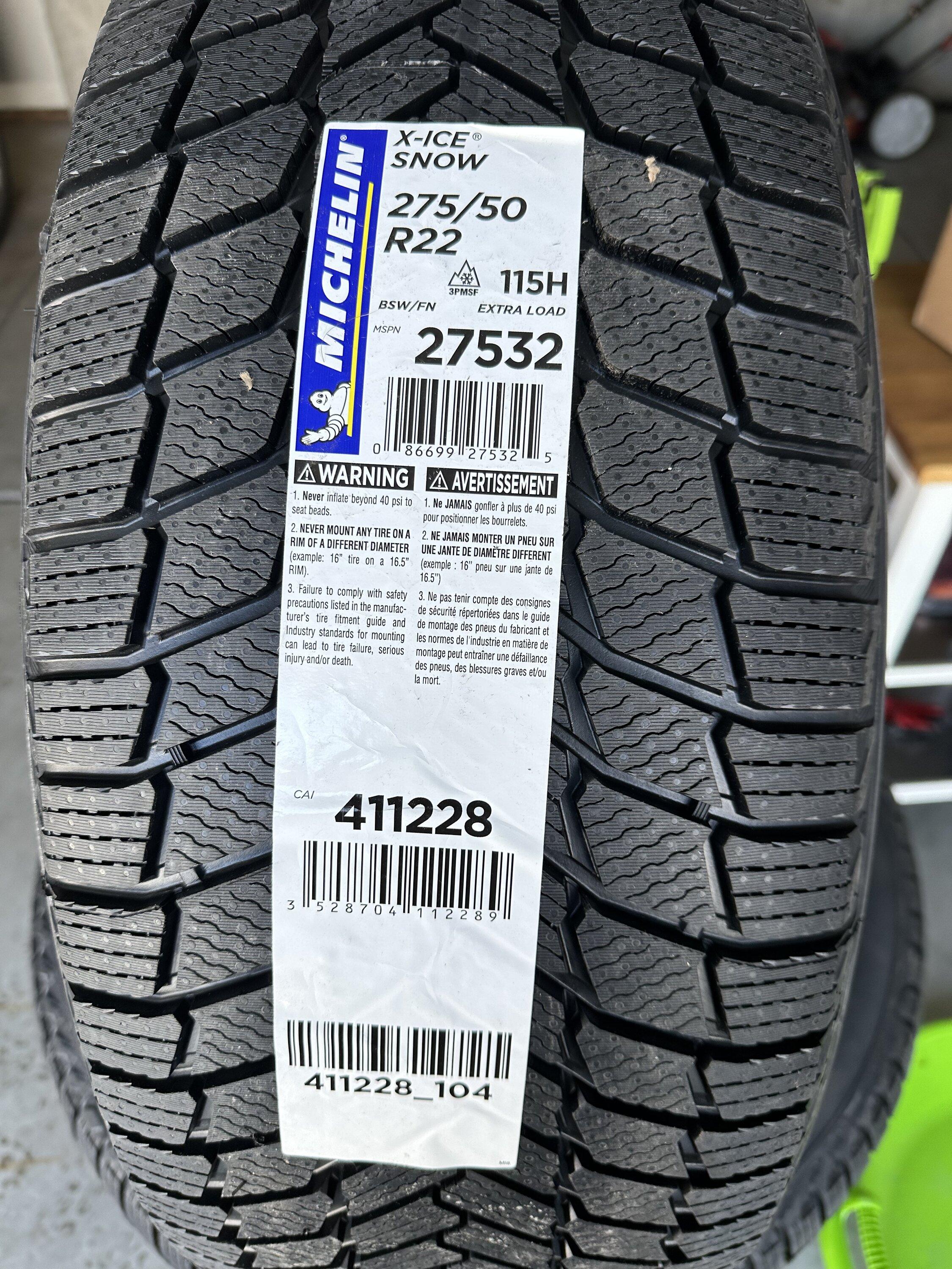

Already in the garage, ready to go (stored now)!
Rivian R1T R1S Snow performance check-in....focus on tires. 066C537B-AFCC-417B-BC44-A3322DE6F438
Rivian R1T R1S Snow performance check-in....focus on tires. C05D56C3-F210-4B91-832A-44F42AE8F792
