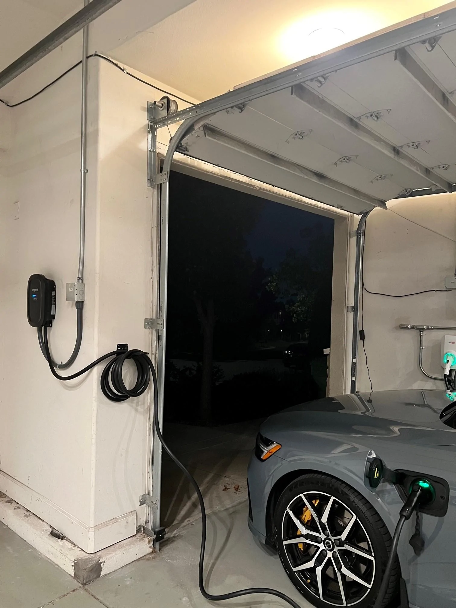

Emporia 48A and Solar Edge 40A. Both smart EVSE that will utilize any excess solar power our panels produces.
Rivian R1T R1S Show off your Level 2 Home Charger installs here ev charger
