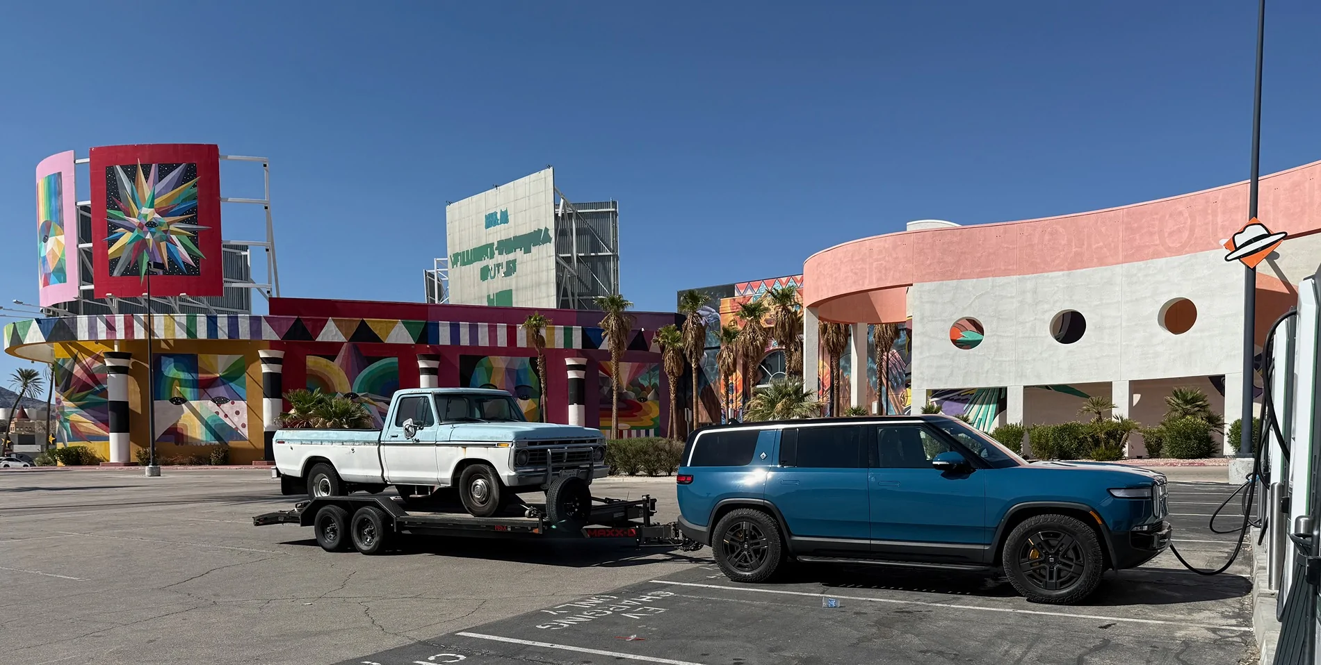

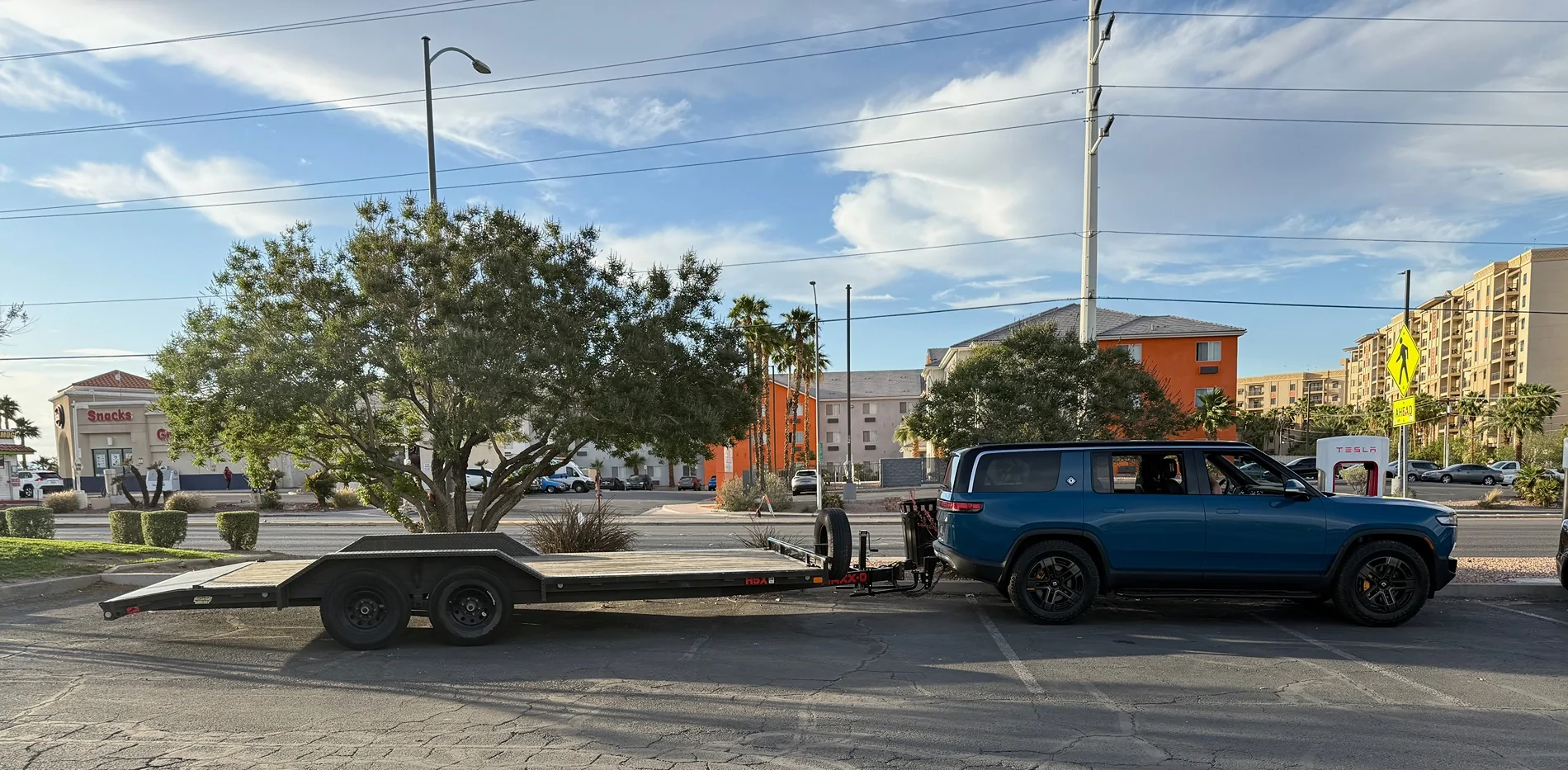

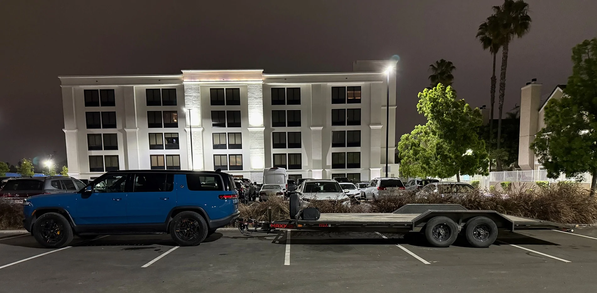

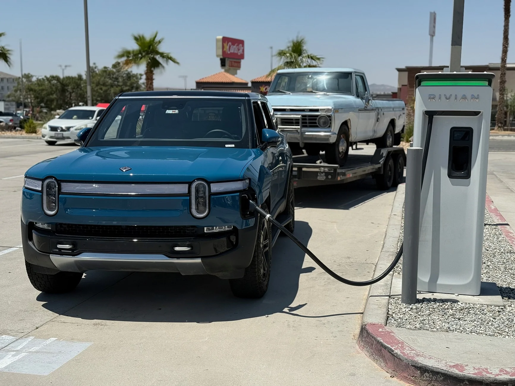

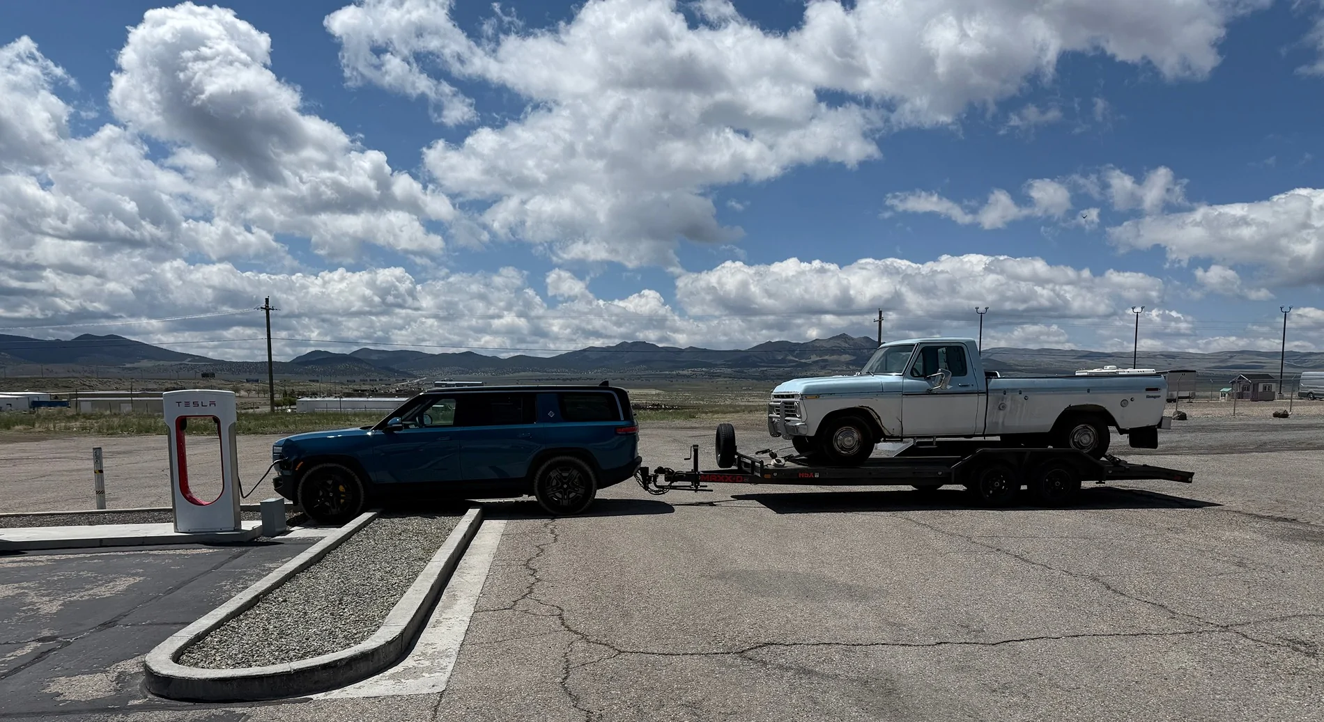

Just my $.02 and YMMV... use a WDH and a compatible trailer.
I’ve never towed with a U-Haul transporter, but I have towed an empty 20-foot MAXX-D H5X trailer with a Curt TruTrack 2P 10K WDH from Salt Lake City to San Diego, then back to Salt Lake City with a 1974 F-250 Ranger behind my Gen 1 R1S Quad.
I didn’t know anything about towing a vehicle with my Rivian before that trip so I did a shitload of research, and it didn’t take me long to decide that a WDH was the only way to go. I’ve towed in other vehicles without using a WDH, and the experience was always less than joyful, especially in bad weather and on bumpy roads.
The Rivian was in all-purpose mode and standard ride height for the entire trip. The truck, the trailer and the hitch all performed flawlessly, even through some heavy rain in California and 40+ MPH crosswinds in Nevada. Having been through the experience, I can’t imagine towing a vehicle across town - let alone across multiple states - without a WDH.
Rivian R1T R1S Seeking advice for towing a car IMG_1250

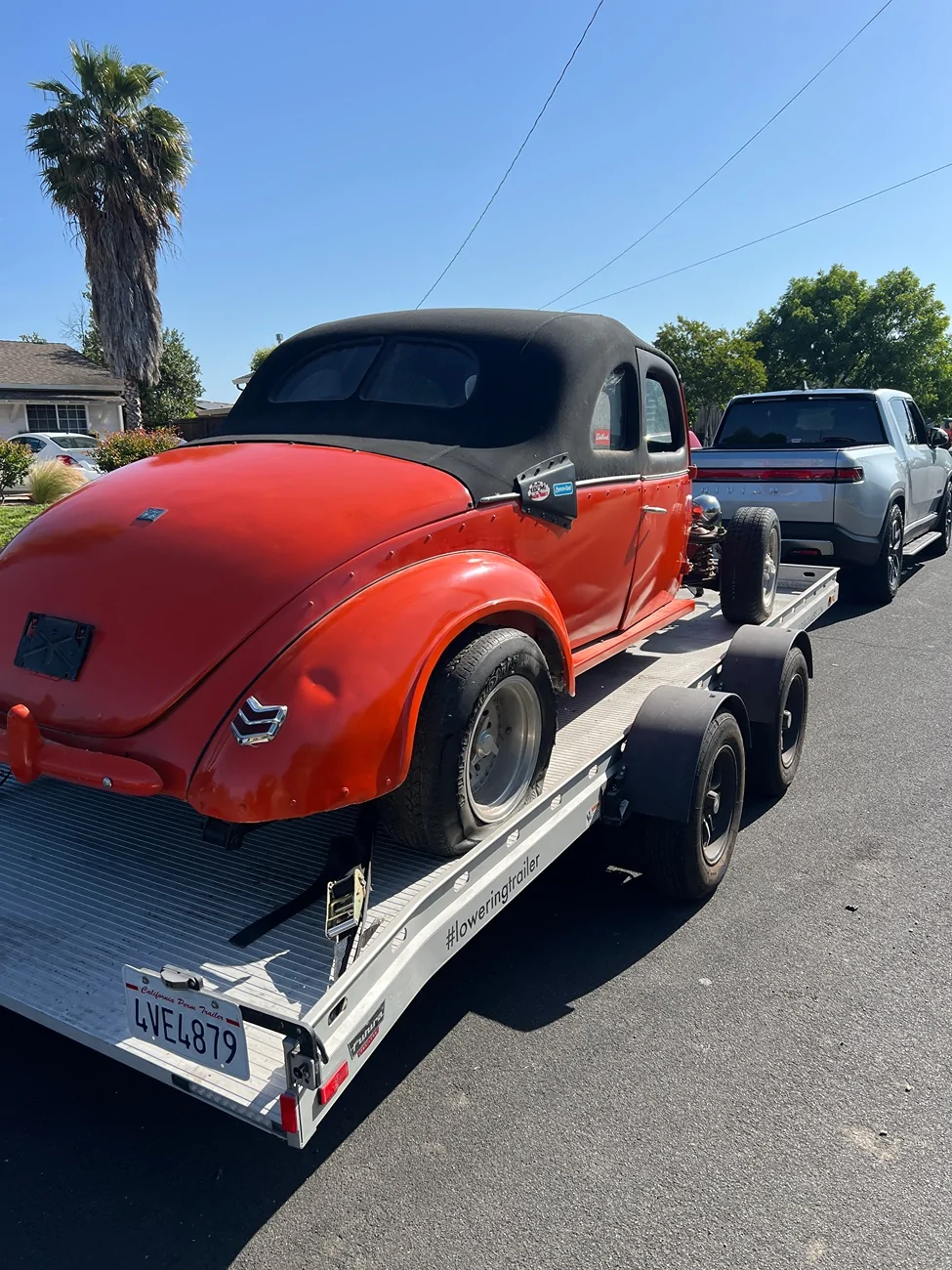

In case you’re wondering... there’s a reason I towed an empty trailer to California to pick up the Ford. There weren’t any suitable trailers in San Diego available for a one-way rental to SLC, and I wasn’t going to shell out $8k for a new trailer and then deal with selling it after the trip. My round-trip trailer rental from SLC was just $250 including trailer insurance. Money very well spent IMHO.
