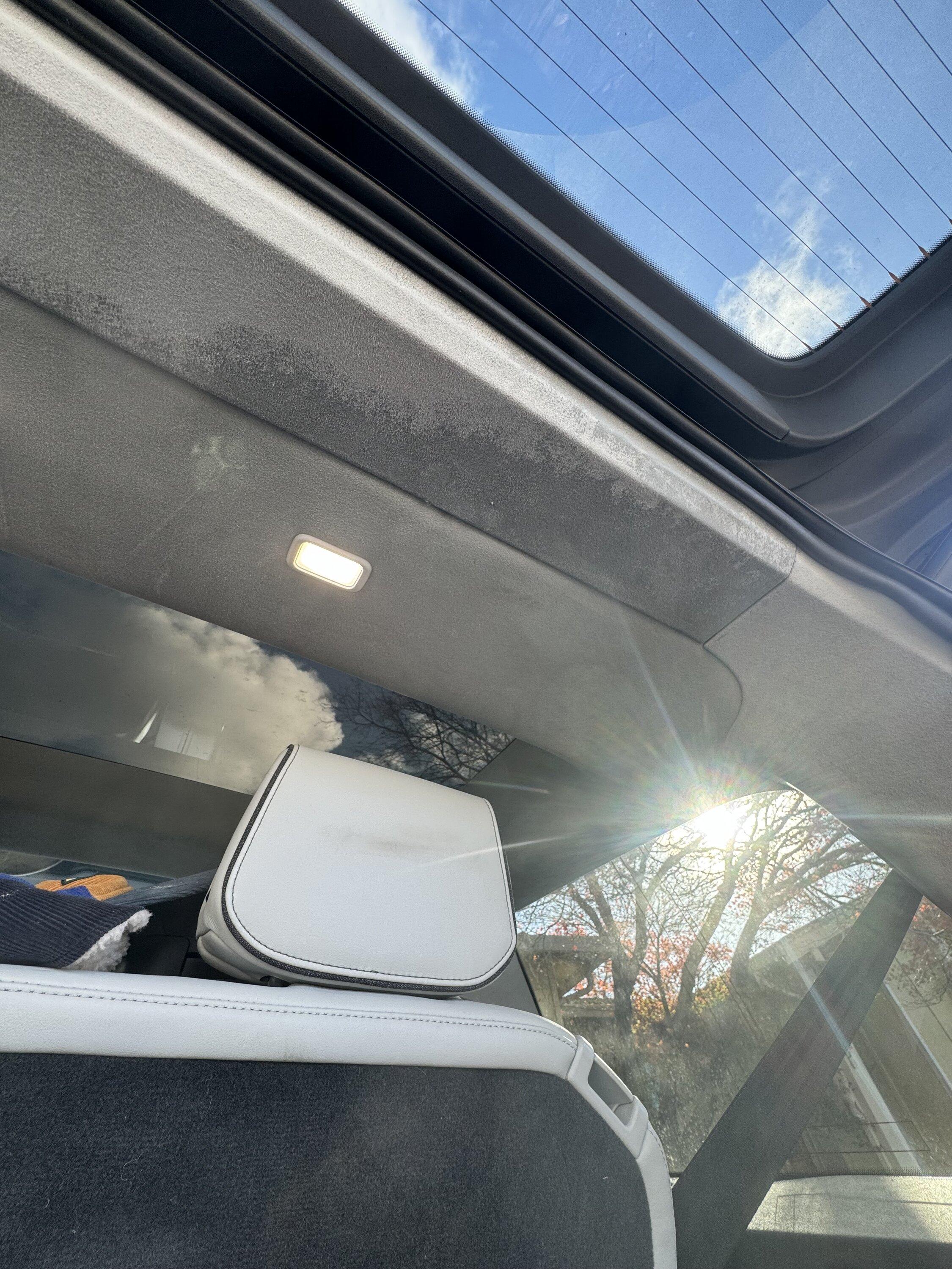

It’s been raining here in the Bay Area and while I was getting our stroller out of the trunk the other day I noticed the roof panel soaking wet and the floor board and multiple times as well that were covered in water.
So it seems the roof is leaking somewhere and is pooling inside of the upper panel and than leaking. Not good and will most likely cause mold etc over time. Appointment set for January 30th. Hope it’s sooner. Ugh
Rivian R1T R1S Roof leak in new R1S - water dripping out of the sun visor hole IMG_4356
