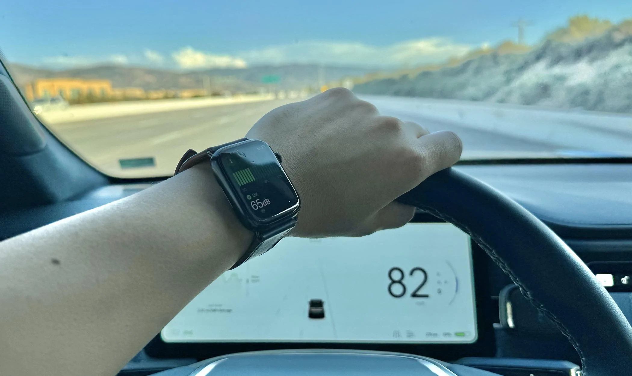

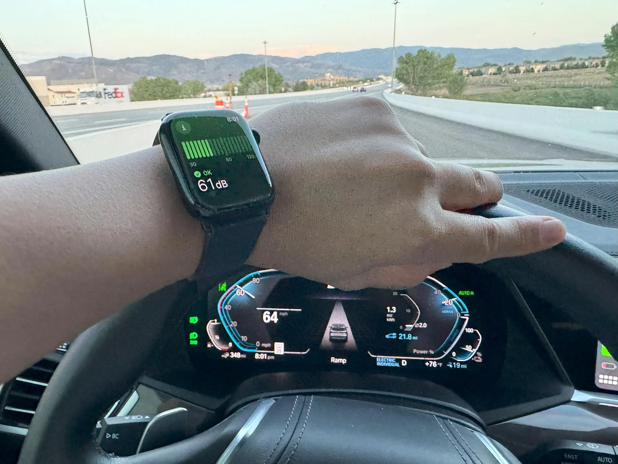

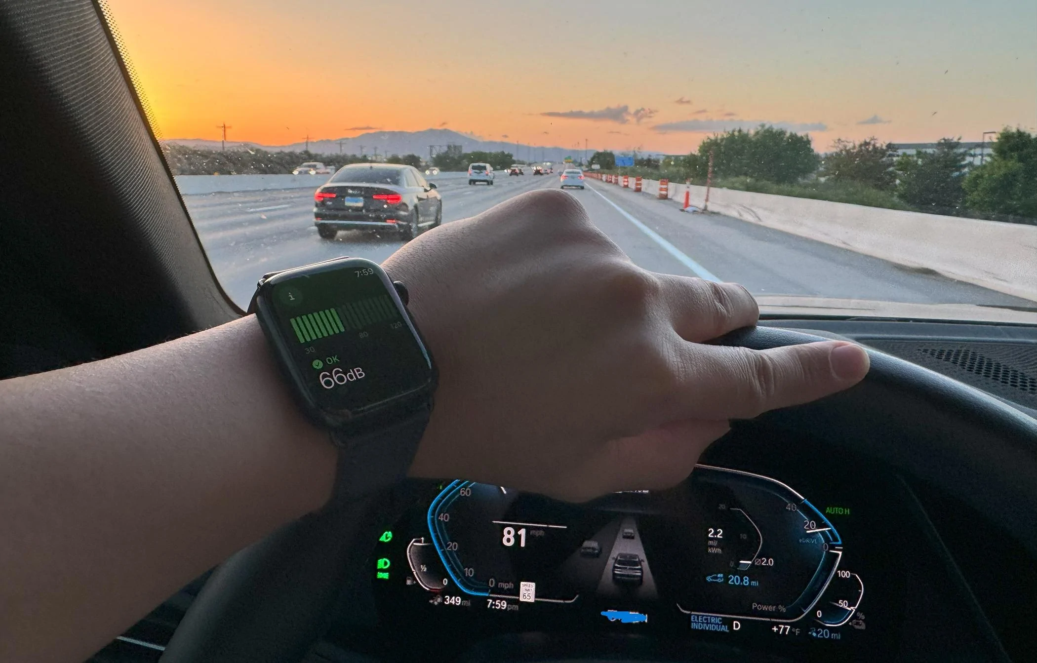

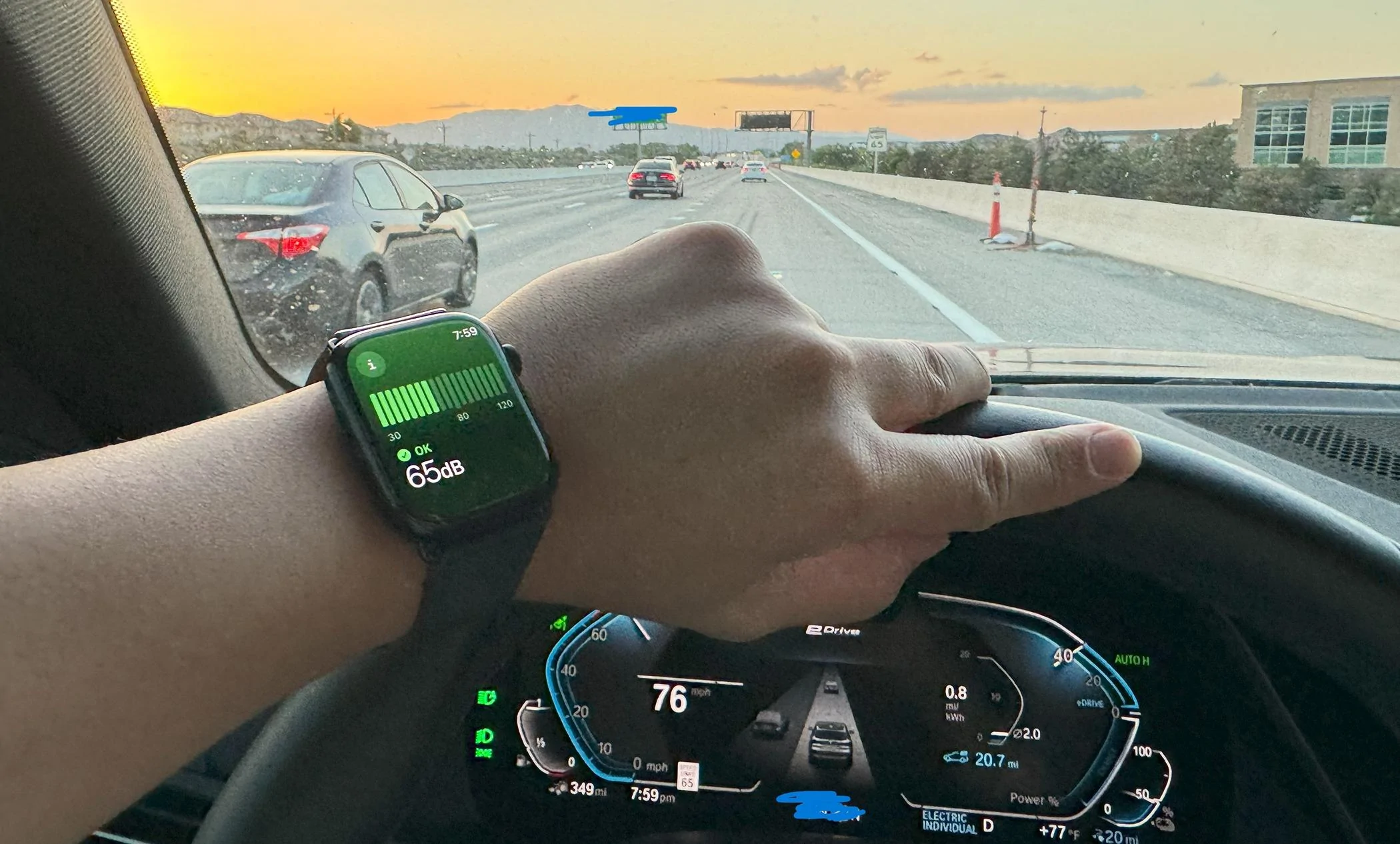

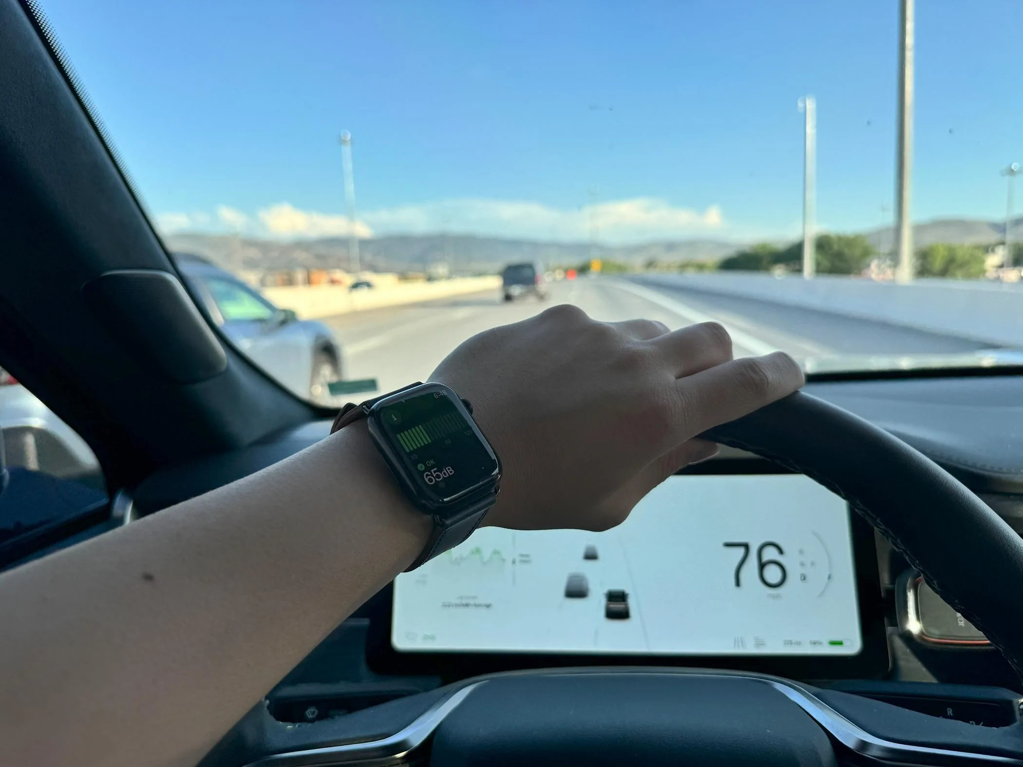

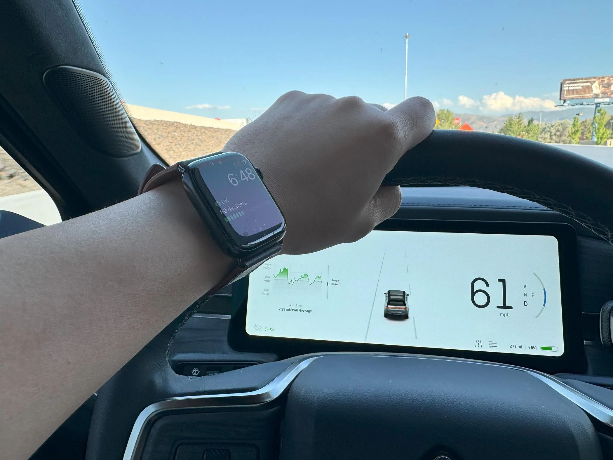

Totally agree with you madgrey, but I'm happy to contribute to the community. Doesn't hurt to have more data, in case someone's Rivian is way louder than mine.
Here are the dB readings from my apple watch (series 7). I did both my Rivian and the BMW X5 45e hybrid (in electric only mode). AC fan off, same stretch of highway, and roughly the same speeds (hard to drive, monitor traffic and snap a quick photo)
For those unfamiliar with the decibel (dB) scale, it is logarithmic. Meaning an increase of 10db is 2x the loudness. so 60db->70dlb is not 16% increased loudness, but 100% increased loudness.
Rivian:
61mph - 60db
76mph - 65db
82mph -65db
BMW X5 45e
64mph - 61db
76mph - 65db
81mph - 66db
Keep in mind this is an apple watch and not a special sound testing equipment. the 1db difference is probably well within margin of error, but it shows my initial assessment was correct in saying the Rivian is on par with the BMW in terms of quietness now. I'm also going to update my original post with this info
