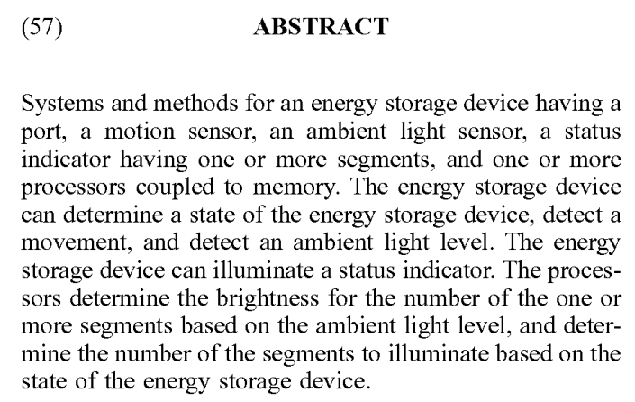

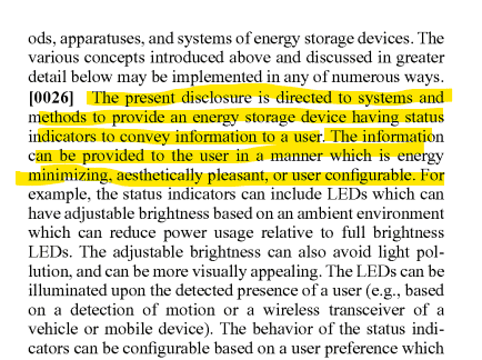

What do you see as the "invention" Rivian is claiming ?
I guess this application will get granted, but I hope not. Not claiming any kind of battery technology or storage capability, but listing a lot of indicators and sensors and status lights and connections to computers or devices, almost as if they just wanted block others from designing energy storage systems for your home. trying to cover every display and connectability aspect they could think of. Nothing seems to be described in much detail, almost trivial.
