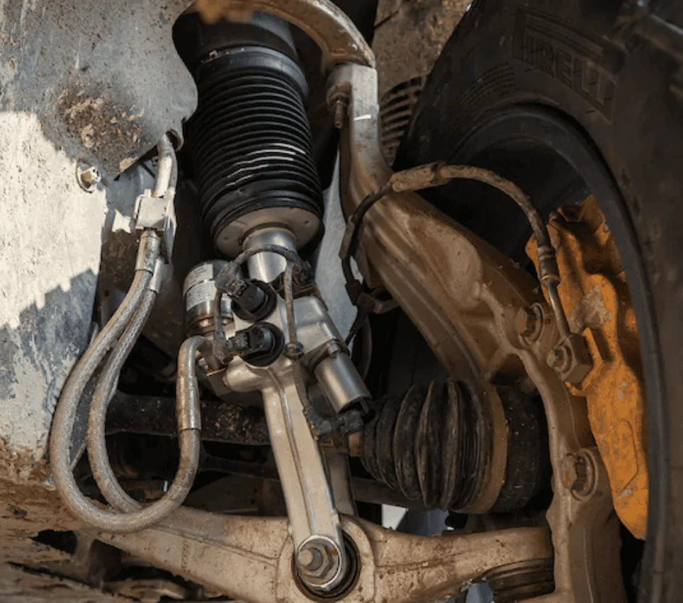

For reference, here's a picture of an Rivian Air spring (MotorTrend article). If it's deflated, the bouncy ride is probably because it is acting like a mostly compressed soft spring.
