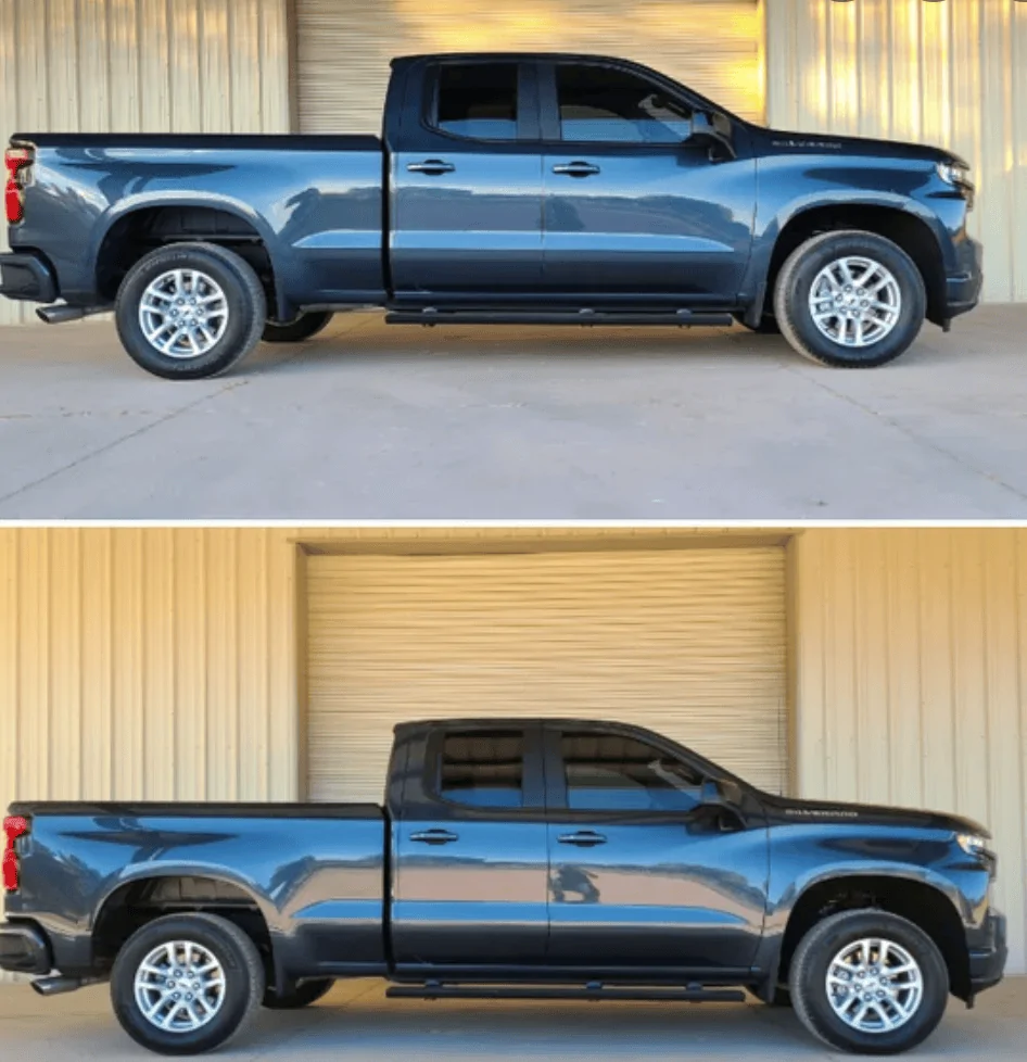

DIdn't know that. I have Rancho 2" lift struts on the front of my Avalanche, no lift on the rear - levels it out. For some inane reason, Avalanches and Silverados had 2" rake for years. Stupidest design ever, especially if you have a snow plow. Rancho came to the rescue with a 2" drop in replacement. Here's a before/after pic I found online of a Silverado. You can see the difference in the wheel well and ground clearance. Thanks Tenneco/Rancho!
Most IFS pickups of the last 15 years or more have a similar rake. Fortunately there are lots of levelling kits!
Or if one is frugal, 750lbs of used grader blades in the bed from a friend at the highways department accomplishes a similar visual result

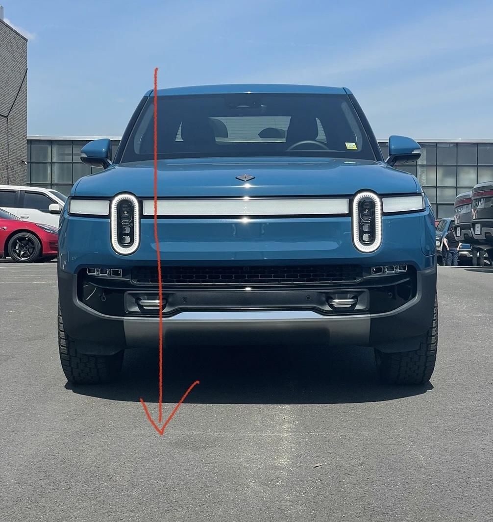

I've had an on-going issue/non-issue, and am just curious if anyone else is seeing something similar. I've been convinced that the front-passenger side is sitting slightly lower then the front-driver's side (maybe 1/2"). I thought it was just my eyes playing tricks, but I took a tape measure to it and it is. I called service, sent them pictures/video, etc. They did their due diligence and pulled the logs. I received a call from Service saying that they'll take the truck in and look, so I said I'd get back to them once I figure out a time that works for me. I then I got a follow-up call yesterday from someone else that was reviewing my file, and they believe the suspension is performing as designed.
Also of note is that I had a suspension service light pop on on Day 2 of ownership, and they took the truck to the SC and fixed that issue promptly (and presumably did a diagnostic on the suspension at that time). There is no fluid leaking either.
There are no warning lights and the truck seems to drive fine. The air suspension does raise and lower on all four wheels. I saw the other post where there was significant sagging, and I would not put my issue/non-issue in that category.
Having said all of that - I'm still not 100% convinced that something isn't a little off. My concerns have been noted in my file, so if something more severe does happen, I am on record with them as expressing concern. Or if I still think it's an issue a month from now, I will schedule an appointment for them to look.
For those that are well-versed in the world of air suspension, what say you? Issue or non-issue?

place a level on the hood. perhaps your garage is sloped and the suspension is evening it out.

Have you seen @Jazzyjeff139 ’s story about his passenger side lower than the driver? Here is his photo. I can copy his post from R.S. if you haven’t seen it…

I’d measure from center cap of wheel to underside of wheel arch on both sides at each height you can select.
If the truck is consistently higher by 1/2” on the same corner then the suspension probably needs to be recalibrated. I know that our LR3 needs to be recalibrated if a height sensor is replaced because they may read differently. Maybe a height sensor was replaced after the earlier error and repair but the calibration wasn’t done?
If the side to side height varies at different settings then it may just be within spec. ¯\_(ツ)_/¯

Thanks for this - I went and found @Jazzyjeff139 post on RS and read through it. Very helpful. Sounds like he's in the same boat as me - there is definitely a lean, but as of now it doesn't really seem to be impacting performance. Maybe a software update fixes it, or maybe I just need to have it recalibrated at some point. We'll see...
