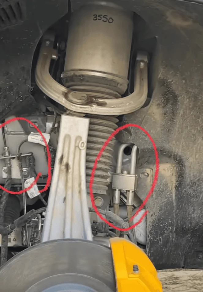

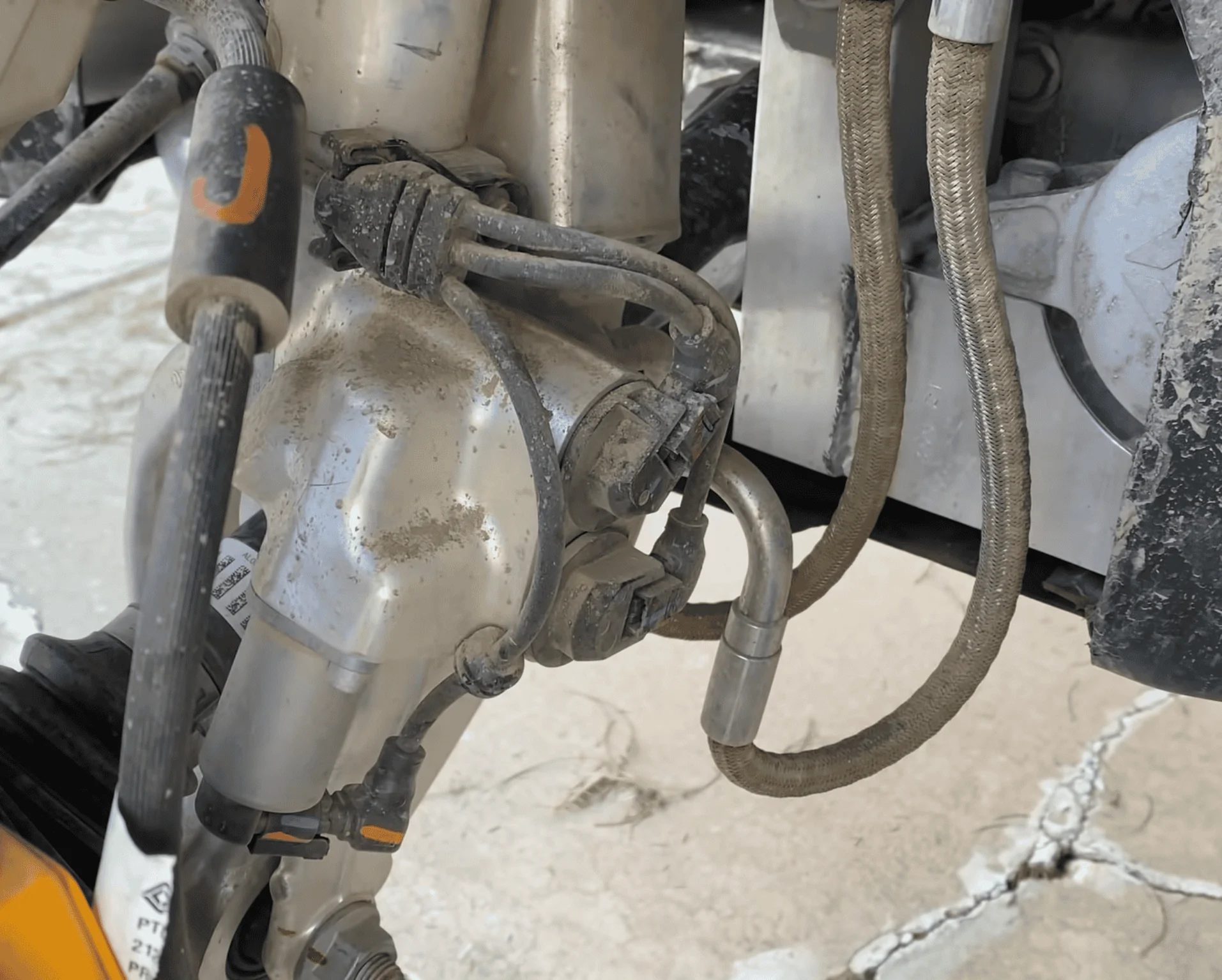

I have no idea what I am looking at but here are some areas for those of you that do to speculate over:

Here is a view from under the truck. Definitely can see some oil. Overnight, it was parked mostly flat and no spots on the street. Probably some gasket not seated when on incline.
If that's the rear of the truck, it's definitely the hydraulic lines. The hydraulic lines go from side to side and from that picture it looks like there's some leak in the hydraulic system.
That picture was looking at driver front wheel. Rivian support called and they were saying that its very probably the dampening hydraulic fluid that runs cross front driver to rear passenger and so on. They are working on a plan if they will send a mobile service or take it in for servicing.
Ah also makes sense, yea the lines run criss cross for the roll control so thats definitely it. Probably just a un-crimped 100% line or the nut for the lines need to be tightened. Could also be a pinch in the middle but either way Kudos on being the first probably REAL service issue.
Im sure there will be future lookouts for this.
Is it just me, or do those hydraulic lines look seriously exposed?
Edit: as I look at them...wheel off and presumably the strut fully extended...the angle to the hose on the rear one looks...sharp. In my mind I see the wheel coming UP and the half loop of line hanging down and...well it looks exposed. It's just the roll control but still.
I do believe those are the hydraulic lines for the viscous dampers (or whatever they’ve named it). They are definitely exposed. Photos from the First Drive events showed them looping well below the skid plates. I’d hoped this was going to be fixed by production —very easy to pinch or snag them on a rock off-road.
I’m not so sure it’s the brake lines leaking anymore, but who knows what fluid is in the lines for the dampers. Definitely get your use out of that warranty and mobile service team!

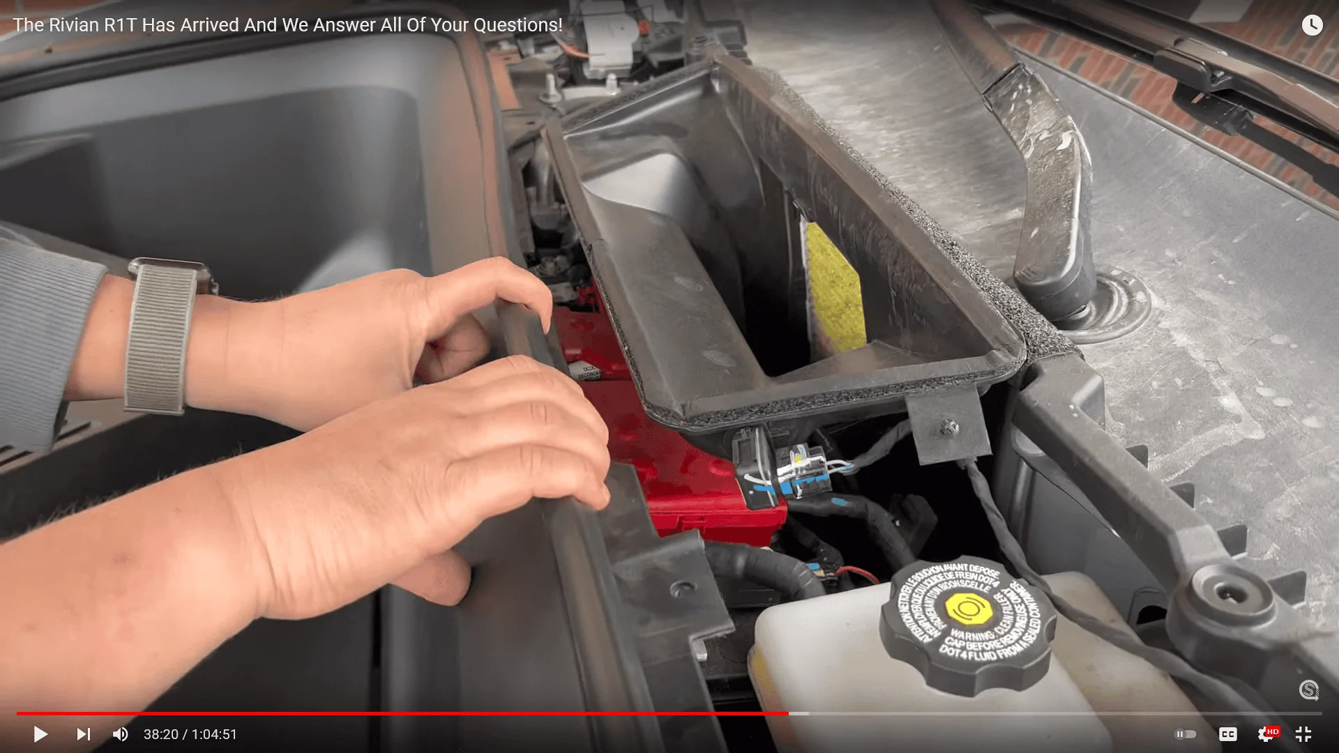

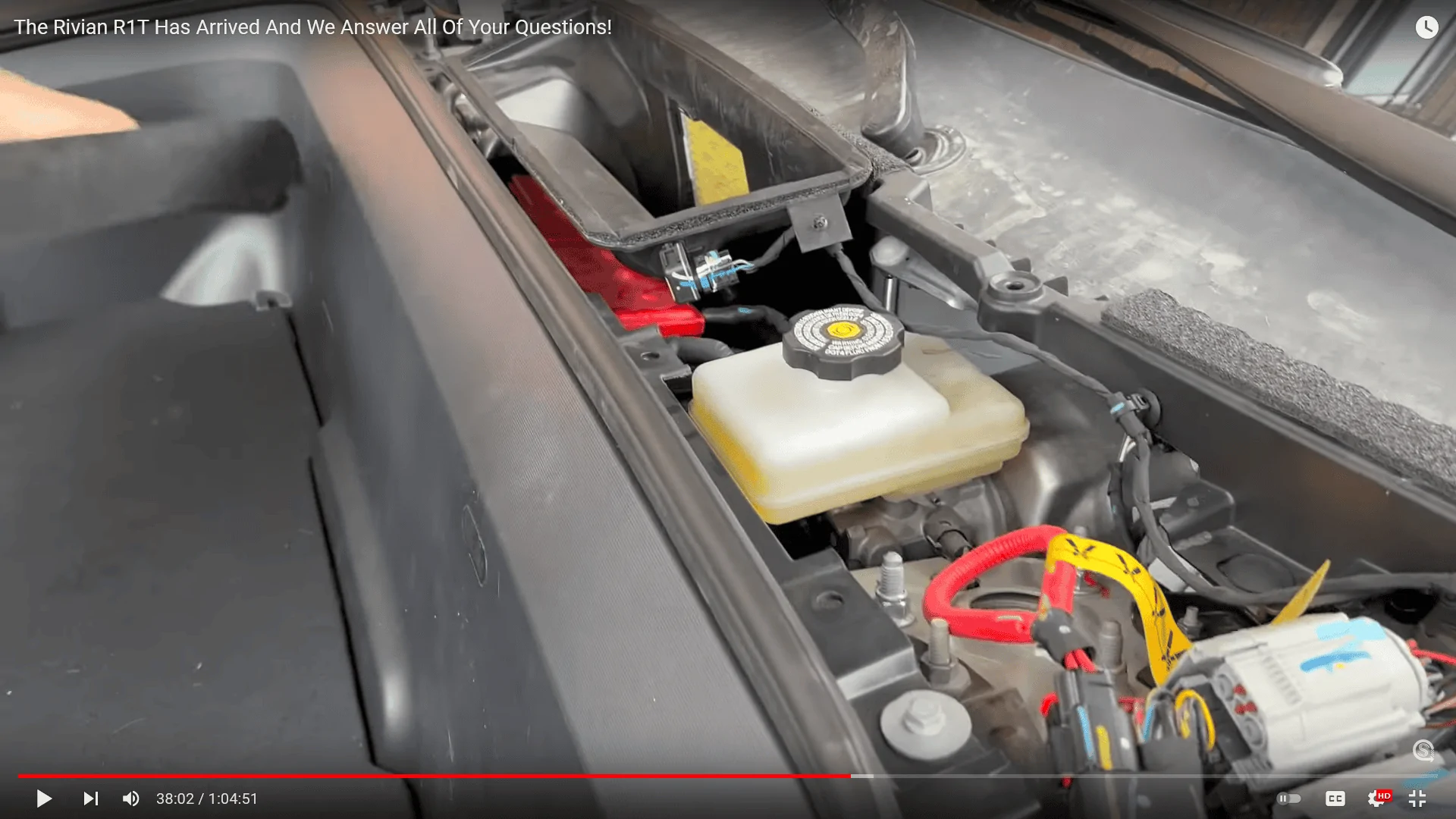

Yes, he did pull fascia piece in the (37:15 mark) video in an attempt to show the two primary batts. Unfortunately, the camera never really stopped for long at any one spot so it was kind of hard to identify components in that area between the firewall and frunk.
Someone here had mentioned that he was told by a Rivian employee that the batts (two red objects directly under the air intake duct) are actually 6vdc each wired in series to produce 12vdc. He was told the reason for that configuration was that Rivian could not find a single 12vdc battery with the electrical specs they needed to fit in that spot under the duct? Is that the case??? Until some owner breaks out their voltmeter we won't know.
There’s the brake fluid reservoir to the driver side of the cowl. Standard DOT4.
All the interesting stuff is hiding under the frunk. Hopefully someone will pull that out and put up some photos! ?
