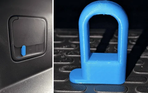

If you have a 3D printer. Someone made a solution
Thanks. I printed it in nylon to be a bit more weather-proof and durable. Not sure if I will use that as a permanent solution, since if you use both ends of the gear guard it won't work. But for now it's good.

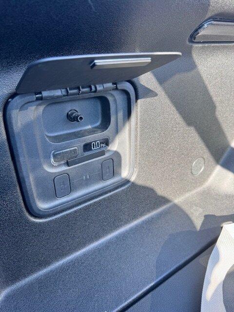

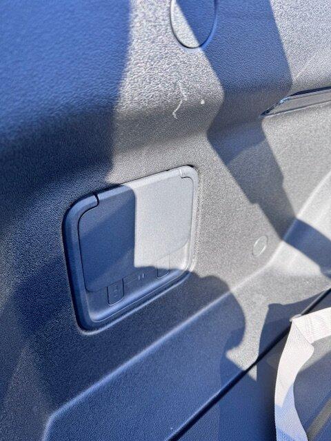

Rivian R1T R1S Compressor cover doesn't latch? image
Get these magnets at Home Depot along with a bottle of super glue.
Rough up one side of a magnet and its mating surface on the back of the cover. Stick the slick side of the magnet onto the air spigot and put a drop of super glue on the rough side. Immediately close the lid and apply pressure in the center over the magnet for about a minute. Problem solved.
