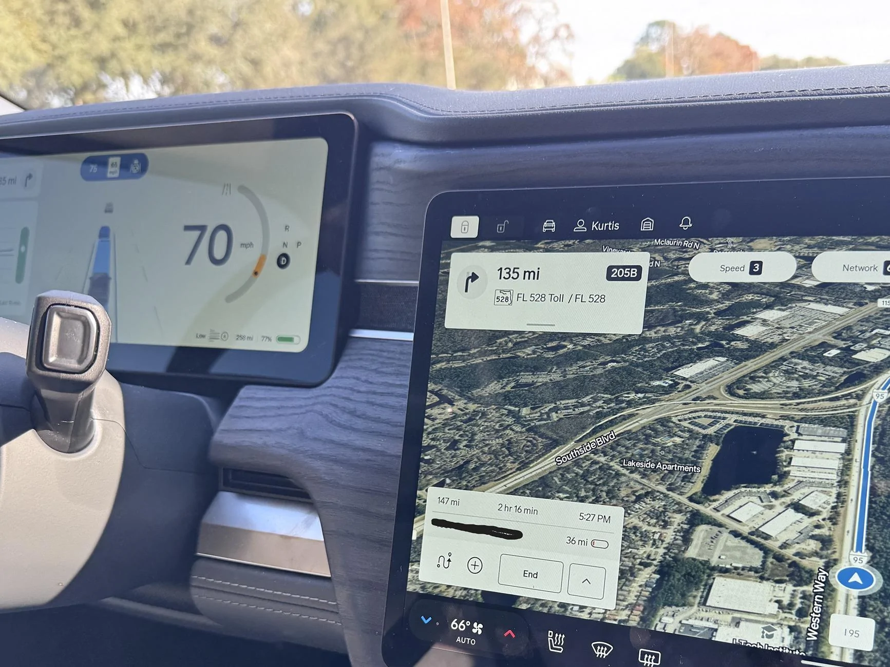

I must be missing something. The driver's display has an estimated range. The navigation has the total miles remaining as well as the estimated charge state at arrival. They don't match though. I even tried factoring in the desired minimum charge at arrival and couldn't get the numbers to match. Am I missing something? When they don't match, should I take the range estimate in the driver's display as the gospel? (The driver's display below says 258 miles @ 77%)

Opposite, I think you take the nav planner as more accurate. The reason is the driver display is just an estimate based on your charge and recent driving characteristics, but it doesn't know what you'll do next.
The range estimate in the navigation accounts for the distance, speed, elevation, battery conditioning (if needed), eventually maybe weather/wind/etc.).

Use the navs. The one on the driver's display is very optimistic, whereas the nav one uses your battery percentage and your current consumption rate to calculate it mathematically.

Navigation uses historical data, so it's closer to reality (but the range remaining at arrival is still the "false" number based on EPA that the driver's display shows).
The important part is to keep the number in the nav positive.

Logically I understand the difference, but I feel that when you have a destination set in the nav, then the estimated range on the driver's display should equal the distance to destination plus the estimated miles remaining once you get there.
Without a destination, the estimate on the driver's display can be calculated as it is.

The driver's display is not a "range estimate". It's a fuel gauge. I shows you how full your battery is. That's all.
You can change your settings to show % of battery instead of "miles" on the driver's display. IMO % should be the default because too many people jump to conclusions about what this number means.

The driver's display is useless and displays the EPA rated distance, I wish Rivian would make it match the navigation, but I"m thinking that may be a law or something
The navigation takes into account the temp of the motors, battery, wind speed, elevation gain and fleet feedback (other cars that have made similar drives and what their efficiency ended up being) which helps the navigation be extremely accurate (or at least a ton more accurate than the driver's display
I had made a post on facebook how my last trip Austin to Dallas that I've made 20 times, the estimated range was 60 miles less than usual, the feedback I got is what I used to make my comment above so that was helpful, and when I got near my destination I had less range than predicted by about 20 miles (was supposed to arrive with 30 would have arrived with 10 miles and that means 2022 quad motor from fully charged got 229 miles range. And the reason............crazy crazy wind, absolutely crushed my efficiency I was often sitting 1.3-1.4mi/kw on the 15 min range.

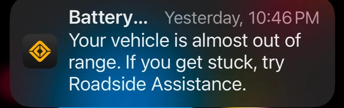

Highly dependent on weather, elevation, etc. Usually the nav arrival number is extra conservative, but not this past sunday for me in 10 degree weather going uphill when i was eating 4 battery miles for every mile of distance. Least to say this was my first time running out of energy. Ended up pulling over before i fully bricked the truck and AAA towed me the last 10 miles to the rivian charger. It was a good lesson to buffer at least double the range in those conditions.

As others have said, the one in the driver's display is simply a number based on the percentage and the EPA rating. The nav number takes into account speed limits, elevation changes etc. along the specific route you have chosen so it's more accurate (it knows what stretches you are likely to to better/worse than EPA for and adjusts the prediction accordingly).
The number in the driver's display is essentially useless -- use the number quoted by the nav.

I mostly agree with everyone…. But I find the Rivian NAV estimated range on arrival to be conservative. Iā€˜ve taken several long road trips and would set a route, and Nav would say i wouldn't make it or would be negative on arrival. I’d override and find that after driving to my next destination/charger, I would inevitably end up at my destination with plenty of range left over (often matching what the drivers display originally said as available).
I usually plot my route in 3 different ways (ABRP, Rivian NAV, and Apple Maps) to get a feel for what things might be like, especially since Rivian NAV tends to re-route me mid drive after I’ve started off with one plan. I’ll often have to stop the Rivian NAV and re-plot it back to the charger I originally intended so that it pre-conditions properly.

Same here. I find that using the driver's display and doing math gets me a more accurate result than the nav's estimate. I routinely do a ~200 mile round trip (including 4 days sitting in the cold), and the nav often estimates that I'll get home with less than 10 miles. I generally return with ~30 miles which closely matches my calculations. I've also done 3 road trips of 1000-2000 miles and had the same result: I always got to my destination/chargers with a range similar to what I calculated using the driver display (i.e. more than what the nav predicted). The nav also tends to re-evaluate so that by the time I get to said destination, it matches my calculations.
