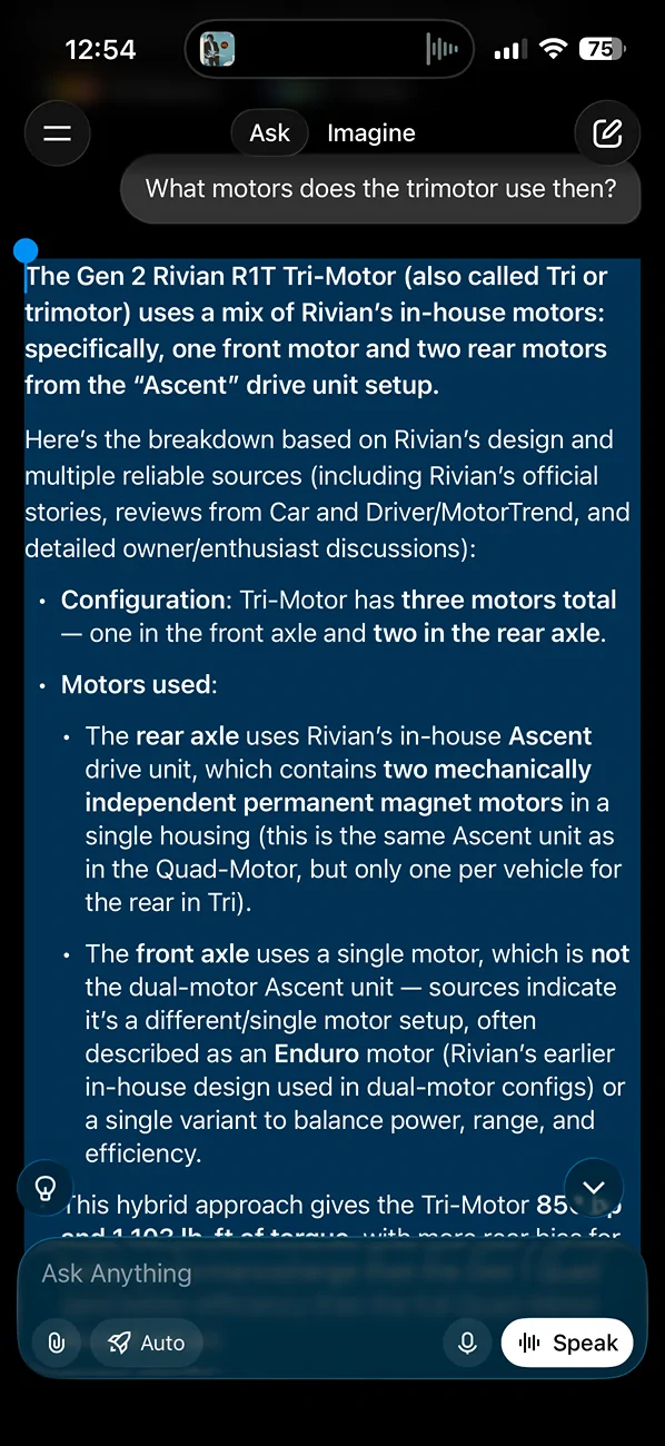

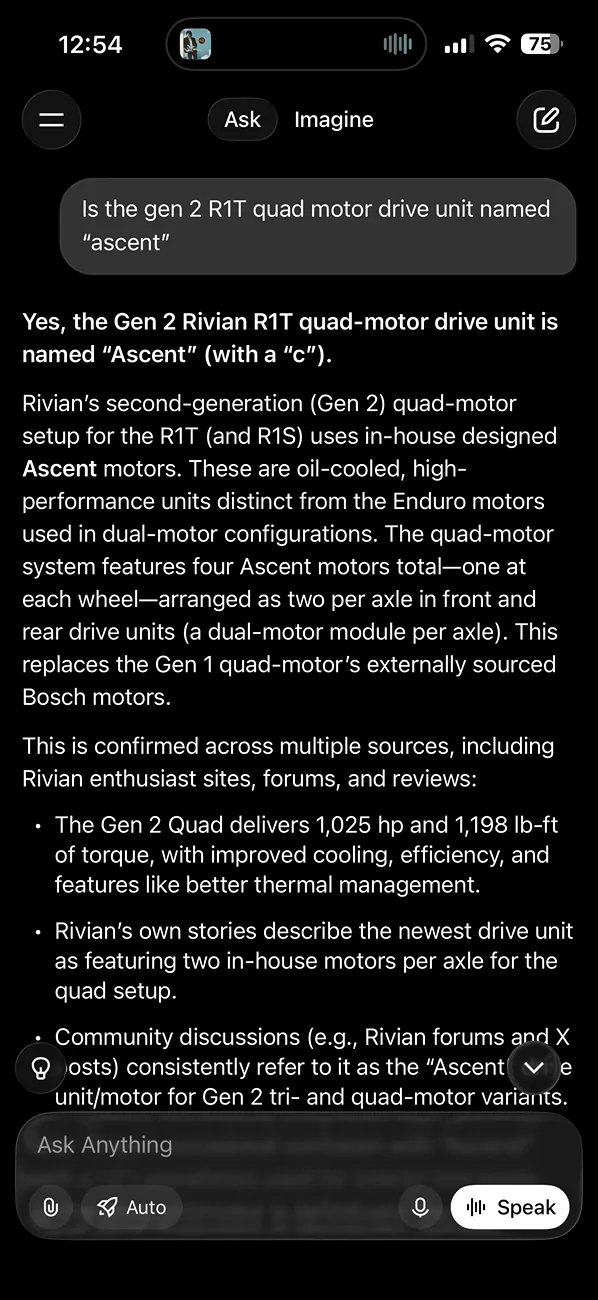

And if there is confusion it’s bc of this crap.

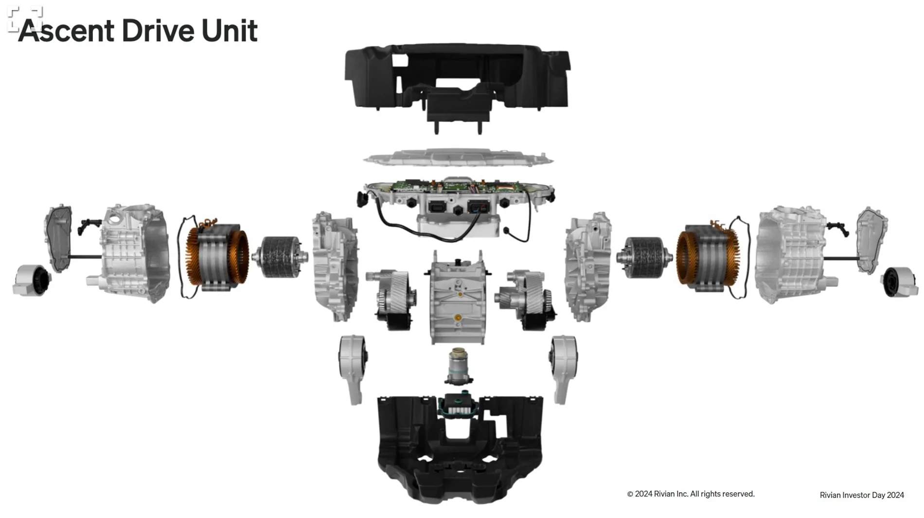

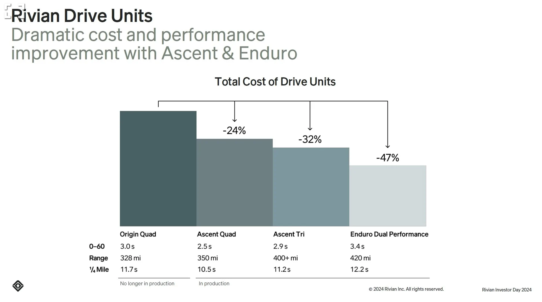

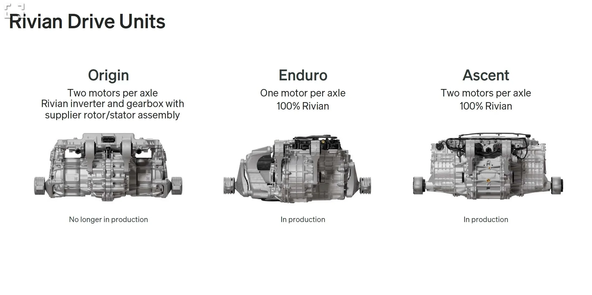

That said, I did my own research and got the information from the Investor Day 2024 Investor Day | Rivian , straight from RJ. I'm not to big of a man to admit I was wrong. I was conflating 'drive unit' with 'motor', and got a bit confused, but it seems like you did the same.
The 'Origin' drive unit is dual-motor per axle drive unit using Bosh motors and in-house electronics
The 'Enduro' drive unit is a single-motor per axle drive unit built 100% in-house.
The 'Ascent' drive unit is a dual-motor per axle drive unit built 100% in-house.

There are Ascent motors, the question really is if it's just a pair of Enduro motors in a single housing and branded Ascent, or a completely different setup. Video starts at the drivetrain breakdown.
Gen 1 Quad - 4 Bosch Motors
Dual Motor - 2 Enduro motors
Tri Motor - 1 Enduro in the front, 2 Ascent Motors in a single housing in the rear
Quad Motor Gen 2 - 2 Ascent Motors front, 2 Ascent Motors rear.
R2 - Maximus Drive unit. Unconfirmed how Tri motor variant (if any) will be configured.
I've only ever seen tear downs of the orginal Bosch and Eduro motors, but am curious how Rivian implemented it's clutch disconnect strategy in the Ascent motors. I assume it would be the same as the Enduro.
Edit. Photos from Rivian during Investor Day
https://www.autoevolution.com/news/...the-refreshed-r1-ascent-quad-evs-236145.html#

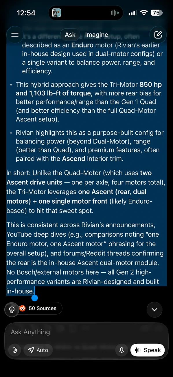

Edit: see that you are excited about getting a Quad - thats awesome dude, but reading marketing(alone) and asking grok will not get you to the facts @Space Cowboy .

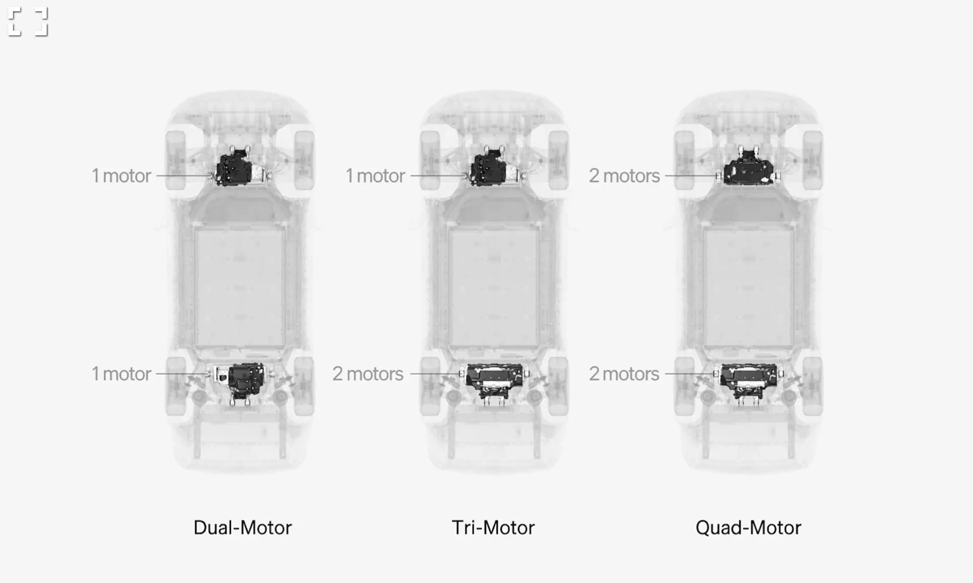

As pictured above Enduro is their single motor DU & Ascent is their dual motor drive unit. The big win over the Bosch units IMO was oil cooling with the in-house motors. The in-house motors have a more refined driving experience IMO. I love the sounds that come from the Bosch units though.
Important distinction is we are talking about "drive units" and not "motors" which I think is where some of the confusion comes in. The tri and quad are both amazing vehicles (have driven them both) and we currently own a Tri R1S.
Rivian has some great engineers on its team and it shows in how these things perform.
