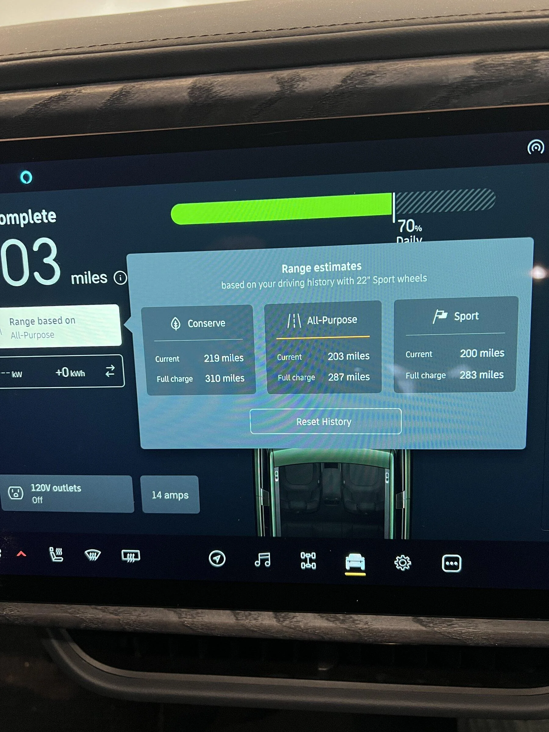

Here's for the 21s. Thanks to reddit user alexmaknet.
@OutofSpecKyle think you could pull 325 miles out of the aero tires? I wonder if the max pack will be the second EV to pass the 400 mile mark in the InsideEVS 70mph range test if done on 21s...

It's plausible. Using the 125 kWh Kyle saw you get 92.5% of the claimed gross pack size as usable, so the 180 kWh pack should be around 166.5 kWh usable. 325 miles on the 21s in Conserve as an estimate, where it was pretty damn close for the 20s, would get you 2.6 mi/kWh vs the 2.3 mi/kWh and change with the 20s. Apply that to the max pack and you get in the vicinity of 433 miles...but I'd also assume a little less efficiency with the larger pack on weight, but at highway speeds that should be minimal. Should also put the 20s on the max pack close to 380 miles.
