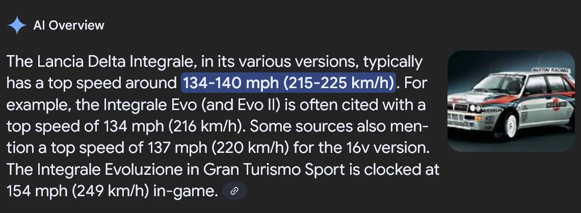

I mean, if they are using the Lancia as inspiration, then give it an inspired higher speed
Maybe an extra special trim level "Rally" or something like the "Dune" R1s that software unlocks higher speeds only in Rally or Sport mode?
Gen 2 QM R1 capped at 130 isn't it? And if not for that it would have beaten the Lucid in Hagerty's 1/4 drag race.
