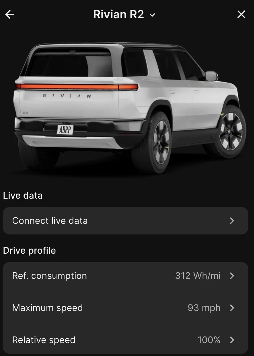

For a Performance R2 w/21" Pirellis, ABRP shows reference consumption of 312 Wh/mile or 3.2 miles/kWh.
I looked at a route in ABRP from Seattle to N San Diego taking I5. That route should average ~65-75 mph but without as much elevation change as LAX to JFK. ABRP's routing covered 1,267 miles and used 378 kWh, so averaging 3.35 miles/kWh. That seems optimistic to me for highway driving, but we don't yet have our R2. I'd be thrilled with that.
