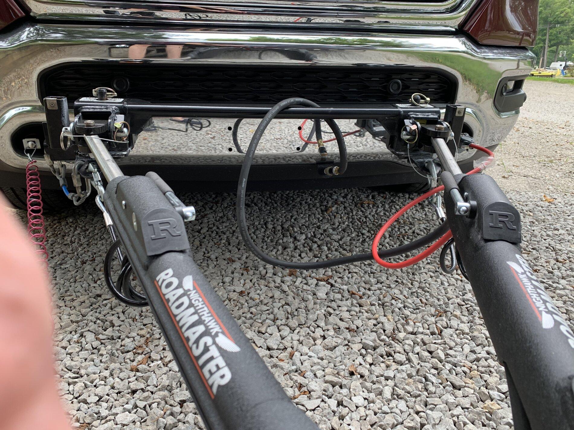

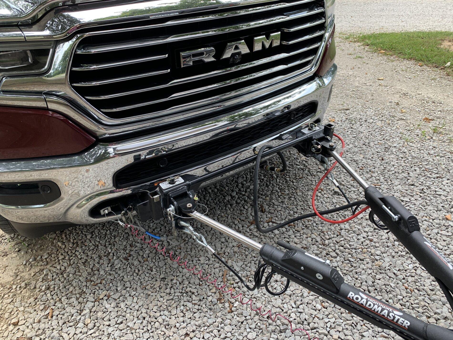

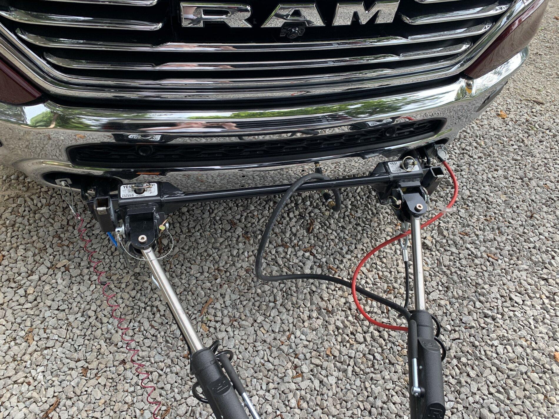

Ayuh. I’ve been using this system for years and have been very satisfied, especially when Spartan added it to their chassis. It also provides the required breakaway system as well as an optional wireless receiver to let me know that the TOAD breaks are actually being applied. I’m hopeful that the R1T provides mounting points that don‘t require cutting frame members or body to attach. It would also be nice for the air, breakaway switch, and electrical connection to be hidden nicely when not used. The AFO connects to to my vaccum brake boost line to reduce the braking forces required.

Most likely they’re working with other manufacturers to realize interoperability between the two vehicles. Including diesel and hydraulic brake systems. I’m waiting to replace my red RAM Longhorn with a red (hopefully) R1T!
