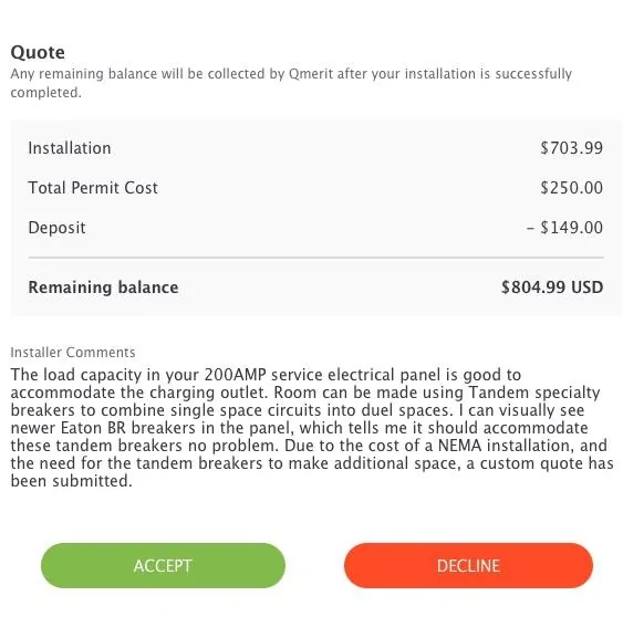

Within a day of paying the $149 deposit, I was contacted by a local company that looked at the photos I took and updated the quote... including a $250 permit cost (ouch... but not their fault). We'll see, but it looks like this company has good reviews...
In parallel, inquiring with the Guides about when I might actually be able to get a hold of the Rivian wall charger for the electrician to install. Seems like I should have it in hand prior to bringing out an electrician?
Uhh, the $250 is their fault if you're in Kenmore (or most places in WA, but excluding several cities including Seattle proper). WA L&I (which should be the local authority for electrical) charges $65.50 total for up to 4 new circuits on one permit, then $6.90 for each one thereafter.
Thanks -- I'll be sure to get more specific with them as I get closer to install. Having recently purchased another car from a dealer where they overcharged on the licensing fee to cover the 'potential' fee, I wondered if this might be the same sort of scenario... where they cite one charge, but then it actually costs something less and I end up paying less. Or, are they inflating the cost to cover their @$$es for the inspector call backs?
Edit: Actually, I think their quote is close to being in the ballpark. The $65.50 is for a detached garage, but reading the LNI guidelines - the cost is $99.60 for a non-detached garage / dwelling up to 1300 square feet + $31.80 for each additional 500 square feet. (our house is about 2500 square feet). Why the square footage of our house matters is beyond me...
If the building is already wired, it doesn't. The document has all the new construction / new service pricing in it too. Look for the section "(d) Single or multifamily residential circuits only (no service inspection)."

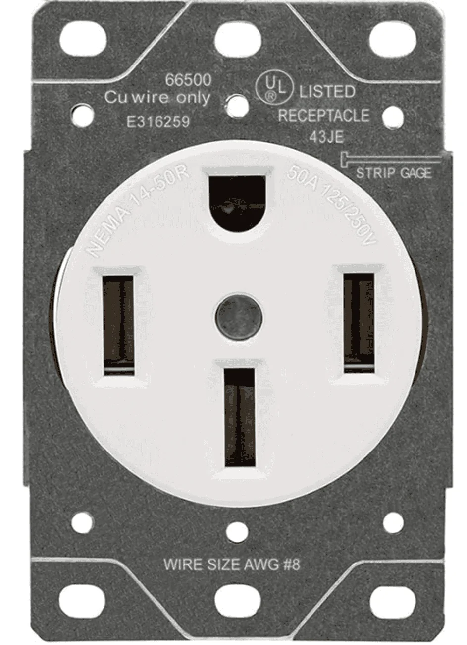

I have zero electrical experience, but I was smart enough (I think) to have a 240v outlet installed on our new home in anticipation of an EV. I'm guessing it will be a fairly easy setup for me when I need to install the wall charger? Maybe not as simple as 'plug-n-play', but maybe not much more than that?
Thoughts?

If it is a 14-50 (most likely), you should be good to go.
If you have the above, you would be able to use the included charge cord and get ~16 miles per hour of charging.
If you have the above and wanted to purchase a wall mounted EVSE, you would need to know the breaker size (40A or 50A) to know what unit to purchase (32A or 40A).
Awesome. I'll have to take a look when I get home today.
Thanks!
