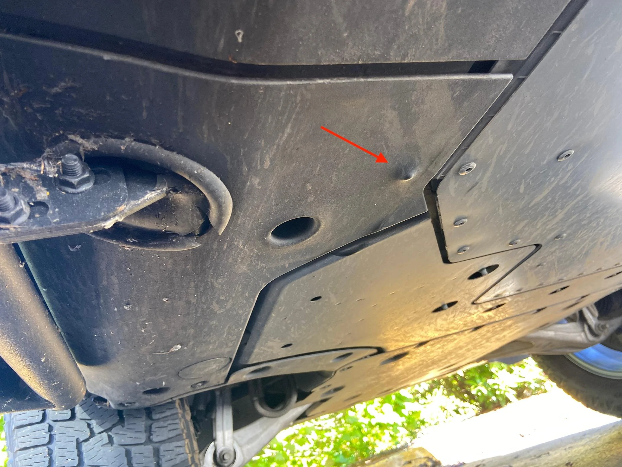

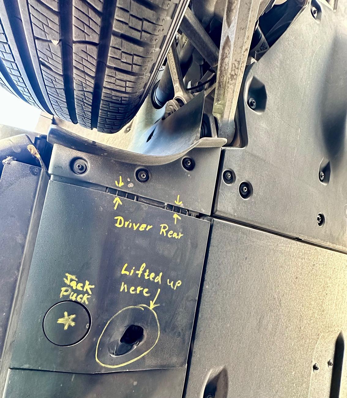

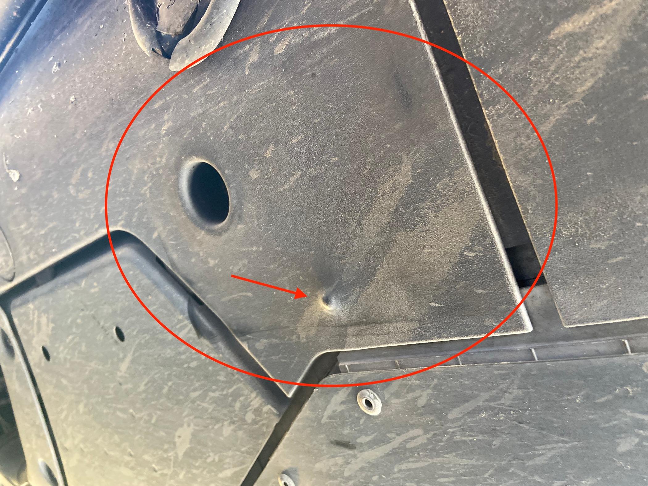

I saw one of my thread and images in this thread, I had damage to underbody from discount Tire.
I do have to clarify though, Discount Tire did create a claim and covered the cost of damaged replacement underbody panels. It wasn’t the smoothest process and had to call multiple times, spend few hours on phone but they did come through to taking ownership. Also had to have Rivian SC appointment for them to inspect that it did not create additional damage internally.
100% agree and would recommend anyone using them to Follow the advise shared here in thread to minimize such headaches.
Marking the caps with stickers or even unattaching them (let it hang) before drop off may be a good idea so they cannot miss it and lift from correct spots.
Having said all that we will still be using Discount tire for rotations and have their road hazard warranty - cannot beat the price and convenience.

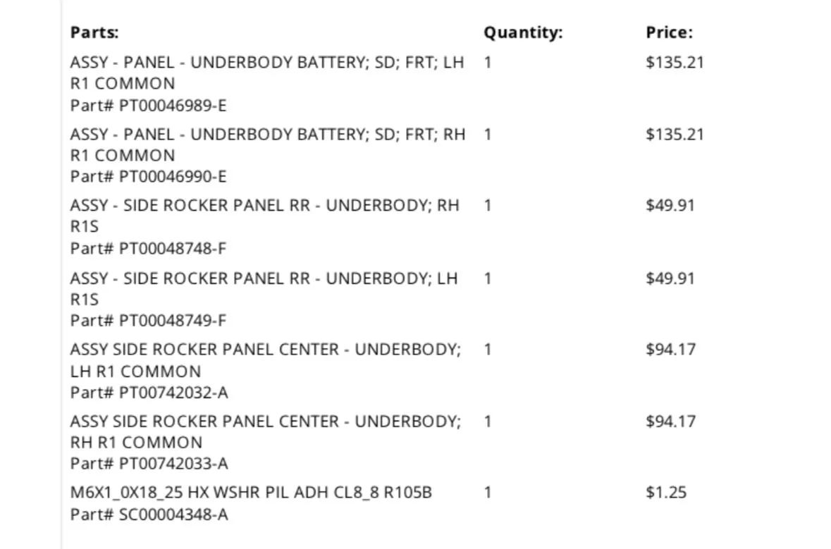

How much was the replacement cost for the panel? They damaged mine a few months back but I just told them to give me a discount on new tires when I’m ready since they are almost due. I think they offered me like a 12% discount on some new Wildpeak AT4’s
All underbody panels were quoted at ~$560+tax. Attached is the quote for all but I only needed to replace two. One damaged and one adjacent one which was bent and uneven.

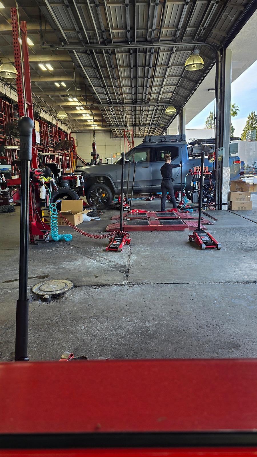

Sorry to hear the horror stories here. I had my tires mounted on my new Atomic Wheels and they used pucks appropriate for my truck. They did a great job mounting and balancing my new wheels. Only minor issue I had was they could have put the plugs for the pucks back a bit better.
One came out and was dangling and another wasn't fully inserted. In their defense, the one that came out, I had a hard time getting it situated just right so it didn't do that to me. Everything else was done well and with care..
