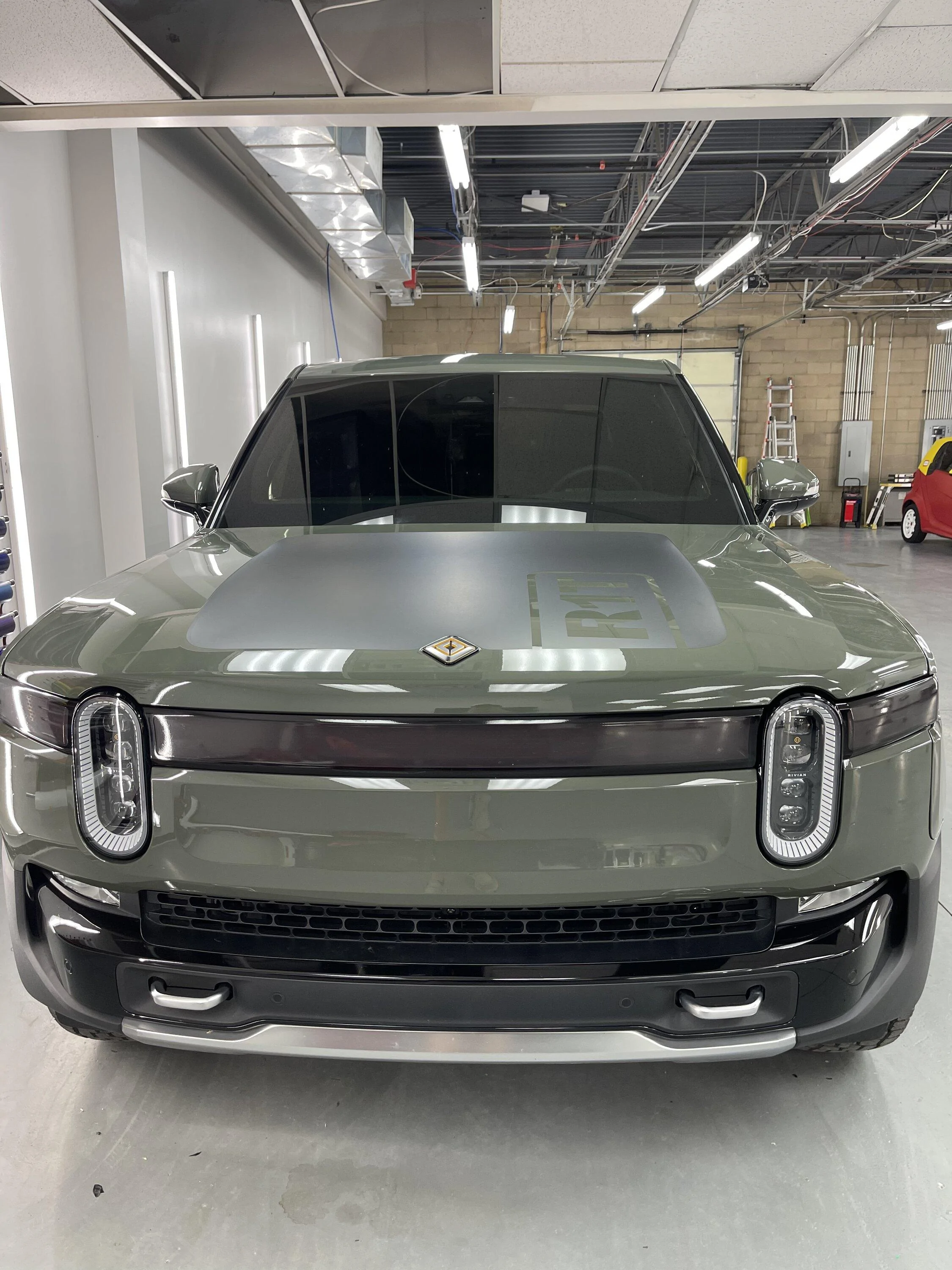

The first thing I did was the window tint as I found the amount of sun and heat in the cab to need that protection. I have gone back and forth on PPF and mostly over the years, against doing it but based on the flat front of the R1T ended up having just the nose and a few key areas that would be rock magnets, covered. Probably $2k between the two services.
Rivian R1T R1S PPF Affordable DIY from TWRAPS 7397E32A-1BF9-4480-9FCC-BF6F12BDD8A7

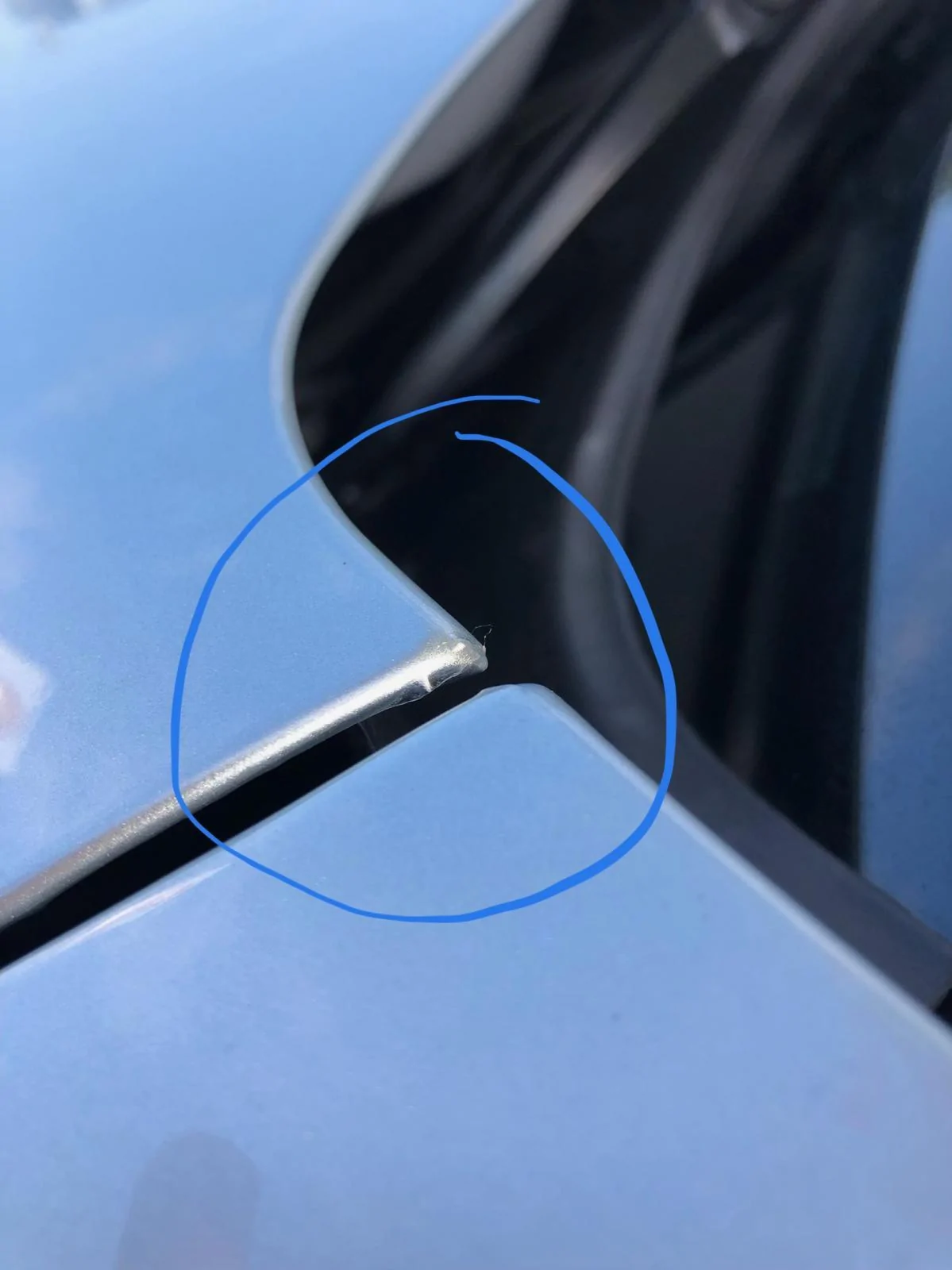

A good installer will not use precut pieces, or if they are precut they are precut to the general shape and much larger so they still have to cut to size and wrap around the edges. You should never actually see PPF on the car once it is installed unless you are looking at a corner closely. Even then, a good installer will hide it very well.
Here's a random example of a good install.

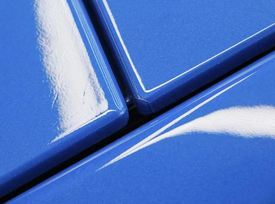

Here's a bad one.
This is pre-cut where you see the lines and it doesn't wrap around. If this is okay to you, that's perfectly fine. It still protects the car, but some folks who are anal about their cars, will not accept something like this and are willing to pay a little more.
If the car isn't consistently clean, dirt/dust will gather along the edge and you'll see the edge. You have to spend more time cleaning it.
