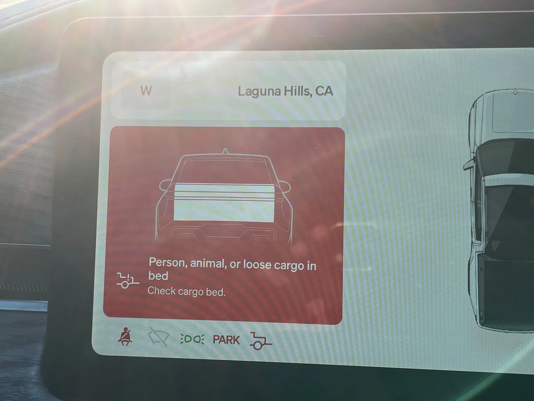

I guess this is my first actual failure since July ‘23 delivery. Since new the tailgate has misbehaved a few times, but it has always “fixed” itself with a squirt of lube on the latches. Not this time. Yesterday and most of today I was able to drive with only a malfunction warning in the mobile app. Now, it’s full-on unhappy. Loose objects/animal warning in driver display, as shown, along with continuous audio warning, until shut off/lock. Tailgate is up and stays up, though passenger side has visibly more give when I push on that end. Miraculously, I was able to secure appointment at Lake Forest SC this Friday. Think it will be same day repair?

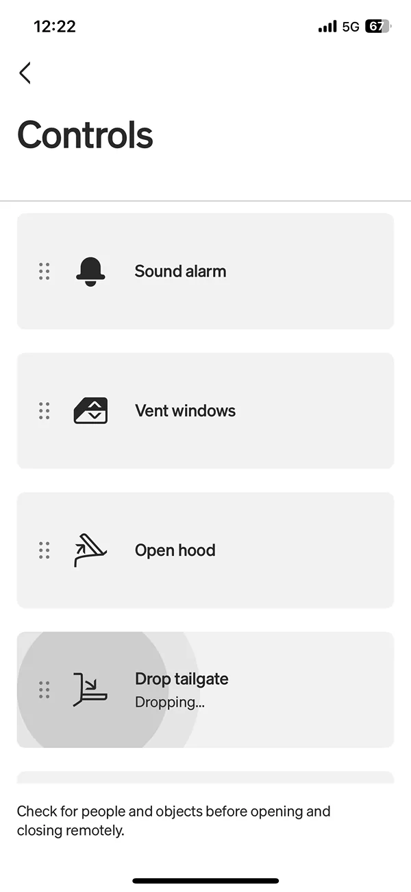

PS— mobile app shows tailgate dropping perpetually.

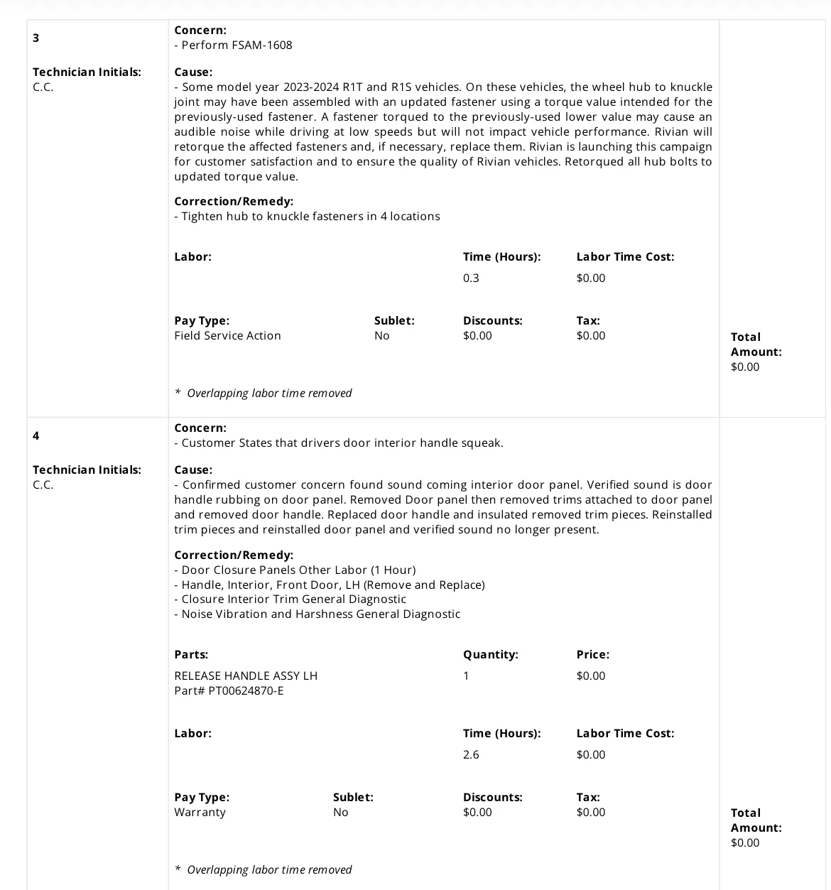

One interesting thing... They said my T was flagged to have hub bolts re-torqued. I informed them it was done this past January. After some research, they said the torque spec has changed again since. If you've had this service bulletin done in the past, you might want to check in with your SC.

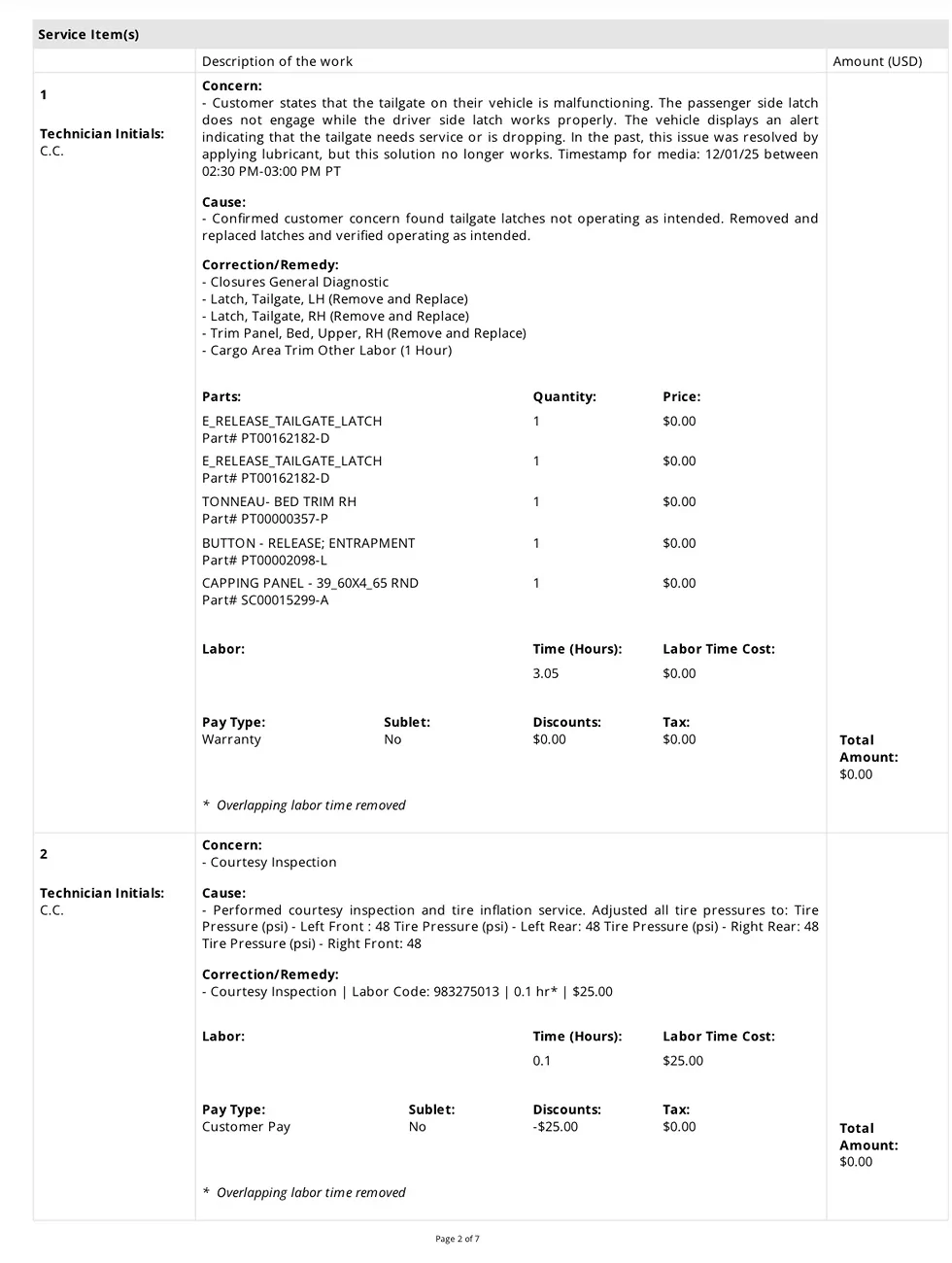

Update today from SC:
“tech discovered tailgate is not receiving proper voltage, will resolve and replace both latches (as preventative measure).”

Just picked up. Another stellar experience at Lake Forest, CA SC.
Tailgate portion of invoice:
Rivian R1T R1S Possessed Tailgate, resolved with service details IMG_0919
They retighten hub bolts to new specs. I also had a squeaky driver door latch (interior), which I thought they’d just lube. But they replaced the whole assembly.
Rivian R1T R1S Possessed Tailgate, resolved with service details IMG_0920

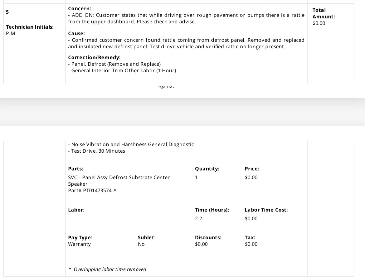

And, back in January they said dash rattle was not present, so they couldn’t do anything. At drop off Wednesday I casually mentioned it to staff, who is also a T owner, and she knew exactly what I was talking about. It got fixed! 🙌🏼
Rivian R1T R1S Possessed Tailgate, resolved with service details IMG_0921
