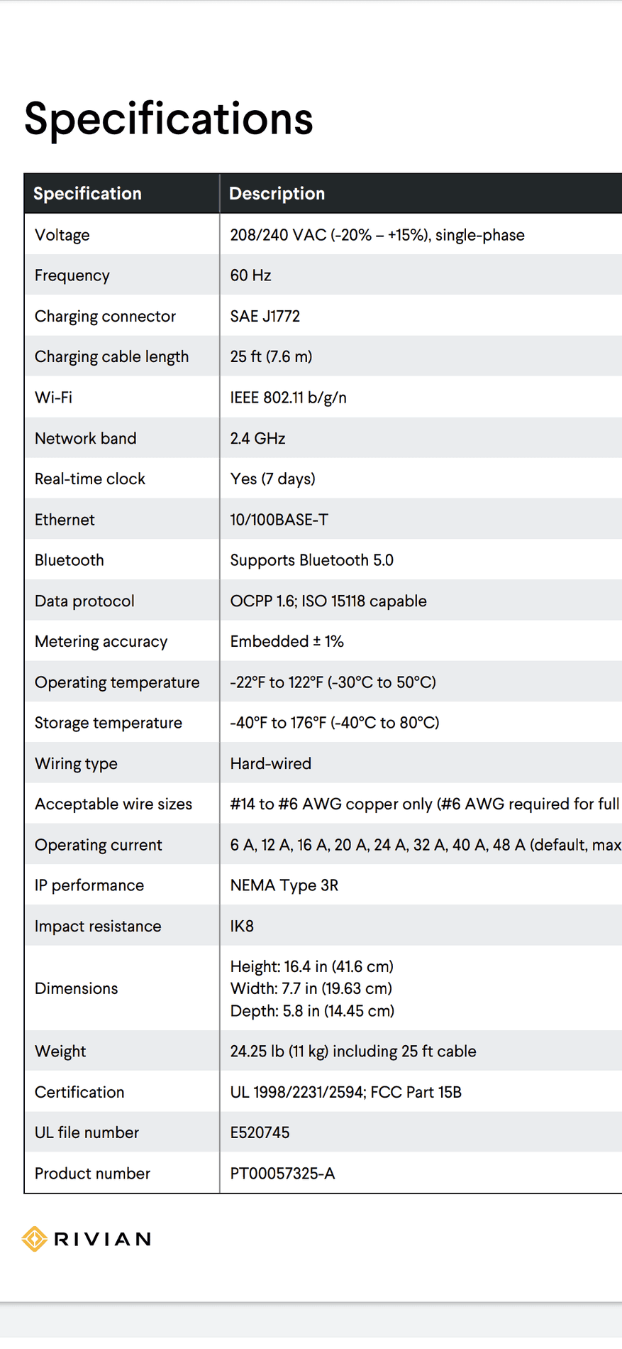

I am going with the higher capacity wire. No need to stress the wiring.
Rivianā€™s installation guide says only up to 6AWG wire is accepted so Iā€™m willing to bet 4AWG either wonā€™t fit or wonā€™t be able to be torqued properly.

WiFi is 2.4ghz. I really don't need another 2.4 ghz device in my house, ugh. I'll run Ethernet to it, it will be near a switch thank goodness.
Rivian R1T R1S Official Rivian Wall Charger installation guide Screenshot_20210918-092012
