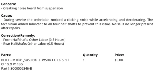

Truck was at the ATL SC for some door alignments last week and they added the following to the visit when they had it in the shop. Assuming this is the same, although they refer to suspension noise but then perform half shaft labor....and consume (1) bolt :-?
Rivian R1T R1S New Rivian customer satisfaction campaign -- halfshaft issue (on 2022 R1S and R1T) 1681484306992
