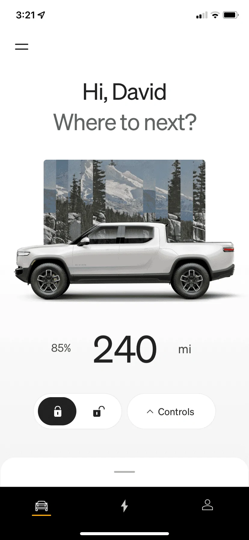

Just got back from a 16 day trip and logged 1.9% phantom battery drain per day.
Gear guard off, no plug in charge, no camp mode, indoor garage circa 55F temps, Software v 2022.47.0.
Left vehicle 85% SOC with 251 miles of range, returned to 59% SOC and 174 mile of range.

Parked truck outside for 14 days while on travel - temp in the low 50's most days.
Start - 85% SOC
End - 63 % SOC
Took 27kW to charge back to 85% - lost about 2kW pre day average.
Start - 85% SOC
End - 63 % SOC
Thanks for posting this information. This is really concerning. I was planning on having a Rivian here in Hawaii. I'm back and forth between Hawaii and the mainland often and have been leaving my current vehicle (an ICE Jeep Cherokee) at the airport between trips, which occur anywhere between 3 and 8 weeks.
With this level of vampire drain, leaving a Rivian at the airport for up 8 weeks/2 months sounds unnecessarily risky.
