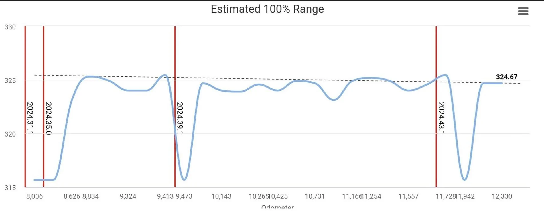

According to ElectraFi, BMS might have a brain-fart here and there but capacity it's still the same.
Rivian R1T R1S Miles at 70% charge  dropped with new update. battrang

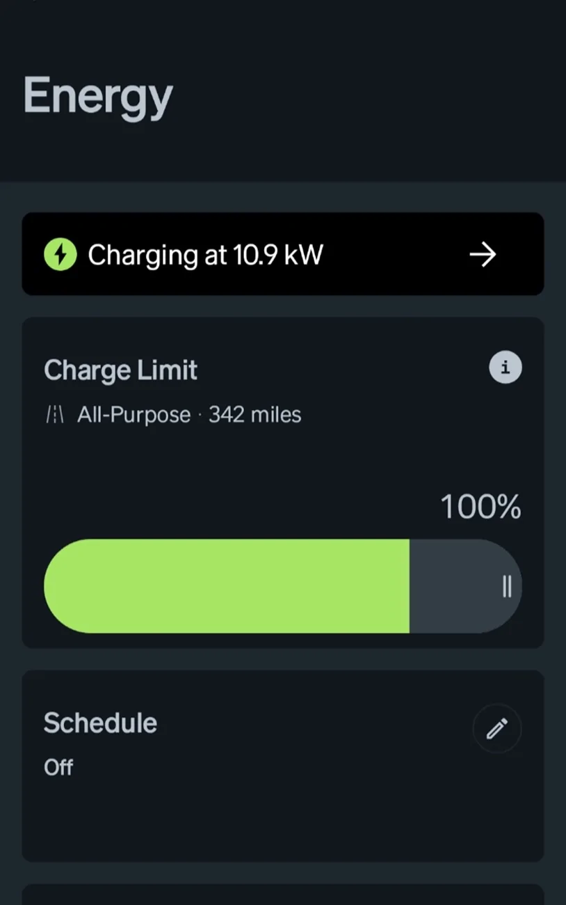

Same here
G² R1T³
Was 346 All Purpose
Now 342
IDK ?
Rivian R1T R1S Miles at 70% charge  dropped with new update. 1000035020

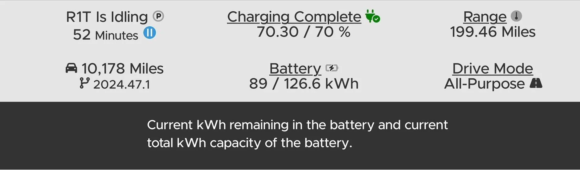

I’ve observed range loss as well. 2023 Quad Large used to report 204 miles of range at 70% and now reports 199 miles at 70% after the update.
Electrafi used to report a usable capacity of about 131 kWh and now reports 126.6 kWh.
Rivian R1T R1S Miles at 70% charge  dropped with new update. IMG_4192
I’ve done over 2,000 miles since the update across a wide SOC range with two charges to 100%. I would hope that’s enough for the BMS to calibrate, so it seems like something did reduce the usable capacity.
