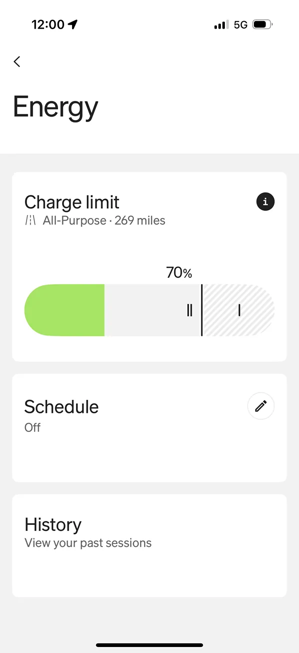

I used to get a consistent 269/270 miles when charged to 70%.
With new software update it now is reading 262 miles of range at 70%.
Am I missing something here?
Is there a reason this would happen?
btw, I have a 2025 R1T dual max

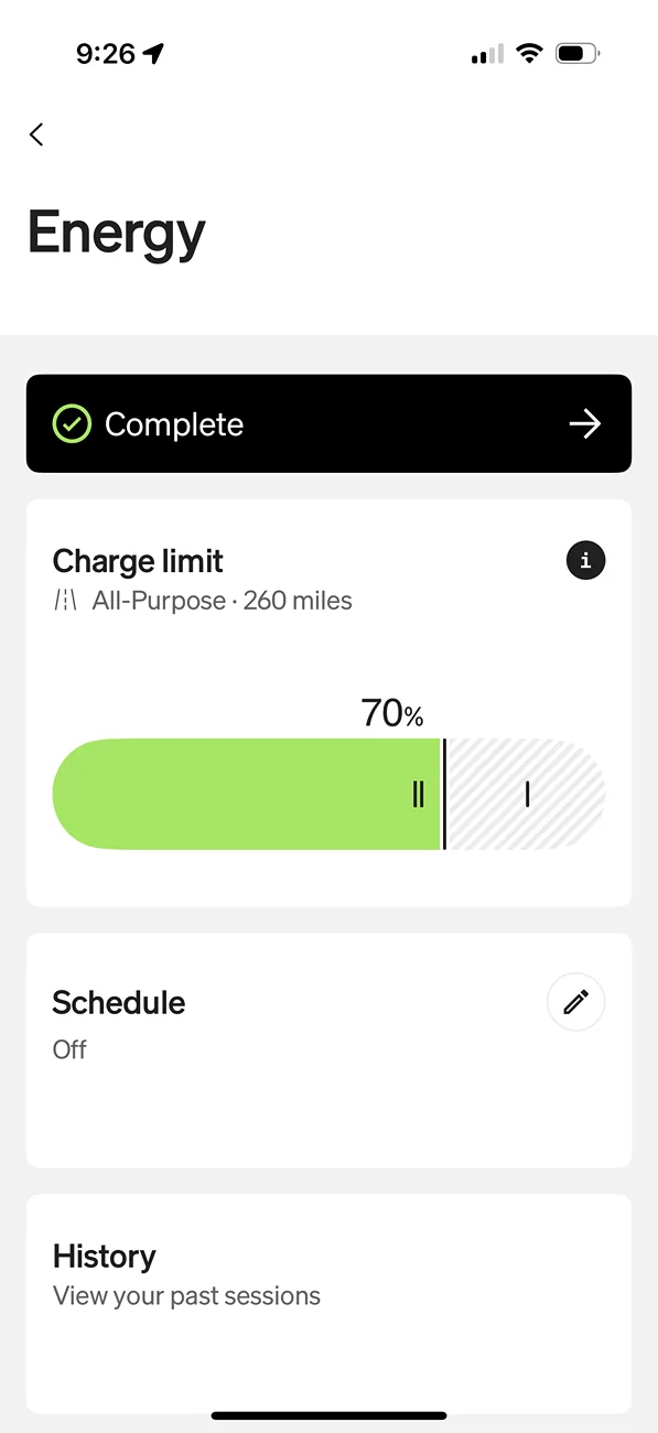

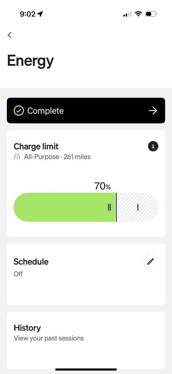

Update.
More range loss at 70%
now showing 260 miles at 70%
very strange.

Complete a few driving/charging cycles. I'm sure it'll go back to the usual numbers.
