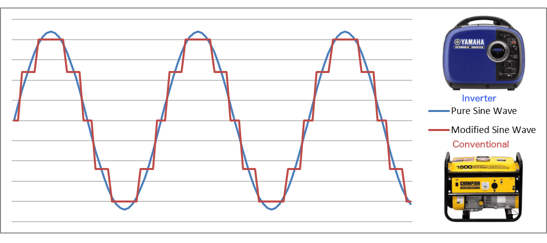

I see this one fairly often and frequently respond by asking "Where would I get a non sine wave generator?. They are rotating machines and their outputs are thus inherently sinusoidal. Note that I have never gotten an answer.
Inverter generators actually take the 3 phase AC, convert it to DC, then back to AC again.

Conventional generators are subject to power fluctuations with load and RPM changes inverter generators compensate for that and produce a steady power output. When converting the DC to AC, and inverter can be square wave, simulated sine/modified square wave or pure sine wave.

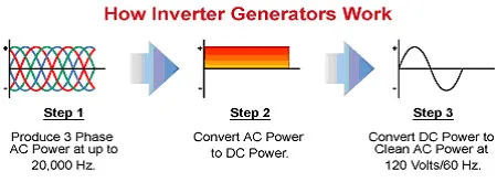

Inverter generators are used to deliver power at a steady rate with less fluctuation due to load.
They convert 3 phase AC to DC, then back to AC:

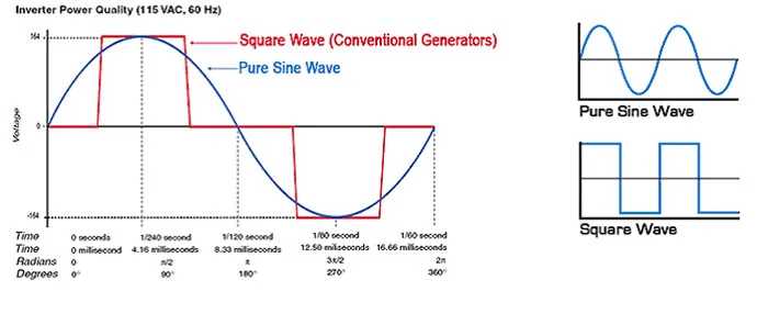

The DC to AC conversion can be done as square wave, modified square (simulated sine), or pure sine wave:
Rivian R1T R1S Lucid Motors SUV 1597442888945
Look for a Total Harmonic Distortion (TD) rating on your generator specs. Anything above about 5 or 6% is most likely producing a modified sine or square wave.
As I said I see this misconception repeated over and over in these forums. A generator produces an electric current by rotating a magnetic field past a coil of wire. Thus the waveform is inherently sinusoidal. But coil winding pitch and span and other things are important design parameters which are set, in a good design, to minimize the generation of harmonics which distort the waveform. Also the magnetic field is varied in strength to regulate the generator's voltage and of course modulating it will distort the waveform during modulation. Frequency is, of course, determined by engine speed and if a heavy load is switched on the generator will slow down and this phase (or frequency depending on how you like to look at it) modulates the sinewave. A good generator has total harmonic distortion (THD) less than 4%. As an example the 48 kW Kohler I use in my house backup system delivers 2.7% THD while charging the car with other household loads normal. For reference, the utility delivers 2.0% (see note below).
Now I see on the internet people posting that the typical generator one buys at big box stores have really terrible THD and I mean really terrible such as 23% (which is comparable to that of a modified sine wave inverter) but that's clearly typical internet disinfo. You'd really have to try hard to screw up a generator design to realize THD that high so I suppose that if one is contemplating charging from a portable generator he ought to consider THD. IOW get a good generator.
The trend today is towards the pure sinewave technology in which the generator engine spins an alternator whose output is rectified and the DC pulse width modulated to follow any waveform the designer likes which, in this application is, of course, a sine wave. There are several advantages to doing this (besides low THD and THD is a real issue in some applications - your car's charger is largely immune to it because it is a "switcher") such as the ability to synchronize several generators and relaxation of engine speed regulation requirements (many have an economizer mode that slows the engine when the electrical load is light). Pure sine techology costs a bit more ($2600 vs 3400 for 7 kW Honda portables).
The diagrams presented in the preceding two posts contain one glaring error and that is the label declaring that conventional generators produce square waves. That is absolutely incorrect. Conventional generators produce a sine wave with some nominal level of distortion depending on the design. Other than that the only thing that is somewhat misleading is the implication that the PWM repetition rate is about 540 Hz. It is, in fact, more likely to be 25 kHz or so such that the modulating waveform is followed much more closely than the picture suggests. I checked THD from a modified sine inverter this morning and found that THD was below the resolution of the meter (0.1%).
I suppose the summary of all this is that there are those that will try to convince you that a cheap generator contains a modified sine wave inverter. While I suppose it might be possible to design, manufacture and market such a thing I can't imagine anyone doing so and that is, presumably, why no one has been able to tell me where I can buy one.
