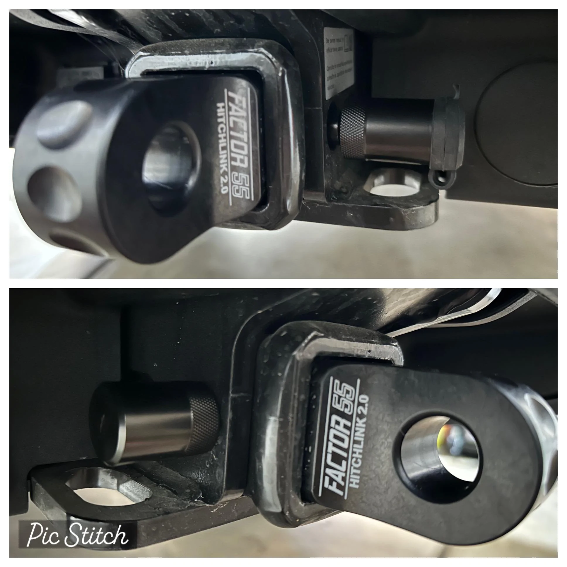

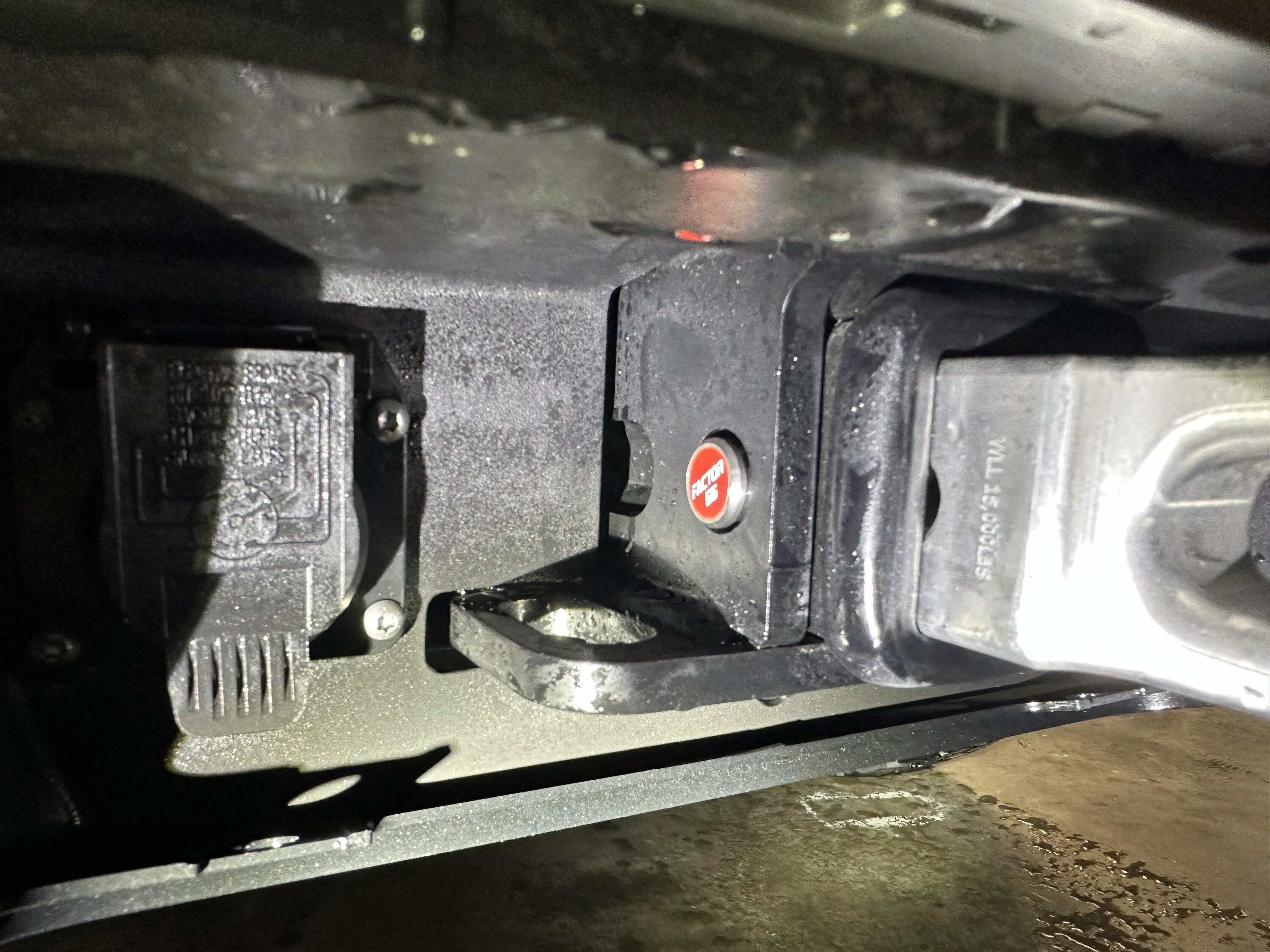

Factor 55 fits great and exudes quality. The side without the lock slides inside the outer surround of the Rivian hitch, helping a bit with clearance.

So, the true width is more than 3.125”. That does look nice. Thanks for confirming it works.

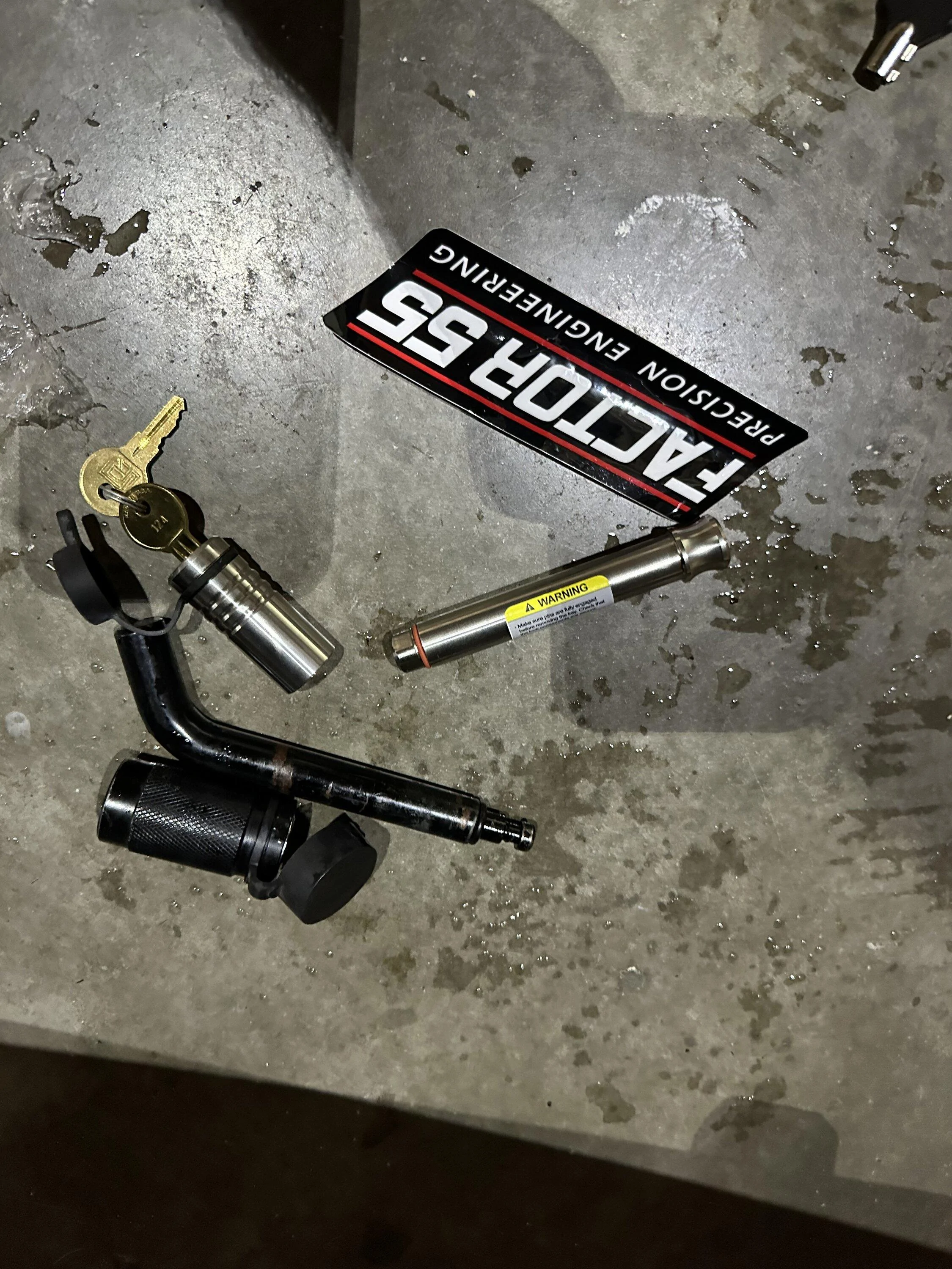

As my photos show, the Factor 55 pin is 12 cm (4.75 inches) long

The weird thing is that the spec states that one has a 3.125" span which should not fit the R1T as someone measured the necessary span at 3.41".
Oh wait, I see, the butt end of the pin is recessed into the outer receiver hole in your 2nd picture. The one with the factor55 logo on the butt end of the pin. Is that the design of this pin? Is it supposed to recess into the hitch receiver hole like that? Is that safe? That's likely why it works for you, otherwise the span is too narrow for the R1T if that end of the pin is supposed to be outside of the receiver wall.
