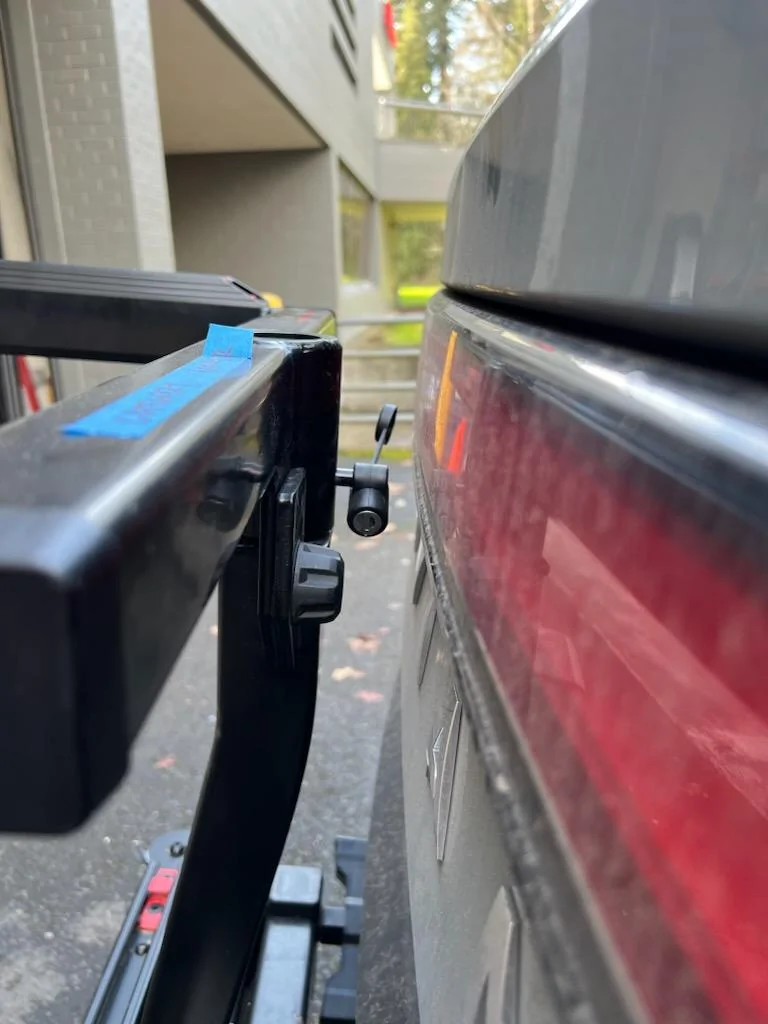

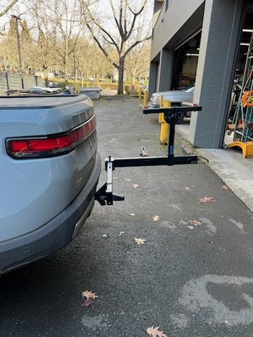

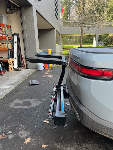

The Yakima Exo System would be a great option for the R1s. Though we haven't
completed any type of range estimate due to all of the variables that could alter your range estimates, but someone earlier in this thread stated that you wont have the same effect as loading a cargo box on the roof, cargo carries in the hitch will have less effect on your range. Attahced are some pictures showing the fit.

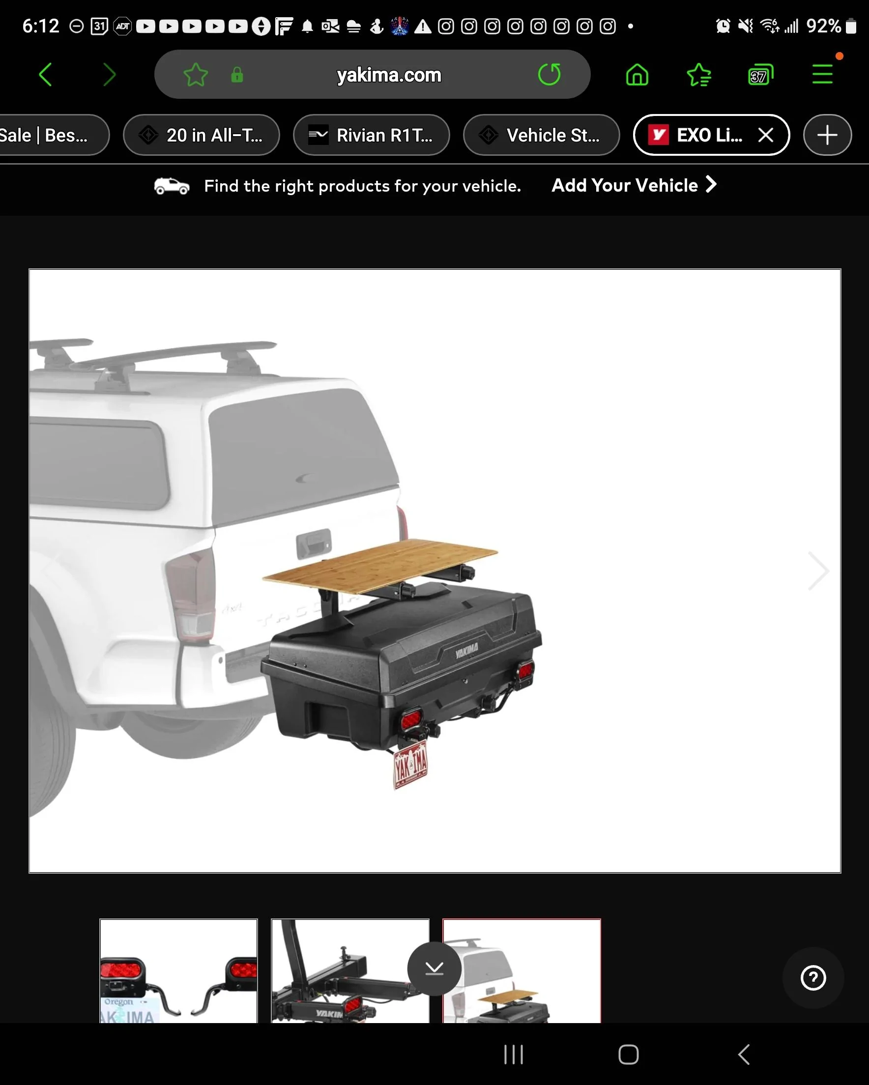

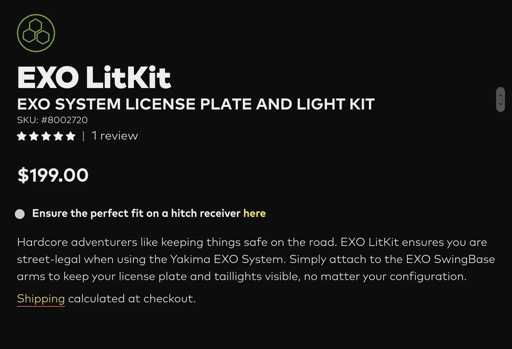

This is really useful. How much is the license plate obscured with the cargo box on?

Great question-use the Yakima Exo LitKit. See attached.
Rivian R1T R1S Hitch Mounted Cargo - Impacts? Screenshot_20230308_061413_Samsung Internet

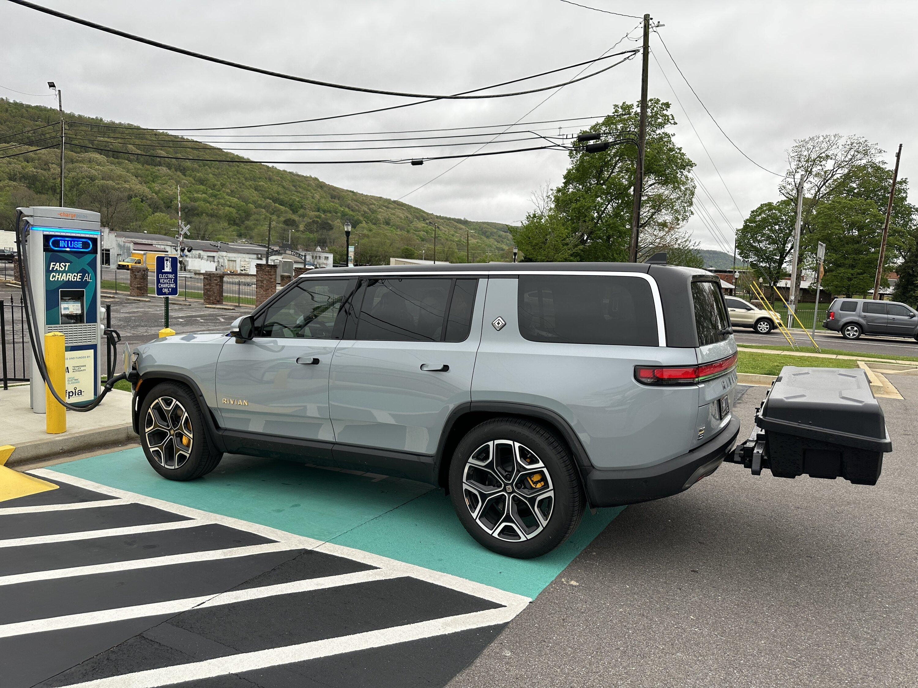

Just got back from our road trip from Wisconsin to Gulf Shores to Tampa and back. The Yakima EXO worked as expected, and we needed every square foot of extra space. Sure, it was just the four of us and our french bulldog, but the full-size spare ate up most of the rear space behind the third row. My son had the third row to himself, and my daughter had 60% of the middle. I put the 40% flat to accommodate a dog bed so Boden could be monitored by the second or third row.
Back to the EXO, no complaints at all. It did block my license plate and I didn’t want to lose Driver+ by plugging in the Yakima light and license kit. So I took my front plate and taped it to the rear-glass (inside). Over the 3300 miles I averaged 2.05 mi/kWh, which is better than I get daily driving. I only wish that Yakima had a spare tire attachment for the EXO kit. That would open up even more interior space!
