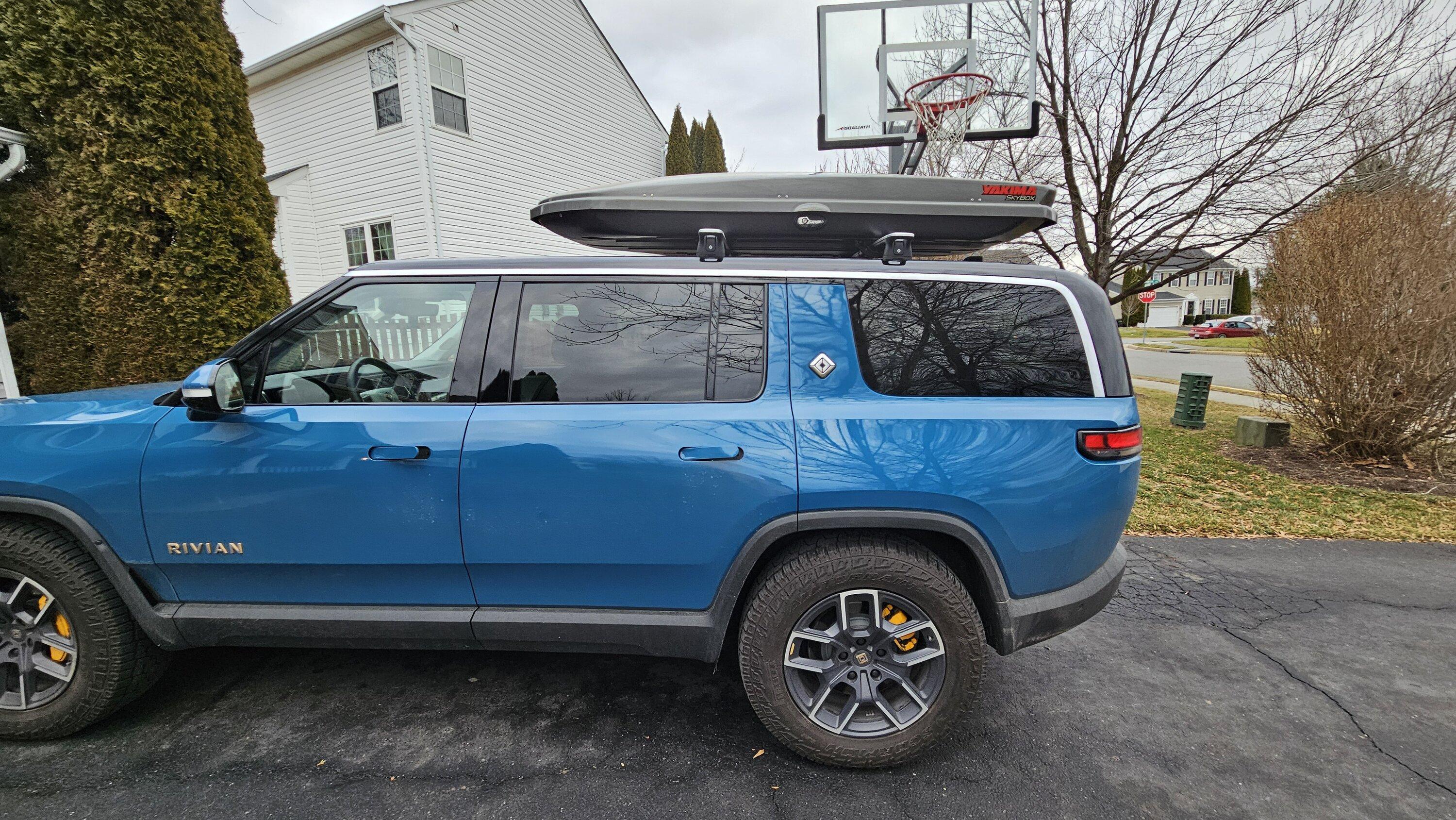

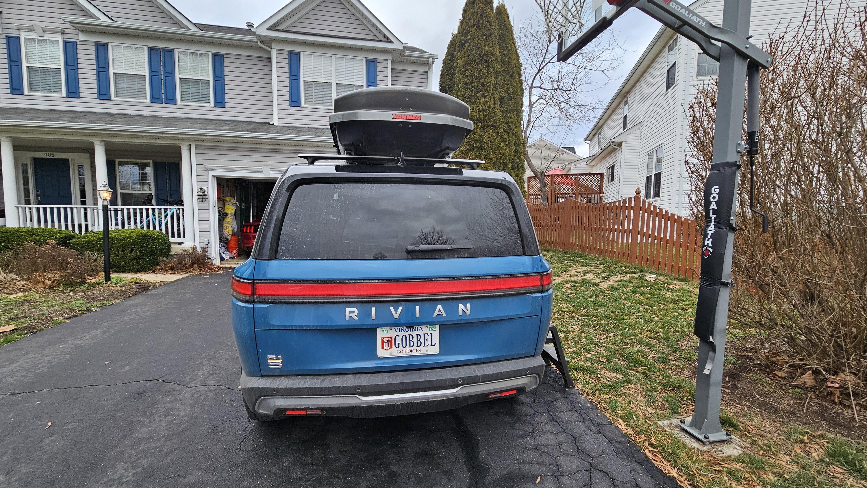

We got around to putting the cross bars on and adjusting our Yakima low pro 15 cargo box to them today in preparation for an upcoming ski trip and road trips this summer.
It went on without issue had plenty of adjustment for the claws to grab the bars. They don't close all the way as predicted but Yakima confirmed it's not an issue as long as they are tight.
I try to adjusting it forward so that the rear gate could open all the way and I would need about another inch of adjustment on the forward clause of the cargo box to do it. I didn't want to put the cargo box on the front to crossbar mounts, because I like it further back and more aerodynamic looking.

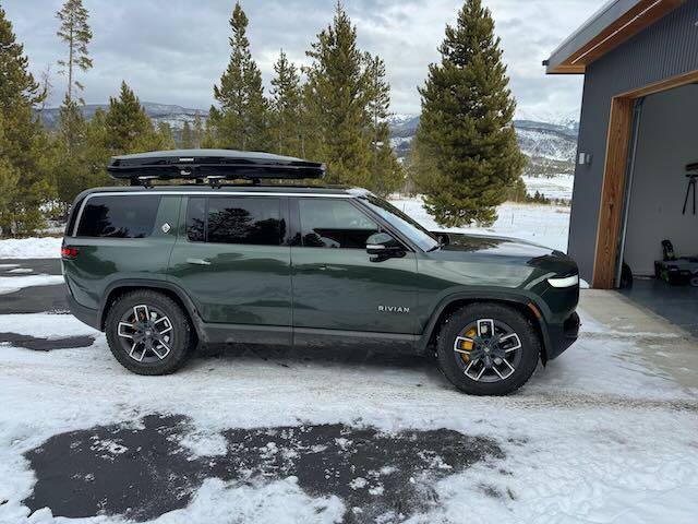

I got the Yakima Lo Profile Box and it works. I wish I could move it forward but the placement of the bars is not ideal. It does at least clear the back. I think the Inno would have been a better option for me but the one I wanted didn't seem long enough for the skis.
Rivian R1T R1S Yakima SkyBox LoPro 15 Cargo Box fits on R1S cross bars IMG_3737
I need low profile to get into my garage. I have to put the suspension to low then it clears.

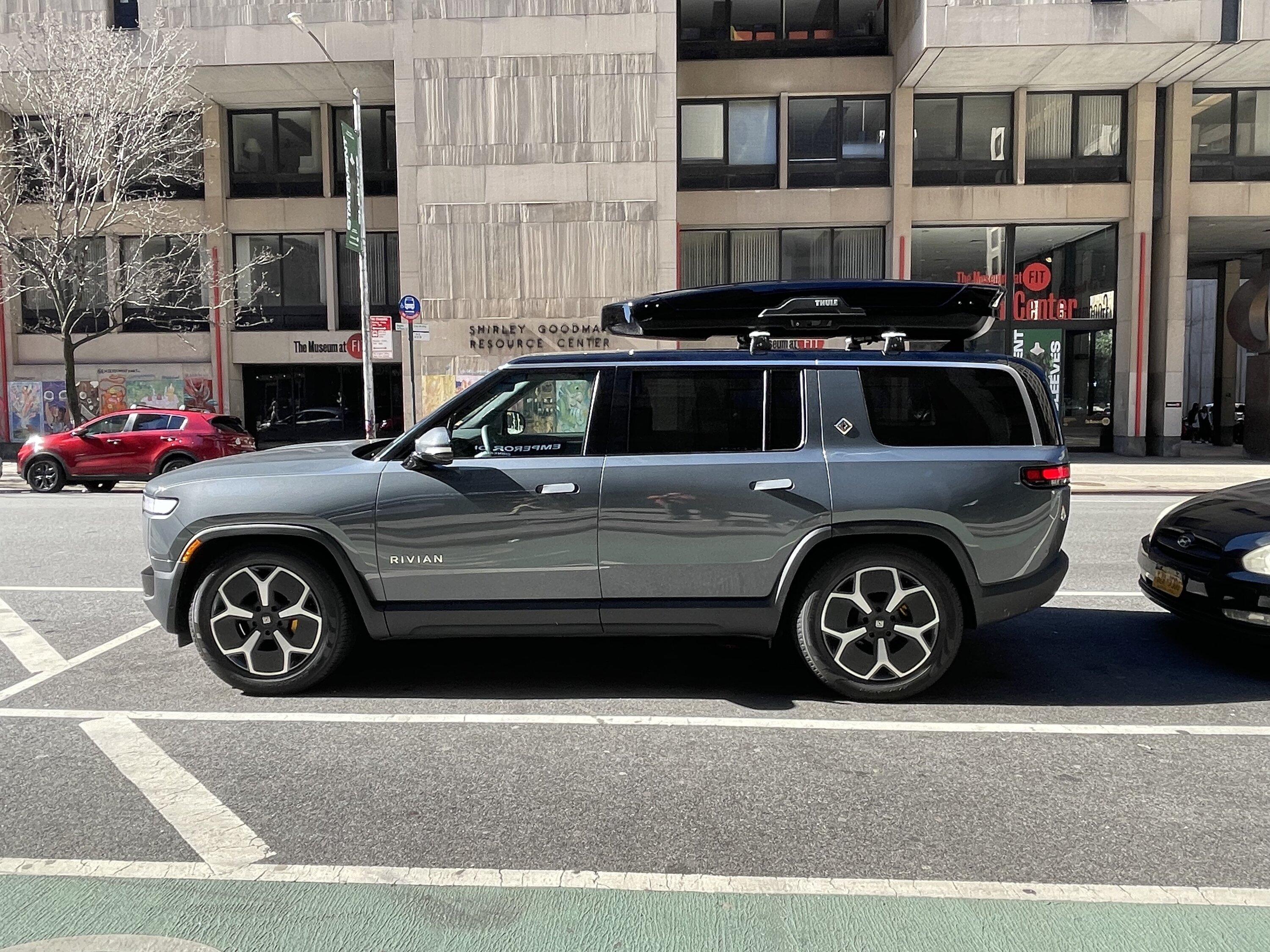

This is my Thule Motion XT Alpine Box which I mounted on the rear two bars. It is mounted as far forward as possible. The tailgate does slightly bump into the back of the box when it opens. To prevent any scratches on the top part of the door, I placed two small pieces of Teflon tape on the box where it contacts the top of the door. The door stops when it touches the box, and it is almost completely open. This is the tape I used: https://www.amazon.com/gp/product/B0C7VLY5H4/ref=ppx_yo_dt_b_asin_title_o01_s00?ie=UTF8&psc=1
Also, when speaking with Thule's tech support, they informed me that I would need a set of Thule #697-6 adaptors to mount this box because the Rivian crossbars are too wide for the "claws" that came with the box. But in reality, the claws worked perfectly fine with the Rivian crossbars which made installing this box much easier.
