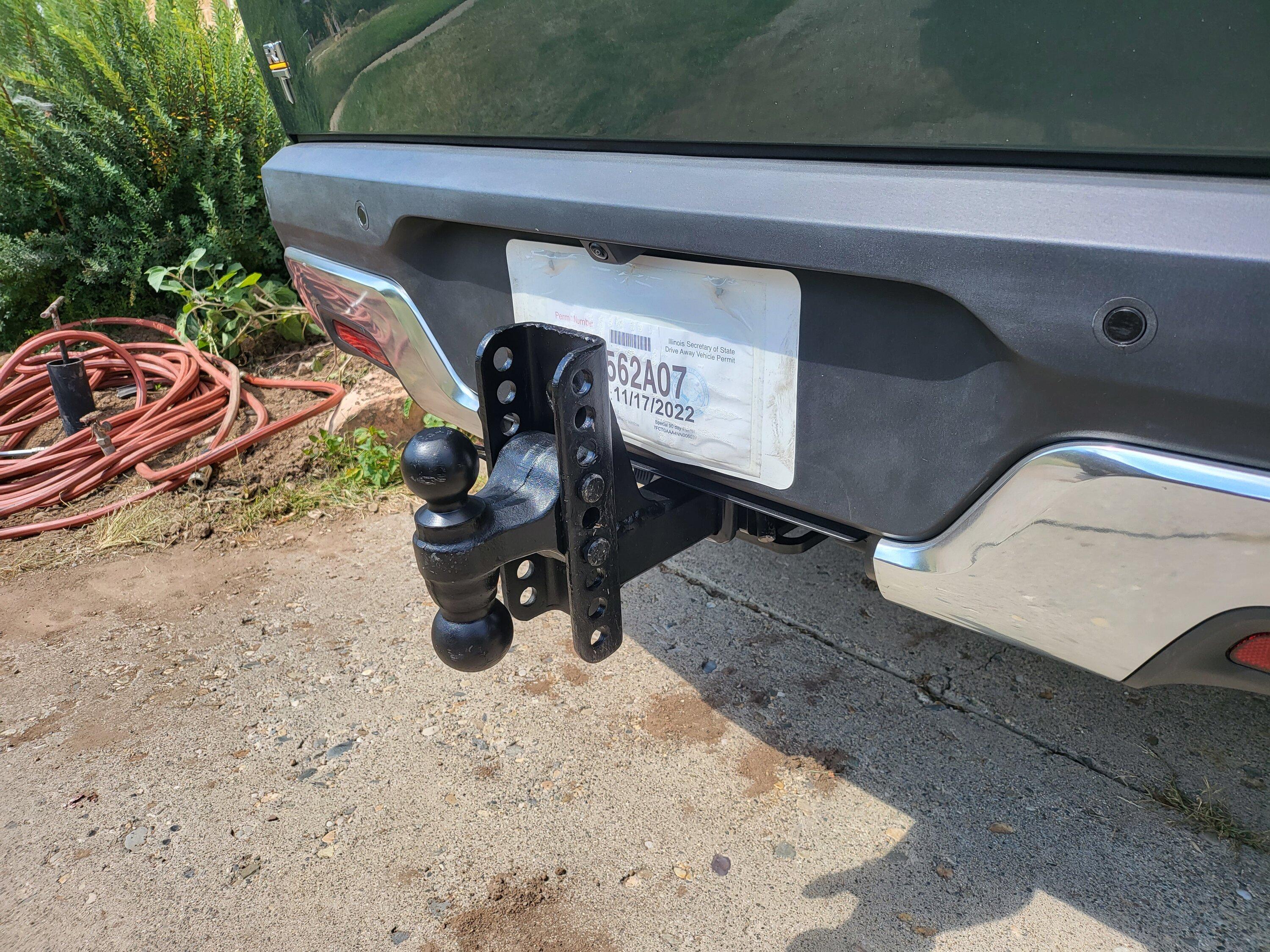

Or you could be like me. I semi-crunched mine on a small barricade that got placed on the street overnight and I wasn't watching closely, nor did a warning go off. Many were placed on my street as it was just repaved. The one in front of my house was the only metal one - all others on the street were rubber style :headbang:. I've put in a ticket to order a new one, but I don't really care. ;) This is how it sits much of the time.
As a positive, I look at it as protection if I'm rear ended. :rock:
