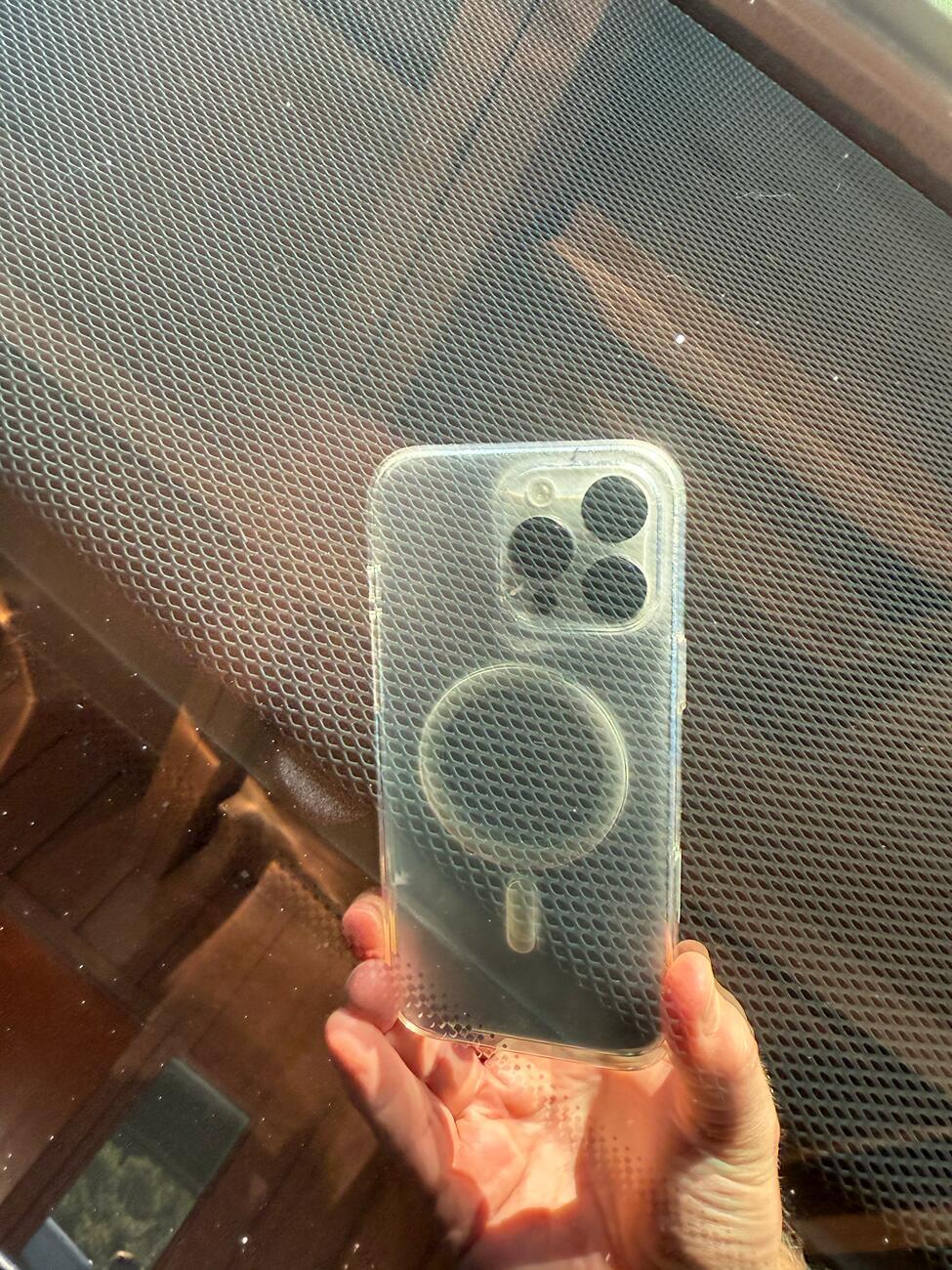

Mine was pretty obnoxious about this rattle when new and I was able to kill about 90% of that rattle by putting small piece of warm brown sticky felt (like you'd put chair leg to protect a hard wood floor) under the speaker grill. It was a bit of a wiggling match to get it down there but it's hidden pretty well and stood up over the past two years. I figure if the thing gets worse, then I'll tackle removing the grill and doing it right.
Here's a picture of the felt piece way down in the center of the dash (it it just to the left of my-phone reflection):
Rivian R1T R1S Help: Insane dashboard rattle on mild washboard roads tempImageqwJvFA

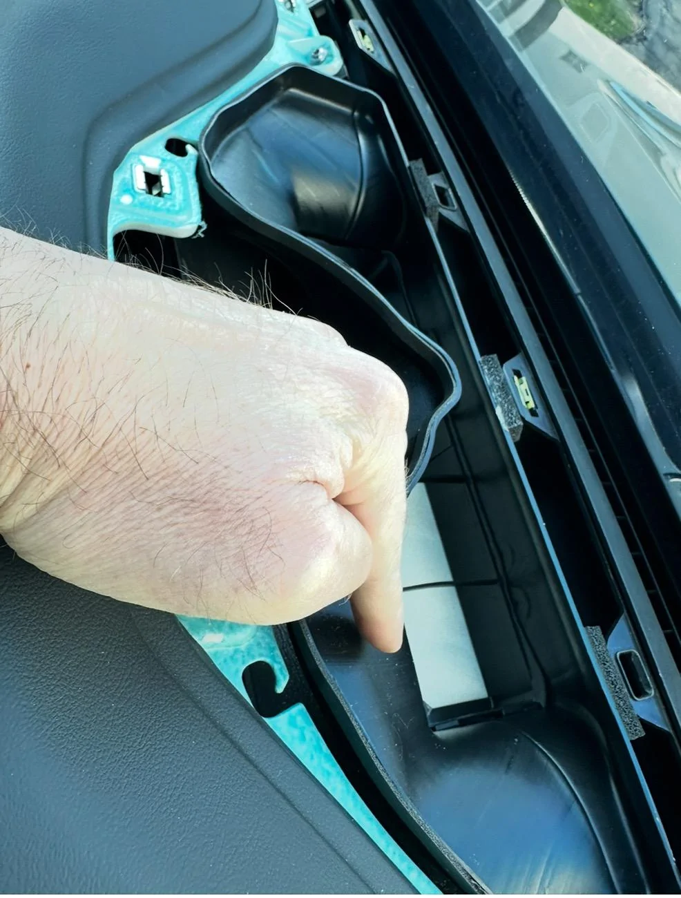

Then I disassembled my gen 1 I found this plastic duct was causing a lot of the noise. They should have made it out of rubber. It was rattling against the screen deck. Unfortunately my hand is blocking it but I do remember seeing a mount point you could utilize. I could definitely 3d print a bracket that utilizes that point and will hold the speaker in place. But I’m going to be honest. Since my current gen 2 doesn’t have any rattles in the dash I’m not going to open it up. I’m currently dealing with a few door rattles and with the redesigned door panels. It’s almost guaranteed you will break the small plastic piece that covers a screw you need to remove. So you have to rely on the service center.
I’m in the Redondo Beach, CA area I have a 3d scanner. If anyone is close by and wants to work on this project together maybe we can work something out.
Rivian R1T R1S Help: Insane dashboard rattle on mild washboard roads IMG_8835
