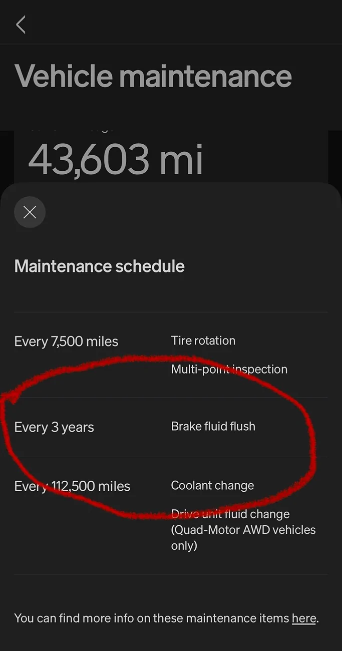

My R1T is about 3.5 years old / 43k miles and I’ve been meaning to get it in for the 3 year recommended brake flush as described in the maintenance schedule.
I considered doing myself or taking it to an independent shop but after reading on this forum the custom tools and complicated procedure that are needed to flush the brake system it sounded like the Rivian Service Center was the best if not only option.
After it’s been there for a few days for some other issues they updated the service ticket to say that the fluid level is fine and the pads are level annd the corrosion level is near zero and as a result no flush is needed.
Has anyone else experienced this, It seems to directly contradict the maintenance schedule so I’m confused how they could have made this determination.
Complicating matters I live fairly far from a service center / appointments are hard to get so if it doesn’t need a flush now, will it in 6 months or a year?
i’m curious if anyone else has had a similar experience or if there’s anything they know of that would allow Rivian to make the determination that a brake flush is not needed even well after the three year service interval

Sounds like they just didn't want to do it. The only reason they recommend you do a flush is because brake fluid absorbs moisture from the air or you cooked your brakes and burned the fluid. You can't really tell how much water brake fluid has absorbed by looking at it so sounds like they just don't want to service it. Tell them you are paying for it so they need to do it.
As for do you really need to flush it at 3 years, maybe many people go an entire vehicle lifetime without ever doing it, you just need to be aware of what it means to not do it. Could end up with fluid boiling in extreme braking events or the caliper pistons rust internally and bind, neither scenario is good as it results in poor braking performance in extreme situations but you may never notice the impact of this in normal driving for many years.

The flush is more of a precautionary measure than a must do so your call on if you want it done or not. If it's a lease skip it, if you plan to keep it long term than you probably should do it at some point.

I just went ahead and did it, and I plan to do it again in another 3 years, whether the fluid is technically still within spec or not. I don't want to have to bother to continually remember to check the fluid - I will just follow the recommended schedule and have it done when I have my tires rotated, so no extra trip to the service center is needed.

Unless tracking your vehicle or live in an extreme climate, 99% of people will be fine for a good 8+ years never flushing brake fluid. If you want peace of mind the listed item above is a great easy way to do it and save unneeded expense as well as waste perfectly good brake fluid.

I took mine in for a flush today and they said it wasn't needed until about 50k miles. Mine only has 16k miles but is going to be 3 years old in April.

When my first R1T hit 3 years old I scheduled it, but the service center told me it wasn't necessary at that time. Truck only had 18k miles though.
