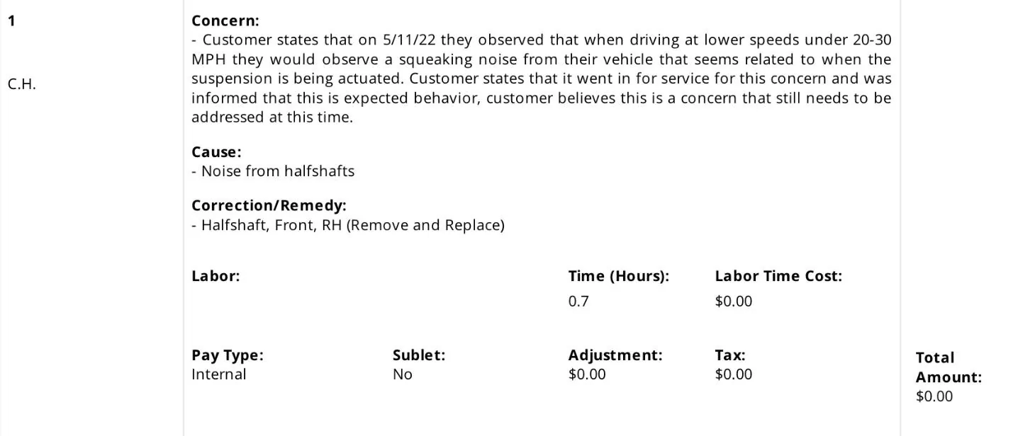

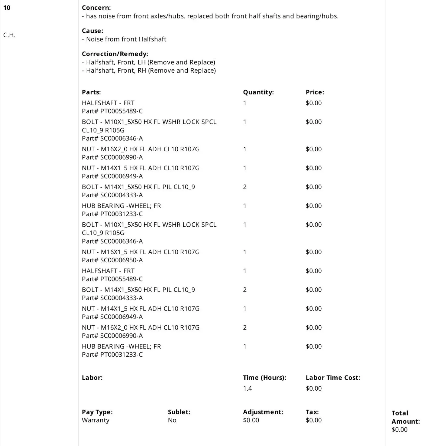

I've been away from driveshaft discussions for 2+ years, so please excuse if this post rehashes old info. Below is an invoice from an August 2022 post (in a different thread). Note that the service part number for a quad front driveshaft was PT00055489-C. Maybe ... just maybe ... the supplier (GKN, I suspect) has implemented design or manufacturing improvements between the -C version and the current -G version.
The OP's video from that 2022 thread is gone, but I recall the video clearly showed "Made in Mexico" on the part number label.
Finally, here's a link to a 1-page PDF promoting GKN's ballspline driveshaft. Although @RivianRush's invoice (earlier in this thread) says "excessive play in the CV joints" I suspect the ballsplines may be the culprit. When the auto industry moved from RWD to FWD (decades ago), suppliers (including GKN) learned how to build quiet, reliable CV joints. Disclaimer: I left the auto industry 30 years ago, so my opinions are armchair-engineer at best.
