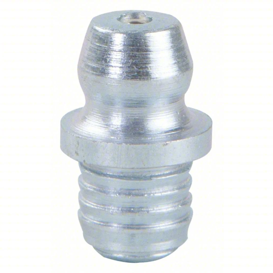

this is all they need to grease the half shaft. Normal vehicles have this 5 cent part. I guess they figured is a $ maker once out of warranty. 😡

Gonna need a retro redesign for these half-shafts. That ball bearing design is pretty cool -- but the lack of a grease fitting is what's leading to all the problems. Not sure if half-shafts typically have that -- but we need it.

The half-shafts need the ability to inject grease into them. Ideally a new design entirely.
