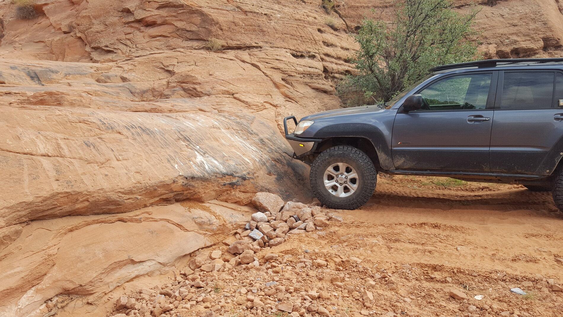

Remote trips could still be a concern, but will just take a different type of planning. I would like to know what kind of range the motortrend guys got on dirt roads. I did a trip last weekend that was pretty remote, from western Colorado to the hole in the rock trail by hall's crossing on lake Powell. Even that trip would have been doable in a rivian with a quick charge stop in Green River and then overnight charging at the halls crossing campground. A full day on the trail used about 1/4 tank of gas so I would be confident that a fully charged battery would have no problem for a full day of low speed trail driving. Fyi, I would not recommend taking your shiny new rivian on that trail unless you really want to test the off-road package skid plates!

I'll definitely have to check out that trail, not too far from Phoenix. I would even think that the range of an EV would be better than that of an ICE when it comes to back country, slow moving terrain since an EV really only uses power when moving, where as an ICE would constantly be idling. That's one of the things I'm interested in finding out, either first hand or from someone here on the forums. The first trails I'm thinking of tackling with my R1S will be the back side to Crown King here in AZ since it's not that technical or long

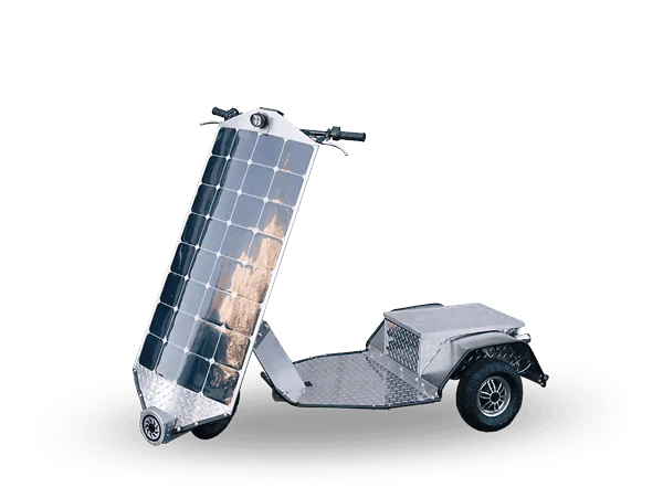

For camping trips far from any plugs, get a converted vw van from solarrolla.com:D

The Solar Electric Scooters is great! ?
and if you direct the headlamp towards the PV cells you have a perpetual motion machine. I'm not into diamond plate is this available in whicker?

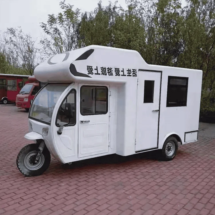

You would get a kick out of the the weird alibaba ev of the week.
Yeah, I get the the notifications for those every once in a while. This is one of my favorites.
