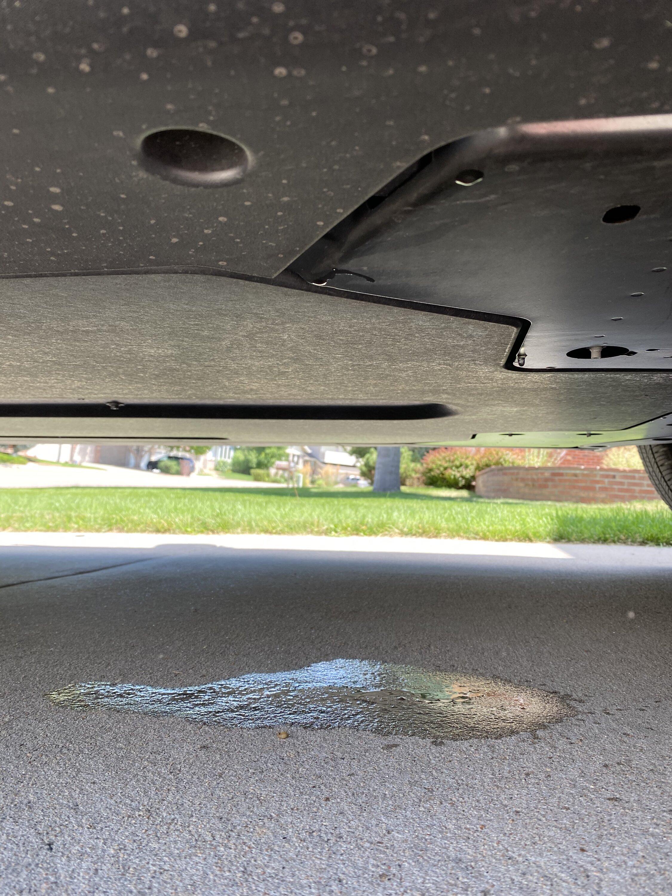

Has anybody ever experienced this in other cars to this degree? I haven’t, including in other electric cars.
Yeah for sure, even in ICE cars when it's humid enough this is pretty common in my Audi.

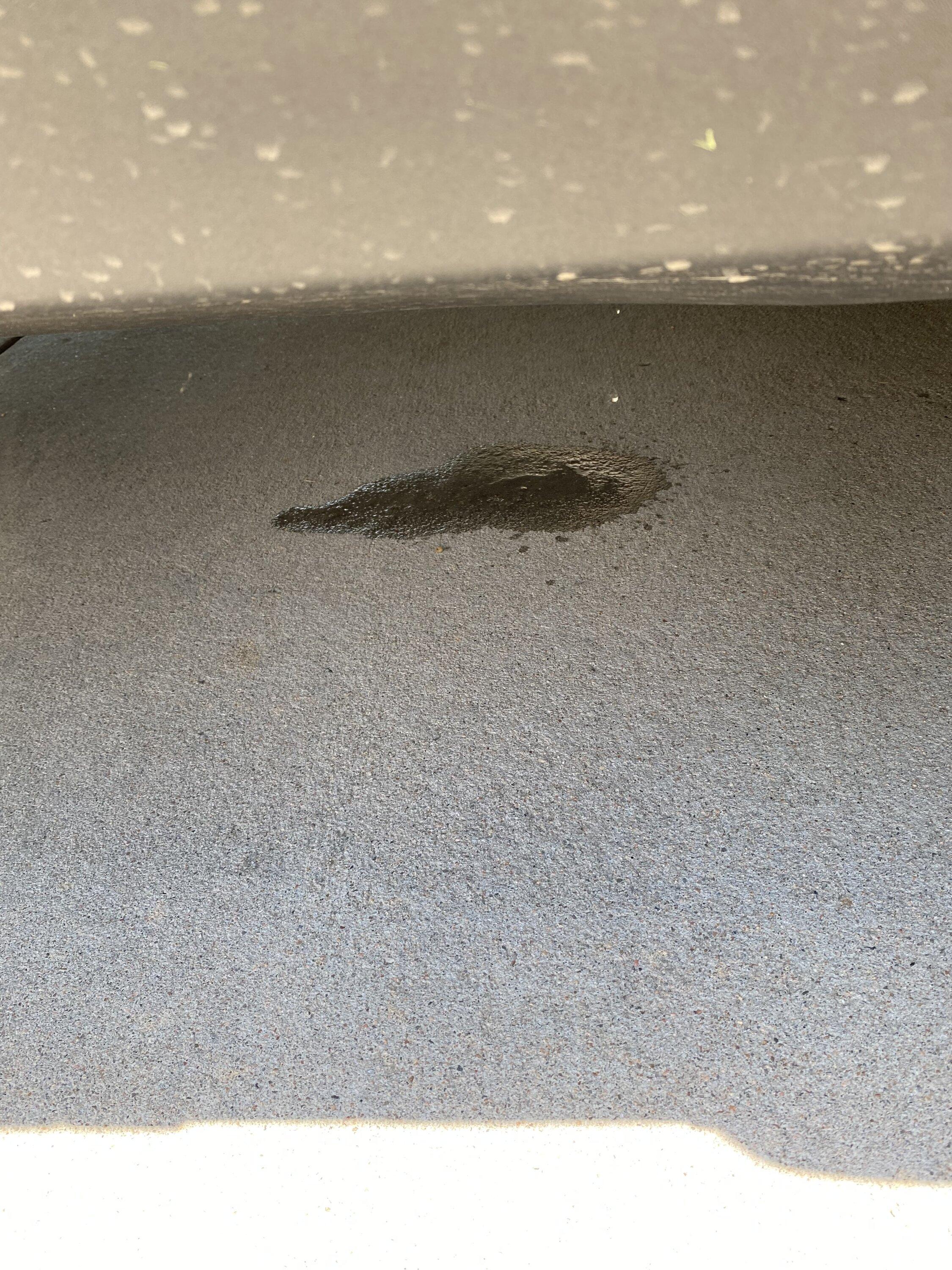

You need to put some paper towel underneath and see what color it is.
I had similar and thought it was condensation but discovered that it wasn’t after doing paper test. If it’s yellow, blue/green, or red hue, you got a problem.
Mine was light blue/green and ended up being hydraulic dampener fluid leak despite having no warning lights.
I was reading your post and thinking "hydraulic fluid" so yeah - that is not a good thing. Definitely need to investigate what color.

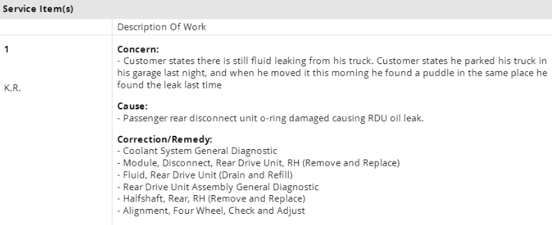

Just an FYI, if the fluid is yellow in color it is not just condensation from the HVAC system. I had this exact same issue and it initially was thought to be damaged plug on the rear drive unit. That is lubricant that is leaking out. The first time it was at the service center they replaced the plug, and low and behold it happened again within hours of driving the truck home. The 2nd time it was picked up, more was done. The image below are the notes from my work order. I have had the truck back for a few days now and everything seems to be ok. All of the Rivian Service techs I talked to were very quick to get this resolved since it absolutely should not be leaking like that.

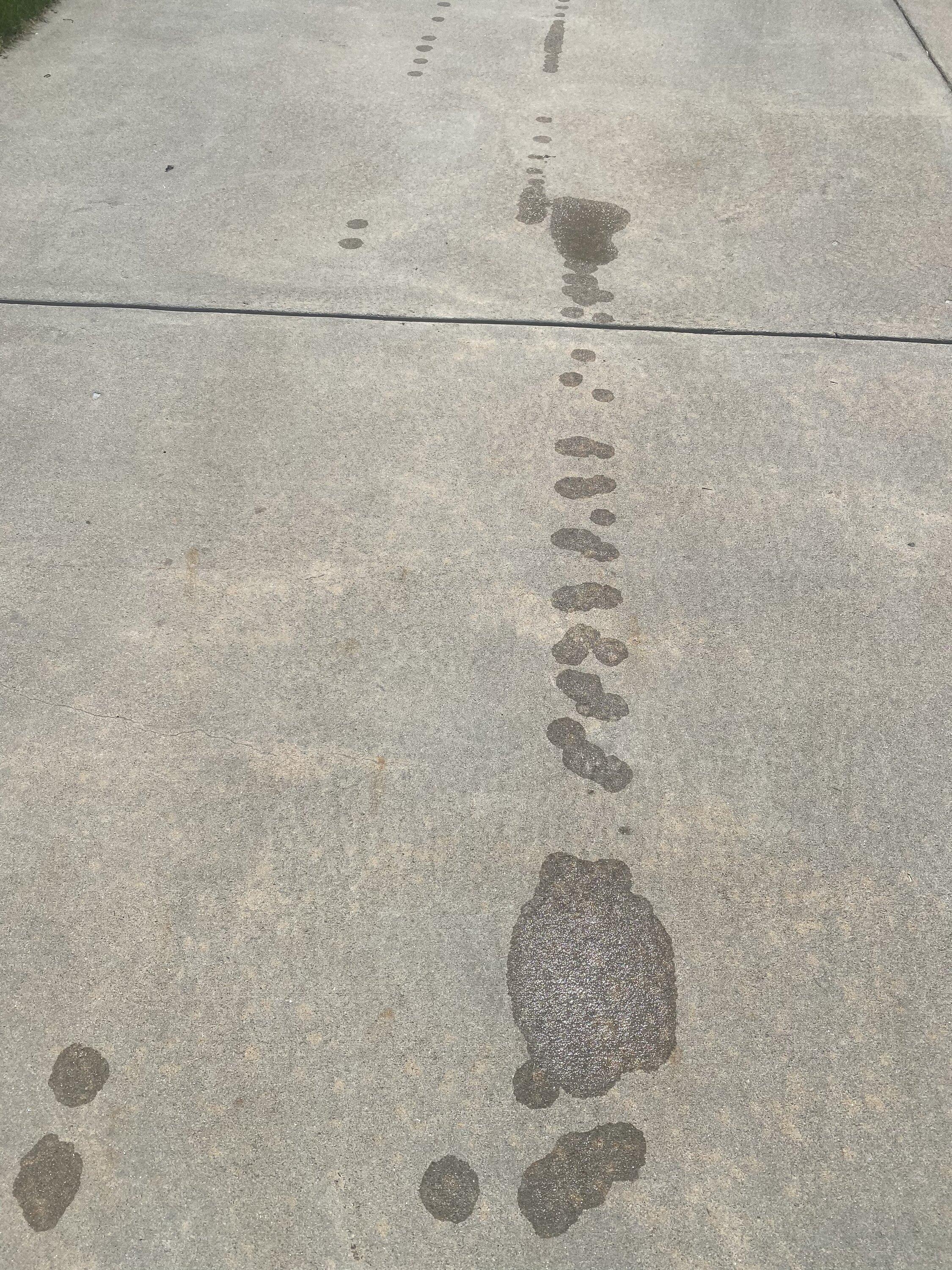

Does your R1T have an excessive amount of fluid dripping from underneath the truck? Whenever I pull out of my garage it leaves a stream of fluid down my driveway. I am assuming it is water as it has been doing it since I got the car three weeks ago. However, it is dropping several ounces at a time. After I park the truck it continues to leak for several hours. I was originally thinking it was condensation from the cooling system, but it is extremely excessive. I opened a service request and have been ignored. The leak is coming from the crack between two panels underneath the truck near the front passenger door.
I ran into the same thing today. I’ve seen some small puddles after running the AC before — felt pretty normal. Today was the first time I did some towing and there was quite a bit more fluid/condensation. It was dripping from between panels just like the first photo — seemed to me to be a leak. I was a little alarmed with how much fluid but it was totally clear and I’m pretty sure it was just a lot of condensation from the cooling system. Glad to know I’m not alone.

If the liquid evaporates in the sun it is simply condensate and is normal. Oil based liquids will not evaporate and will stay until purposely removed.

Our R1T does the same thing from the same spot under the truck. I got drenched when trying to install running boards. Ours is water from condensation at the cooling unit. We get a lot of this kind of thing here in the Florida Panhandle where a dry day is 88% humidity. A cold can of beer will be sitting in a puddle in about 30 seconds.
