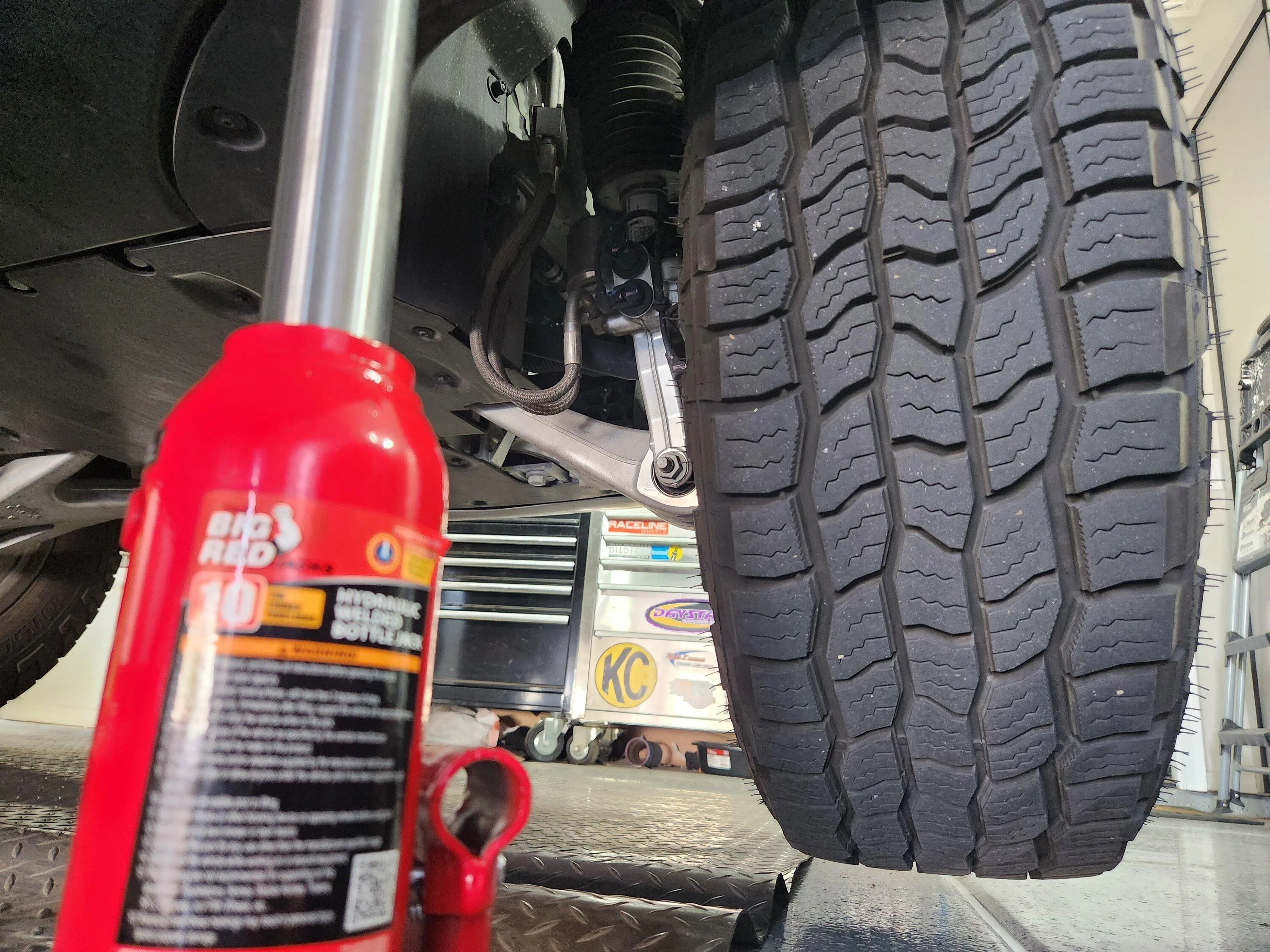

My last tire rotation I used four (4) 10T Big Red bottle jacks and our pucks, and it worked perfectly. If you are on a flat surface (like my garage floor), then the associated risk is you have your vehicle in the air supported soley with the Bottle Jacks.
Because of liability, I'm not recommending people use four (4) Bottle Jacks, but it works perfectly fine, as long as when you are putting the wheel/tire combo back on the vehicle you take your time to place the wheel back on without thrusting it on there and creating instability.
Picture below is using our pucks with four bottle jacks to rotate the tires. YMMV

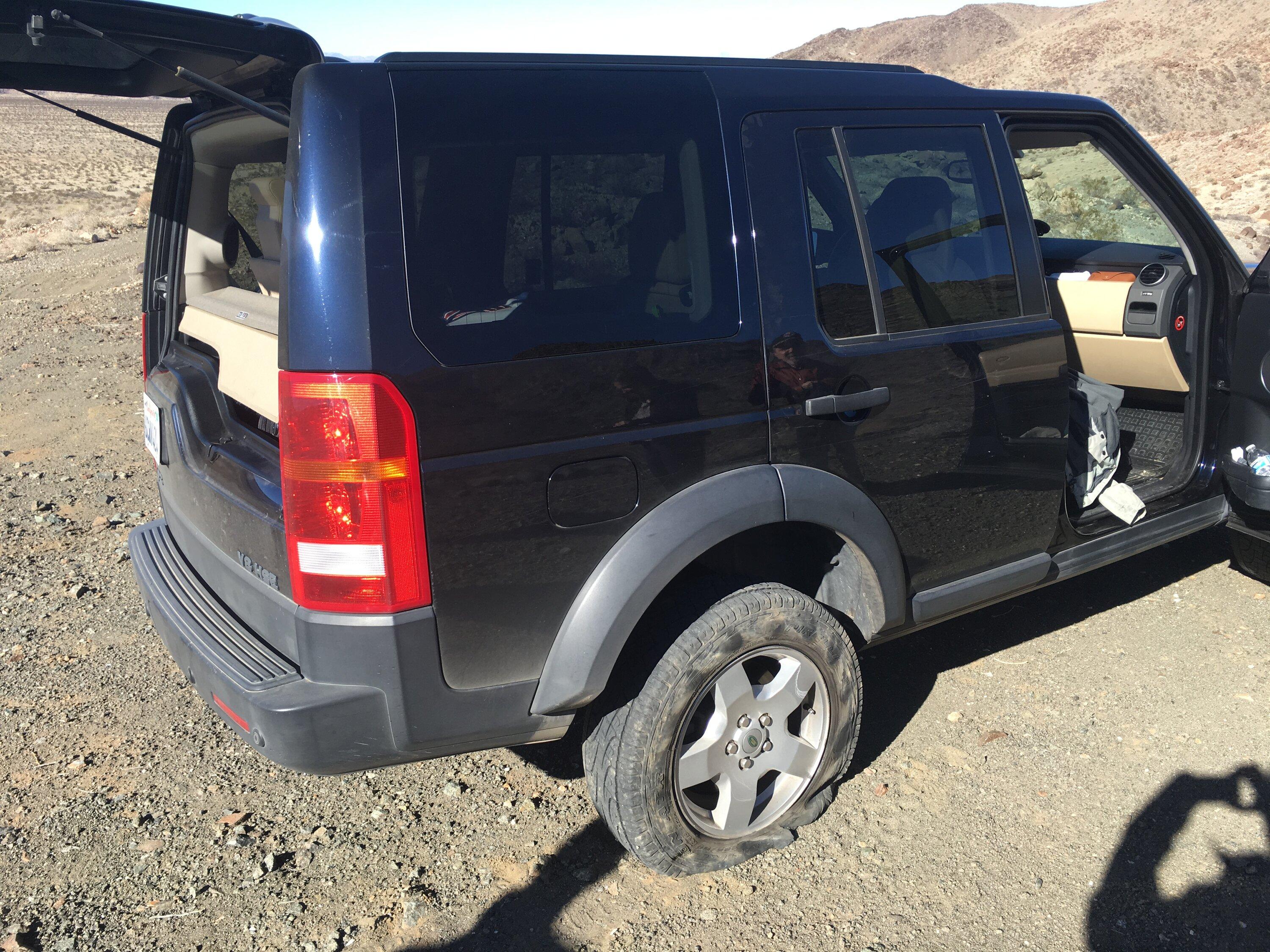

I appreciate the good luck you’ve had, because I haven‘t seen any of it. I’ve only managed to make it through a set of tires without a puncture on one vehicle. That one vehicle was a Corvette on run-flat tires where it wouldn’t have been as big an inconvenience.
Mostly unrelated, I’m one of those people who do actually go off-road in vehicles with the capability. I just would never go off-road without a full-size spare, which I’ve gotten to use on more than one occasion.
